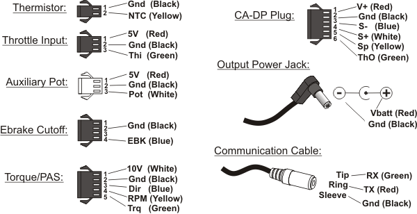

Topic: 48v battery gauge on 44,4v battery (done)
Replies: 8
Re: 48v battery gauge on 44,4v battery
why don't you just get a simple 0-100v digital led display voltmeter and plug it into the CA DP plug pins 1 and 2 :
Pin 1 is +ve and pin 2 is gnd.
