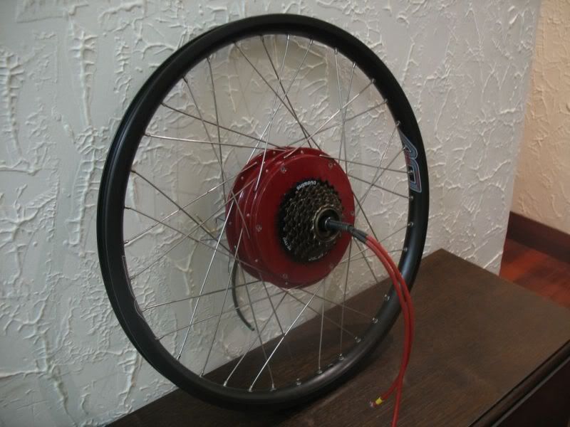

Re: Giant NRS/Mac hub/48v Headway build.
Hub and rear rim are now laced with a one cross spoke pattern.
Cheers,
Matt.P.
Cheers,
Matt.P.
I did a little bit of a paint job on the Mac hub to match the red front hub.
Then I laced the hub and the rear rim last night.
There is a bit of an angle between the spokes and the nipples, hopefully all is well.
Cheers,
Matt.P.
Cheers,
Matt.P.

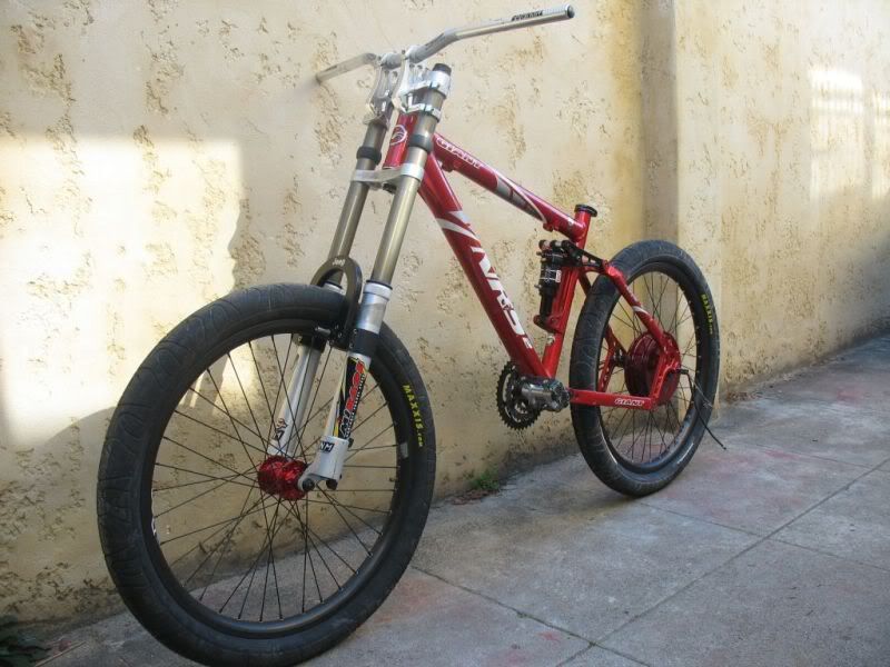

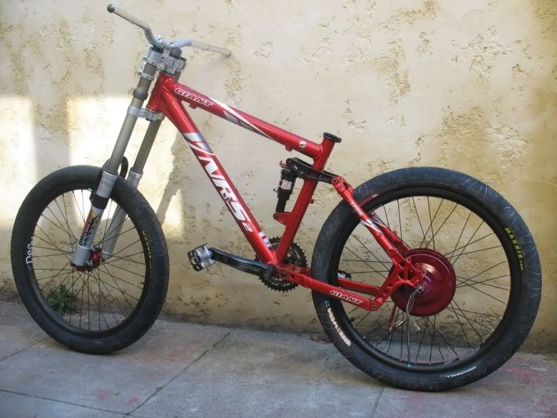

Chill.
The cruiser is still mobile, that's a brand new wheel and tyre the same as the one on the cruiser.
Cheers,
Matt.
Cheers,
Matt.
