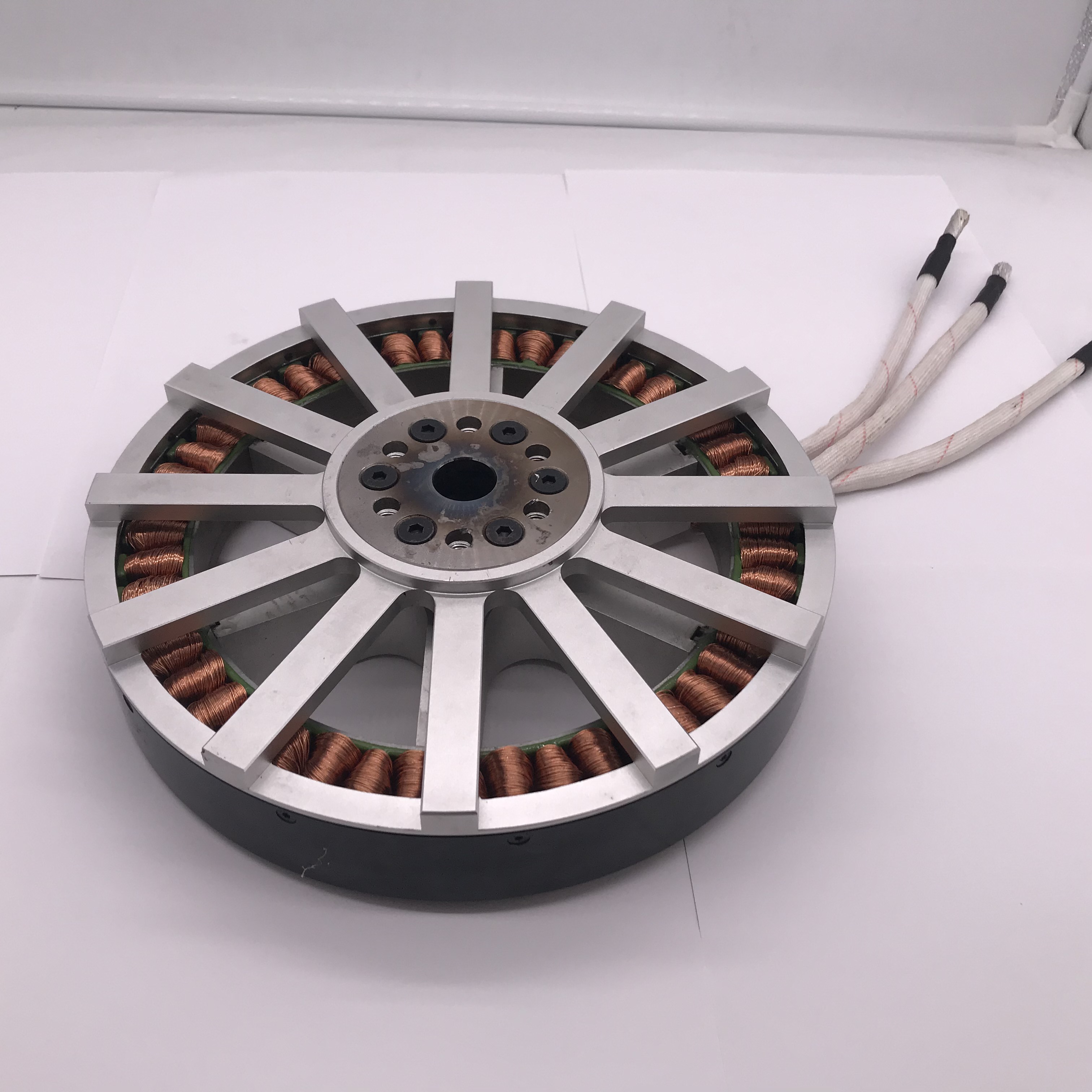

I posted some of the motor choices in another thread. https://endless-sphere.com/forums/viewtopic.php?f=28&t=68950
The 20KW would make a good flying motor IMO. Listed at 5KG It looks to be able to run on reasonable low voltage.
With a freewheeling crank, you could mount a prop drive sprocket direct to the face of the motor and space off from the Human Powered (HP) sprocket far enough that both separate chaine lines will not rub. Lots of discussion - pitfalls on freewheeling cranks on the early GNG 450 watt kit threads. That way, you would pedal and rotate the works (motor and props) and when the motor takes over, the pedals can stop rotating. Both chain lines would run full time with the motor and at what ever rpm you need.
