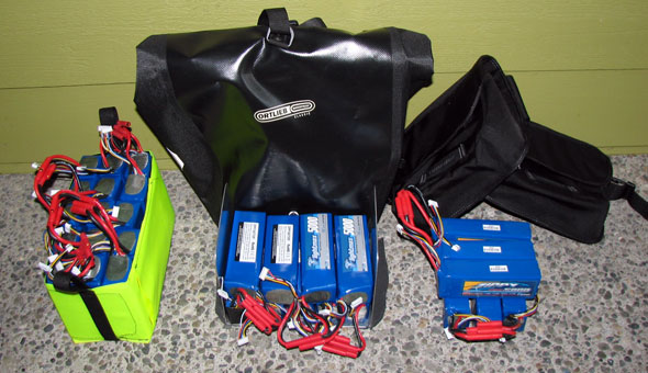

Battery Packaging
This arragement makes it soooo easy...
  • On the left, I created two basic battery “wrappers” (one shown) that essentially hold the entire local battery array together and with handles for easy insert/withdrawal. The florescent Cordura is self-illuminating under any light conditions. There are 15 batteries in this unit which resides on one side of the trailer (in a toolbox).
  • The Ortlieb bags use last year’s arraignment wherein I have 50% of last year’s load (9 batteries shown) on each side, and contained by a U-shaped Aluminum brace. This retains the form when the assembly is inserted into the Ortlieb bag. There are two additional padded panels front and back (not shown) that protect both ends from debris.
  • Lastly on the right are the forward-mounted saddle bags made from two Timbuk2 bags that I stitched together using 4” wide polypropylene webbing. Each Timbuk2 bag holds six batteries.
  • MIA: Not shown are the 18 batteries that I have already loaded in the triangle area of the ebike.
Add it all up and you get 78 batteries: 18 + 12 fore, 18 aft, and 30 astern on the trailer.
Did I say that I liked how the trailer handled now that it is stiffened with cheap-arse foam? :D
I have to get this pesky controller/throttle snafu fixed and git my hiney-butt down the road. :oops:

  • Replacement 12-FET is ready to test; completely modified and ready for bear. It has been flashed for 24A Battery/60A Phase which I discovered is what my old 6FET was set to last year when I made the 101 Club and succeeding Road Trip. (The Front Hub controller is set to 18A/45A; the only caveat I have about that is if the rear controller fails - the front hub is too weak to carry the weight up the steep hill alone unless I get off).
  • Battery Harness progressing; I’ve reworked existing efforts to create the forward harness which will service Saddle Bags and Triangle batteries. The Trailer Batt-Box harnesses have been split so as to reuse ½ of the pigtails for the Ortlieb bags. I just need to add extensions to the length and they will be finished.
  • Magura Throttle mounted, though it needs the cable shortened (it’s like 8 feet long!). It would be nice to have a switch to cut out the Secondary controller for cruising/economy – but there’s no time left to experiment.
Tomorrow (now today) I’ll put this all back together, hook up all the batteries, charge, and make another test drive with everything loaded sans the faring; it must pass the abusive local hill climb at least twice without ANY issues. In fact I really want to run it about four times; climb 2000 feet in 24 miles; about an hour stress test. <whew>
Well – that’s all I have for tonight; pooped out.
Until tomorrow then, KF

Midnight Status:
I bark at the moon... <ARrrooooo!>
I was thinking I might leave today but then by 10 AM it became wishful thinking; too many little details to complete. Here’s what’s been done since 6:30 AM…
  1. Finish Trailer cable mod; termination
  2. Finish Ortlieb cable mod; extension & wye
  3. Sort out Controller-side power bus connector
  4. Shorten Throttle Cable
  5. Shorten Rear Hub cable if possible
  6. Tried configuring Speedict one more time: Got it to recognize the device on XP but wouldn't take latest firmware upgrade (might already be installed). Android couldn't connect to device. Tried both apps; no joy. Taking the unit with to resolve on the road. Maybe with a 2nd set of eyes this too shall be overcome.
It doesn’t sound like much, and that was my thinking when I got up out of bed. But these little jobs are tedious. For instance, signal wires solder quickly – actually they go pretty dang fast now as I’ve developed better technique. Battery cabling though takes time because I tie off each connection with a lineman-hitch (I forget the proper name but it was something I learned when I was in the Navy): Take two big wires, overlap them, then take a single piece of strand (I use silver-plated copper because it’s ready to wick), and then I tie the two wires together. Finish by soldering. Works well for holding large joins together. Not long ago my Uncle said “Screw that – I use Butt Splices”. That made me laugh; I am such a fool. :lol:
Once I relinquished spending another afternoon in Redmond I added more nice-to-haves tasks. The eBike bus was originally redesigned around the Speedict device; there are two sides: Battery and Charger, and the Controllers and DC-DC converter on the other with Speedict in the middle. It’s the other side that was funky and ghetto, cobbled together from past efforts. This I remanufactured and it made the whole assembly fit better. I also had to take into account how to create extensions to that bus for the Road Trip which could be reverted or removed after said adventure.
The replacement Magura Throttle had an 8-foot long cord which I reduced to a reasonable length; too many wires means clutter means probability something will catch, tear, fail.
The same was done to the rear hub as the original wire length was designed for the trailer and not the bike. With these last three items the rats nest developing post-trailer mods was greatly reduced.
Replacement Controller
Oh I wanted to share some pictures of this other controller. It’s essentially the same layout as the Lyen 12x4110 except it has older-style power regulation. I think I bought this April last year and began to modify it – boosting the traces with this mombo 10-AWG solid copper wire. I shouldn’t laugh cos the 6FET controller that I’ve been using all along up till most recently had the exact same modification – and THAT controller took me to Californy. So I hope the magic rubs off. I never got around to trace-beefing the Lyen boards cos I didn’t think they needed it for what I am trying to do, I mean come on: two 12x4110 controllers pulling two hub motors = plenty of horsepower.
  • Battery and phase wires are Mil-Spec silver-plated 10-AWG.
  • Halls connector is the USB-2 Micro-B Female.
  • CA connector
  • Programming Connector
  • Slave Cable: 6-pin Molex carries signals, Blue APP = VCC-L from the key switch, and spare green wire is for future use, likely +12V from the DC-DC converter when I get around to it – but not today…
  • Two big Caps are the lowest ESR rated I could find.
  • It’s been flashed to provide 24A Battery and 60 Phase and drives the rear hub.
In the afternoon I began putting the bike back together. The saddle bag wiring was problematic and took a while to sort out. The bike faring and saddle bags are now good to go, although I might add another safety belt just in case. All batteries are unified onto the same bus, both controllers check out, both wheels turn: We are ready for another test drive. This time however I am going to load up the trailer as if I am going to leave – mainly cos I really want to.
The things that are left are sundry items. Will tomorrow never come?
Waiting for the Sun… KF

Monday July 25, 2011
I got up this morning thinking I am ready to leave. Started down the ticker of things that needed doing which included repacking to drop weight. About the time I was thinking that I’m ready for a test drive – it started chucking down rain; great. :( Decided to mount the faring on the trailer to keep it dry for the test. That took 2.5 hours. After going at it since 6:30 AM my back was starting to fatigue and at Noon I had to lay off and take a nap from all the bending over. That’s the day shot. Got up and worked through nice-to-haves and Fit & Finish.
  • Remount Mirror on Right side of Magura Throttle; lubed throttle/handlebar interface w/ silicone spray
  • Ortlieb Strap to keep them from drifting backwards; modified bags and am using rope x2
  • Safety strap for saddle bags; also stitched rubber to bottom of webbing to inhibit slip
  • Blue stuff on the axles; check - all good.
  • Mount trailer faring
  • Reflash Primary; both now 24/60. Decided if either motor/controller goes TU I will still have a spare capable of climbing most hills.
  • Repack
There wasn’t much left to do after that – except mount trailer blinkies, but that can wait. Decided to spend quality time with my new cell phone and figure out all that I can do with it. One item that I am going to do is leave my trusty camera behind since the phone has up to 8 mpix capacity; that’s two pounds of camera that will be off the bike. :)
I still haven’t figured out how to get the music player to just play the whole fricken album though. I think I’ll just set it on A and have it play through to Zed and be done with it.
I think that’s about it for me; I’m beat. It rained much of the day. Calling it an early one.
Z z z… KF
