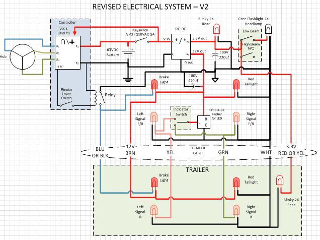

Today I focused exclusively on the integration of the DC-DC converter with the new cable harness and the new lighting system, with the keylock switch. This was really tedious work and taking far longer than I had anticipated. The short story is that my smoke test tonight produced no-smoke! Ebrake works as do the Blinkies. :D
For clarity, allow me to point to another thread to give you a flavor of the concept: Advancing the state of Ebike Electrical Wiring
I have modified the schematic yet a bit more from this thread.
Mainly the big difference is that I decided to keep the isolated grounds for the +3.3V and +12V systems, although they share the same ground, and I added the trailer information. This site was useful in helping me select the common wire colors for the trailer cable.
I also drew out a wiring diagram for Da Black Box, then printed both of these out to have at my feet so I wouldn’t waste time going back and forth to the computer.
Then I built it.
This will really clean up that rats-nest of wiring behind the faring. Da Black Box integrates the keylock switch, DC-DC converter, Flasher, Brake relay, and line capacitance. (Note: I haven't finished it just yet).

Finished getting all the electricals wired up with exception to the trailer cabling from the ebike. Signals work, and the little flasher unit is loud enough that I can hear it through the helmet; clean and crisp. Headlights work; there is no hi-beam ~ perhaps in the future I could use that to fire the plasma canon or enage Cop-Away (patent-pending) :twisted: . When I turn the keyswitch the Blinkies and Taillight are lit which is how I want it.
The downside is that my brake light does not work; the LED will illuminate with voltage, thus the light is functioning, however the relay circuit is not. That relay is a delicate device; I have a spare but methinks that the eBrake circuit of the Controller is not pulling enough current to initiate the relay. The brake light is not critical, however I am keen on discovering a viable solution if someone has some ideas how to make a go of it.

  • Got an idea on how to fix the brake light problem, so I took the bike out for a maiden voyage; reset the Shunt value in the CA to 2.400 until I can get it sorted properly. Got to the bottom of my hill and when I hit the throttle the bike shuddered and struggled to come up to speed, growling the whole way. :cry:
