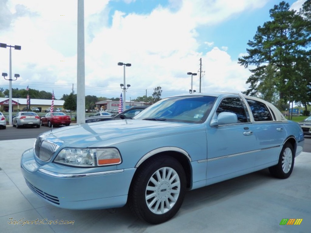

Look at this picture I found on the internet. I apologize if the paint color is wrong.
Please NO spinner wheel covers! Those would make this car embarrassed. "Spray those tailpipes to look like chrome and then leave them sticking out the side like that." Yea!

marty wrote:...Cars have feelings too.... 2005 Lincoln town car paint colors. Is it Light Ice Blue Metallic, paint code LS?
This 1LNHM82W75Y642436 Lincoln Town Car with 280K miles (450K km) is indeed light ice blue metallic, and I do have respect for the design, particularly the rear suspension.
Instead of springs in the rear, these Lincolns have air bags (called air springs), a height sensor, solenoid air valves, and a small compressor. After studying and working-on this system (in another car), I'm convinced it's the best rear suspension available for any car. If you like a comfortable ride, and everything is working, this is the way to go. Metal springs are simply the easiest design. Air bags are superior.
