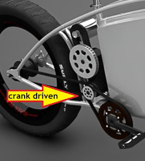

indirect pedal assisted power drive??
Post by Hugh-Jassman » Sat Jun 24, 2017 2:41 pm
what do you think of this kind of drive?

Post by neptronix » Sat Jun 24, 2017 3:28 pm
I forgot about this..
https://www.aden-sports.com/en/powerkit-pro
If i had the coin, i'd be running one.

I thought that might be an Axial Flux Motor, not quite. Do you know what the reduction ratio is?
