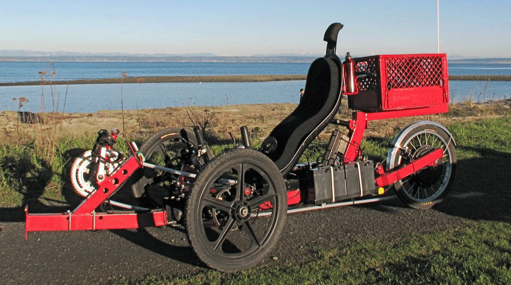

How much elevation gain are you dealing with? When I lived in Seattle and built my own first couple of e-bikes, I used them to commute from my workplace down on the water up to the Admiral-California junction in West Seattle, and later up over the ridge of Capitol Hill when I moved to the Central District. Both those climbs were in the 350 foot range.

Chalo wrote:
Aug 25 2018 9:20pm
Regarding cycle trucks, the new generation of six passenger pedicabs where I work is rolling on out. This design is proven up to gross weights of well over 2000 pounds. It has chain drive from Cyclone motor directly to the rear differential.
(The one in the picture hasn't gotten its seating yet.)
