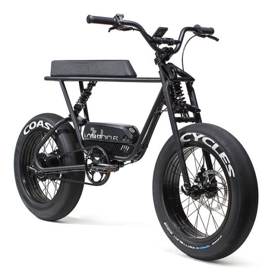

Maybe check with Coast Cycles to see if they'll sell you a frame only? They have two models that seem applicable.
Luna was selling their banana bike as a platform only - no motor about a year ago; have you checked with them to see if they plan to restock?
these electric "monkey bike" type ebikes are now available fully sprung from coast cycles in Singapore ..
https://evnerds.com/electric-vehicles/electric-bike/coast-cycles-buzzraw-x-e-bike-and-full-buzzraw-series/
No luck getting a frame out of anyone to reduce costs.
