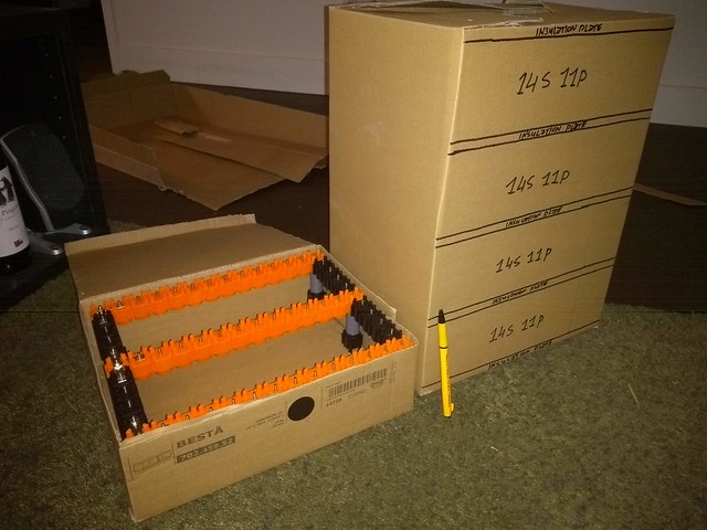

6,2kWh (or thereabouts) made from lithium-ion 18650 cells. I already bought 106 pieces of new LG INR18650-M29 2850mAh - 10A cells to create a "temporary" 96V and 26s4p battery to get the motorcycle working (although I'll be limiting the hubmotor load to 1250w to avoid frying the battery). I'm doing it this way to create a working "showcase" of the motorcycle with which I think I can attract financial donations from fellow colleagues and friends. With these donations I'm upgrading the battery to 26s22p. By then I can use the full power of the hubmotor. Also I'll be using the Vruzend v2.1 modular battery kit to assemble the individuals cells into one battery. These are rated for 20A power draw per cell but according to my calculations I'll be drawing less than 10A per cell at peak load, both in the temp battery as well as in the final battery.
For the minium required kWh, I used the following calculation:
69wh * 64km = 4416wh <----- average consumption of energy per kilometer times kilometers of riding
then 4416 * 1.2 = 5299wh <----- since fully discharging the batteries is a bad idea I kept the minimum charge at 20% charge.
I've added another 1000wh (or 1kWh) to the battery by adding additional cells in parallel, otherwise I'd be stressing the cells too much (more than the 10A which they are rated for at peak load).
Together this is about 6.2 or 6.3kwh which should be enough for the 64 kilometers desired range but I guess I'll find that out once I actually attempt the ride for the first time ^^
As for the layout of the final battery (26s22p) I might go with two blocks of 13s22p and connect these in series as to make it easier to fit them into the frame. Any suggestions on this matter this would be super helpful!
Also haven't decided on the battery box yet. I'm thinking of creating a see-through plexiglass encasing (CNC'ed) because I really like the idea of seeing the "insides" of the systems that run the motorcycle. Also the see-through aspect could be helpful for visually checking for faults and for explaining the system to others.

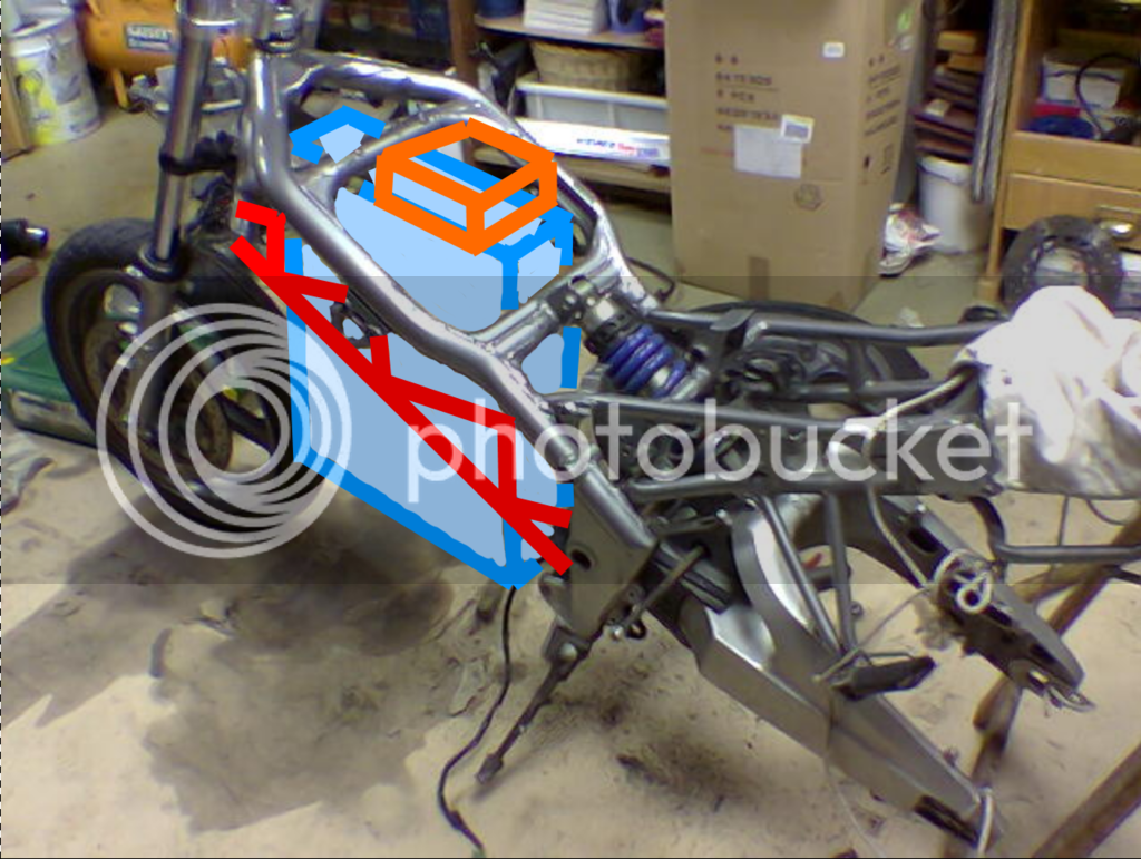

1. Designing the frame beams that'll hold the battery (and which act as a support for the whole frame) and getting these beams installed by a third party.

For the frame (in red), the battery pack (in blue) and the controller (in orange), I was thinking the following. Would this type of added frame support be enough to add enough strength? Probably also a lateral structure will be needed.
Let me know your thoughts.
Thanks :thumb:
:thumb:
Yes that seems a very smart way to replace the lost strength that the removed engine provided. If you build the battery box/frame out of metal tubes or plate and integrate (welded or bolted) that as well into the total frame structure it will probably stiffen it up even further.
Thanks :thumb:
Your frame supports don't need to be that complicated, the long straight Bart from beneath the headstock to the swingarm pivot or bottom point and 2 more bars from both those points to the engine mount mid way up the frame is plenty, making a triangle either side. Then bolt the battery box to and between these and it'll be stiffer than the stock setup. I'd keep them fairly light weight too, perhaps using an oval profile tube to keep it slender.

So here comes a long overdue post. Work has been a bit demanding these last few weeks so the project hasn't received the attention I was hoping to give it. Anyway, here's what's new:
Above: Built a dummy batterybox so I could play around with dimensions and fitting. The plan is to replace the cardboard with a 3D-printed casing made of plastic. The BMS will be added to this setup as well as soon I buy it. So for the battery I'm thinking 96 volt, 62Ah battery consisting of 616 cells (18650). These will be provided through one of the suppliers of the company I work with but have been delayed by the Corona virus. I'm using Vruzend V2.1 modules to connect the cells into a pack.

Smart to use CAD (Cardboard Aided Design) to trial fit the battery box :wink:
