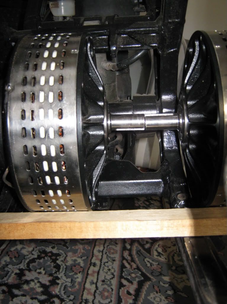

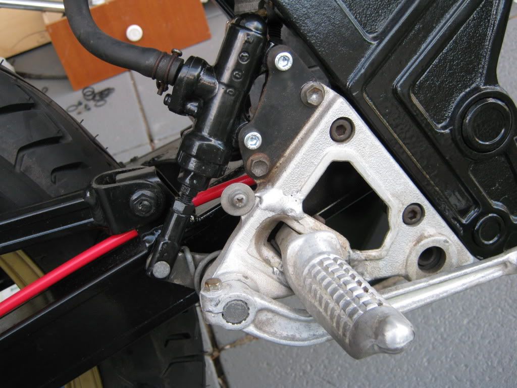

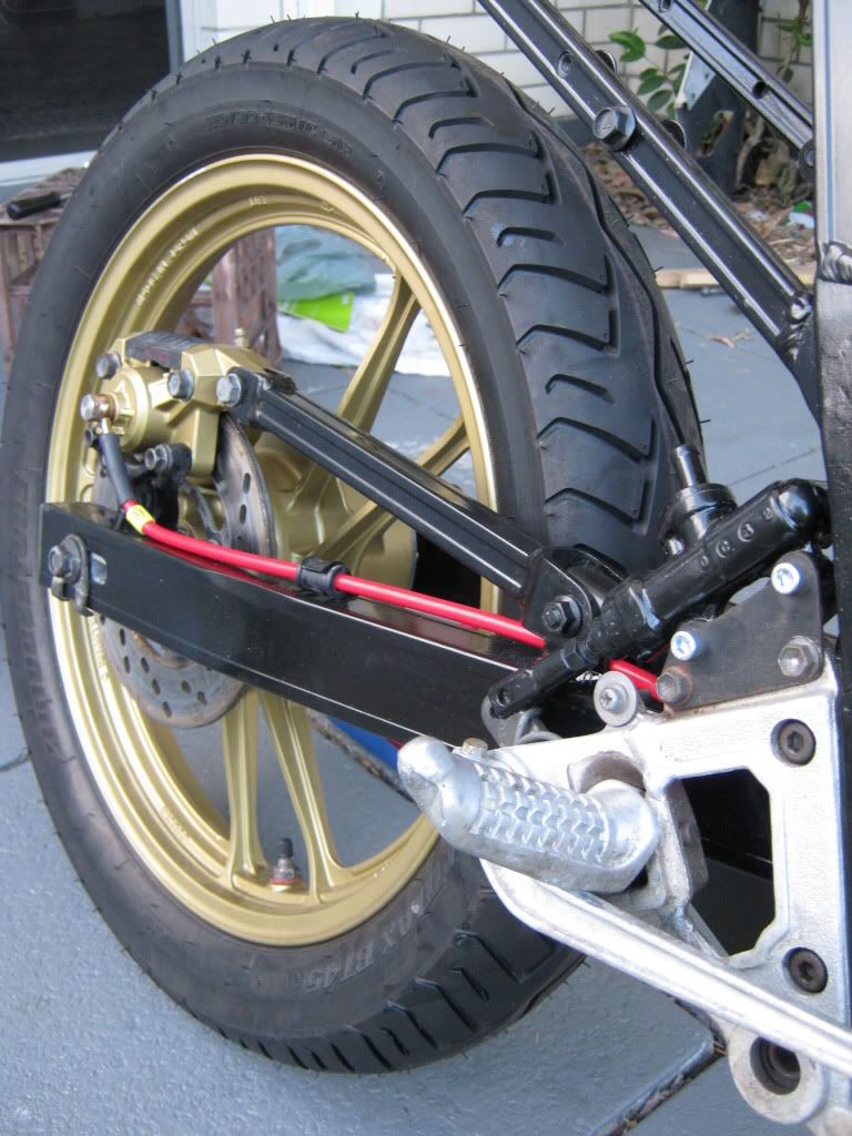

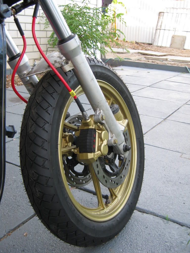

Re: Suzuki RG250F Gamma conversion
She looks like a bike again!
I hope to get the motor mounts made soon, then the fun begins
Working out the motor mounts. I don't have much room for attachment points, but I think I'll be right. Steel will be cheaper, but aluminium will be lighter, and less likely to interfere with the aluminium frame. I'll get a couple of quotes next week.
