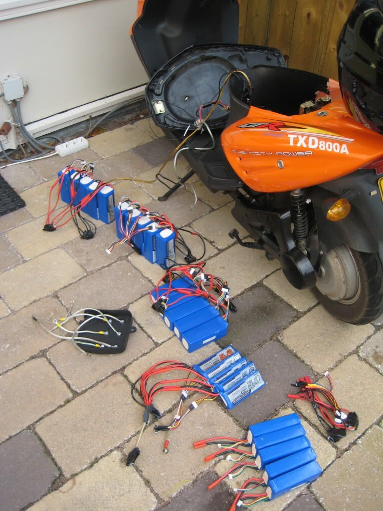

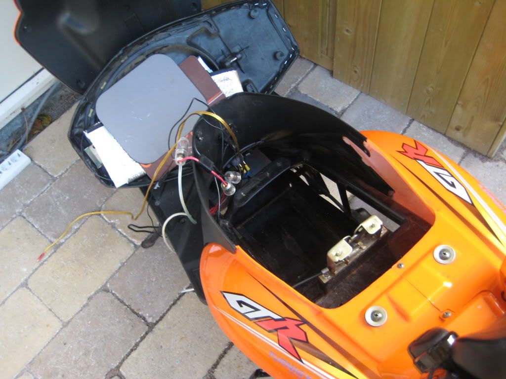

I have a Electric scooter 48V800W which i upgraded to 15S6P lipo pack.
It first came with a lead-acid pack of 48/20Ah which i replaced for a lifepo4 48/20Ah pack with BMS
Now i am experimenting to go to 16S6P toget higher speeds.
any help or succesfull modifications are welcome on a brushless controller.
Yesterday i purchased a 72/1500W contoller on ebay. I think i will experiment on that.
are there some limits for the brushless motor ? it is a 48V/1000 W motor
3 days and my controller will arrive.

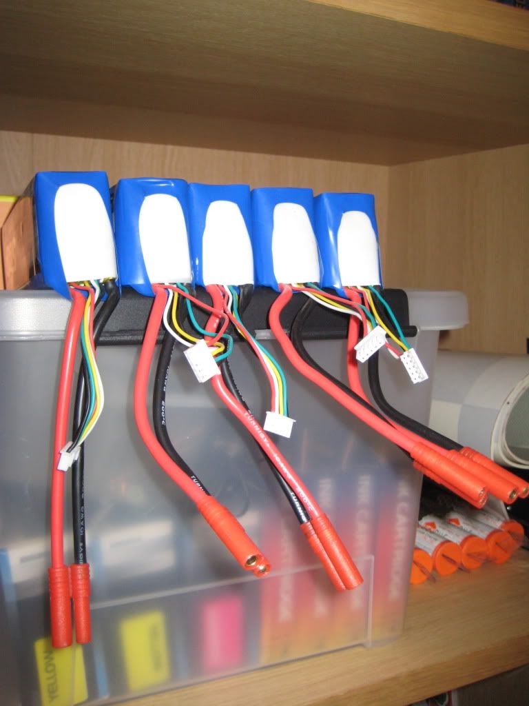

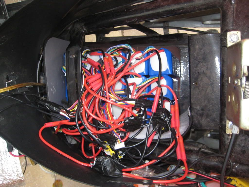

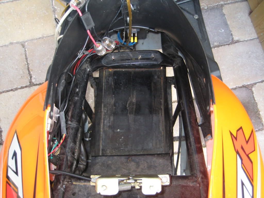

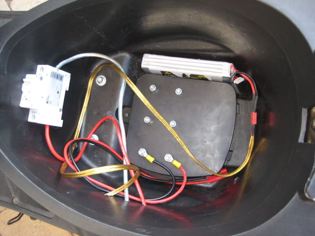

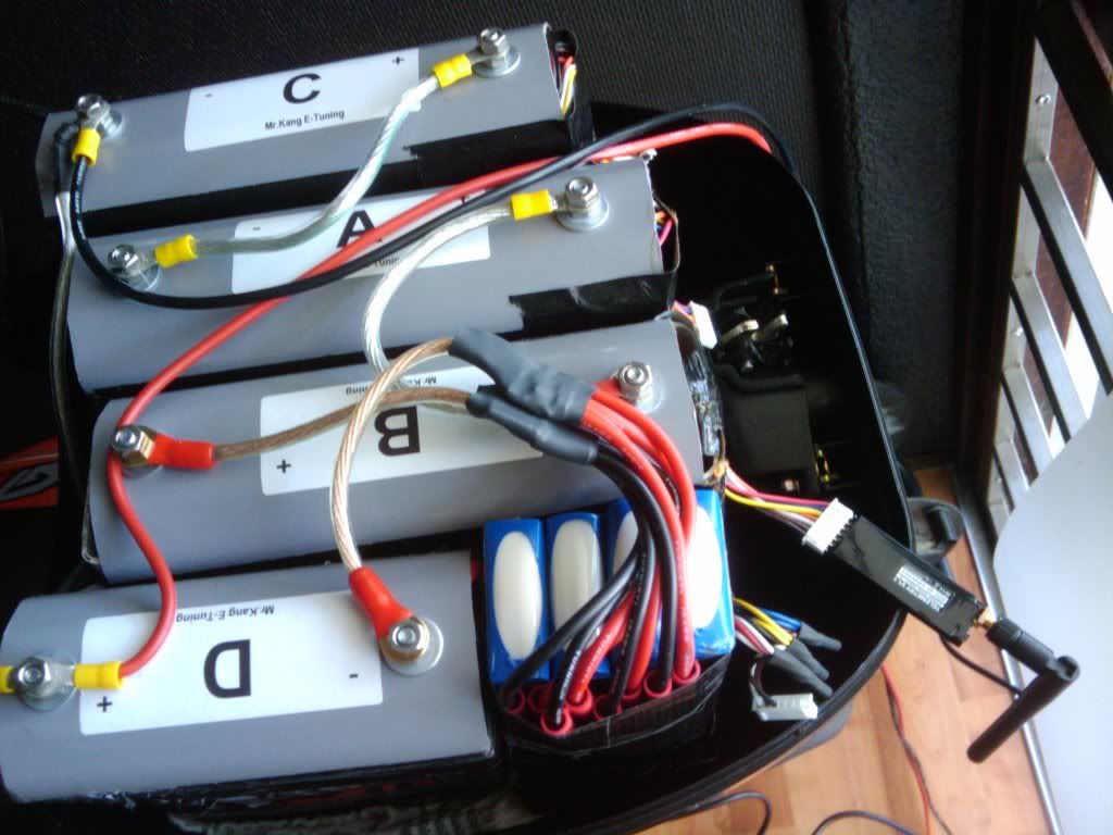

Here in the pictures you can see my setup with my Lipo batteries.
I first configured a 12S6P in the white box and then made a 5S6P pack which is positioned in a notebook sleeve for now. and put those two in serie to eventually get 62.9 Volt out of them.

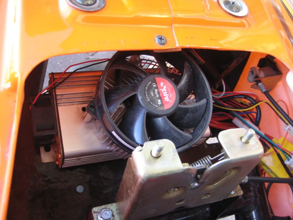

Aside from more voltage and more current, there's not much on the controller you can tweak to get more out of the motor. You could possibly advance the timing, but if you go too far, the efficiency drops too much. Changing the gear ratio might do something for you. If you increase the voltage, but also gear it a bit lower, the top speed may be nearly the same, but you'll have much more torque.
You will also be limited by the motor heating, so the motor could be more of a limiting factor than the controller.

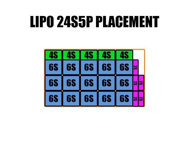

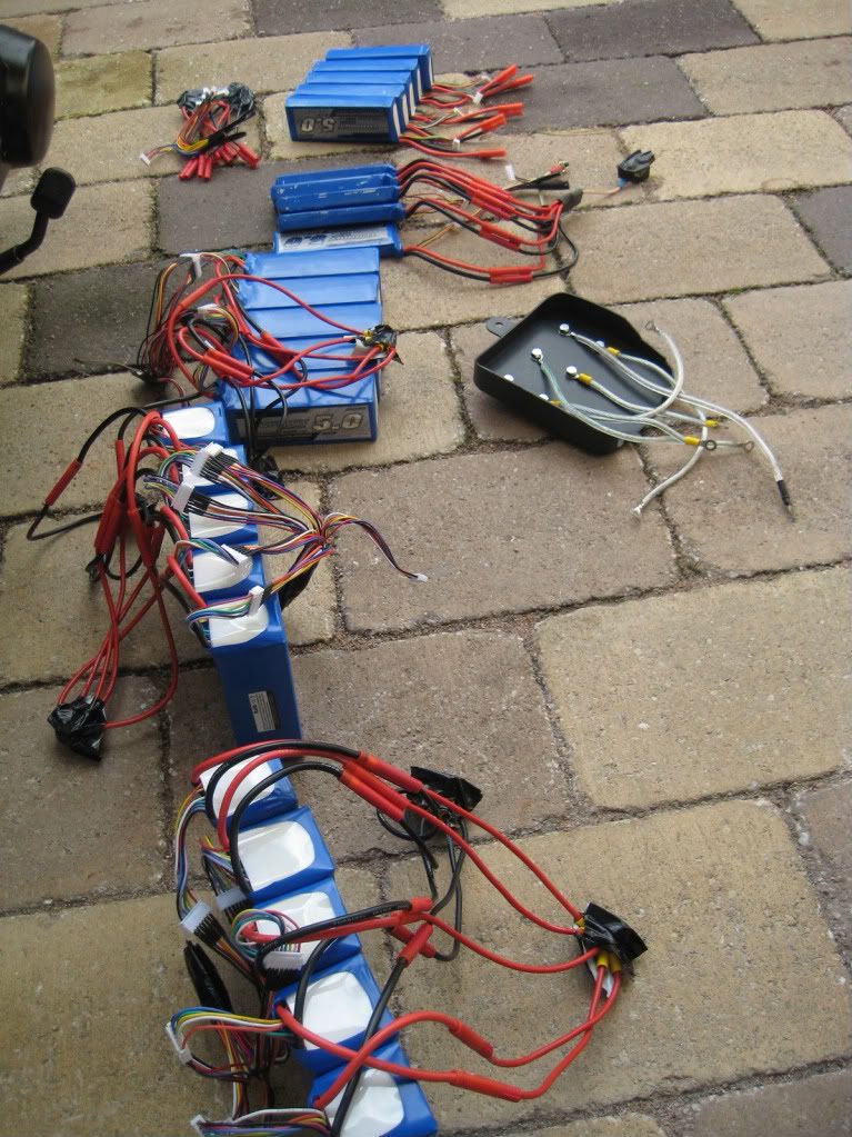

After a succesful tweak with the controller i'm starting to setup my battery configuration.
As you can see here below my plan is first to have a 21S6P config for driving.
I have all parts together to connect all balancing cables together and therefor have a more reliable pack.
Also it gives me the oppertunity to charge them with my 3 lipo balancers at once instead of 6 times when they are all single connected.
I will update with more pictures. yesterday i just finished the 6P board for my 14.8V pack. it all worked well. tonight i'm doing the 18.5 board.

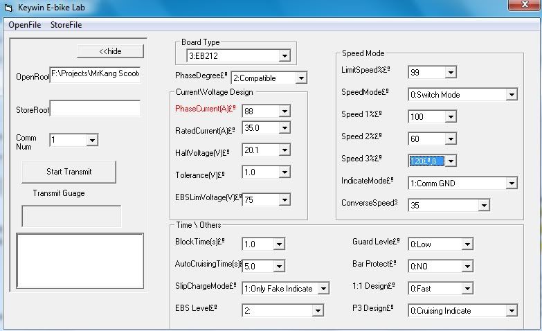

The Flashrom which is used can be programmed i think..i looked at topic : http://endless-sphere.com/forums/viewtopic.php?f=16&t=7361#p110932
and this controller look a lot like an infineon controller. Is it possible to read out the settings ?
Or can you only dump a new setting to it not knowing which parameters it had programmed on it ?

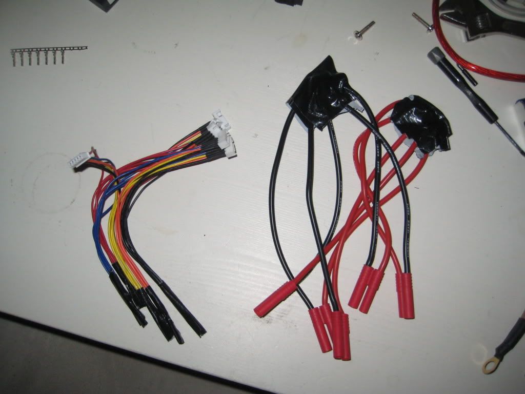

Yesterday i had finished the balance boards for all my lipo's. i allready tested it on my lipo charger.
Now i can charge them as a whole unit instead of charging them piece by piece.

I just received my t-connecors from italy. 20F + 20M with heatsinktubes (dunno the name in US) they were only 15,40 euro!
Then i will make all neccesary cables to parralel all my 22.2V lipo's. I allready did the 14.8 and the 18.5 including balance wires.
I now can easily charge them with one lipo balancer instead of 2 times each 3 pieces. So that's a real progress in charging time.
Tonight i will desolder my 22.2 lipo's which were connected in serie. Because i want them also to be wired on the balance connectors in parralel
it's safer to not do that in serie mode. i allready had a litle bang on on of the T-connectors (14.8 and 18.5) when i wanted to connect them in serie while the balance wires were connected parralel. So now each lipo stack will be seperately be connected and finally i all connect them in series.

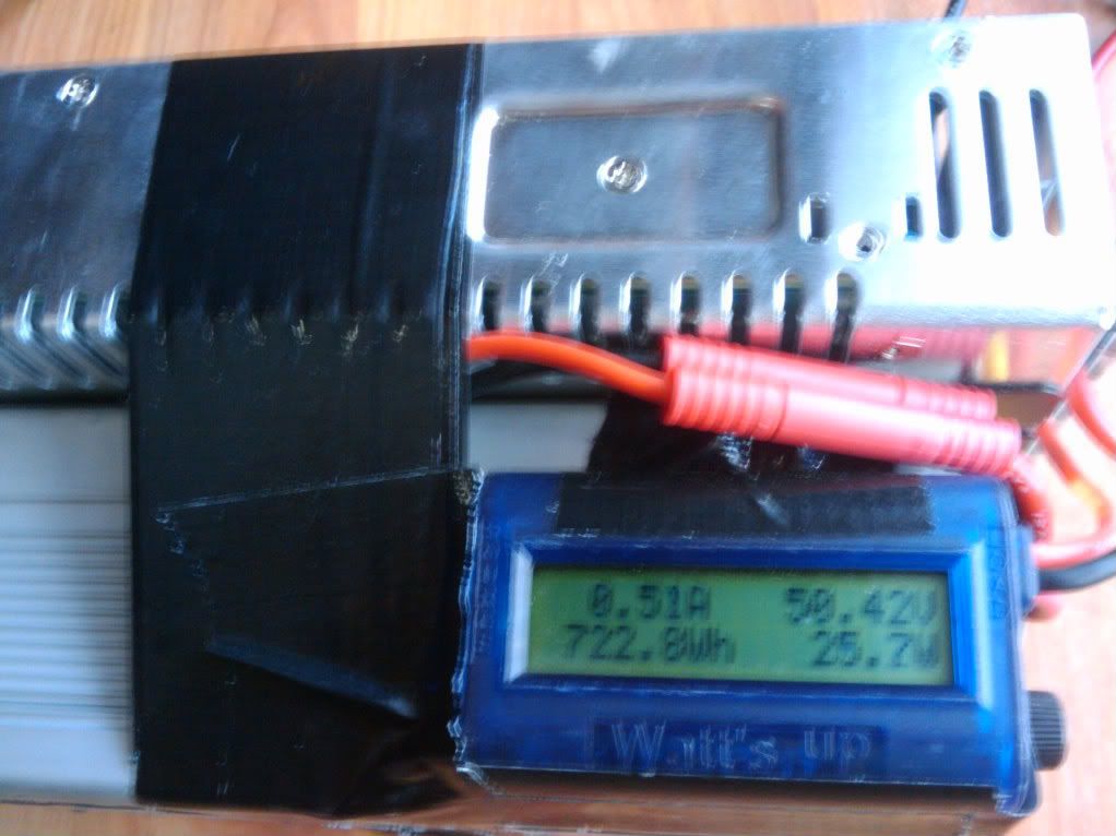

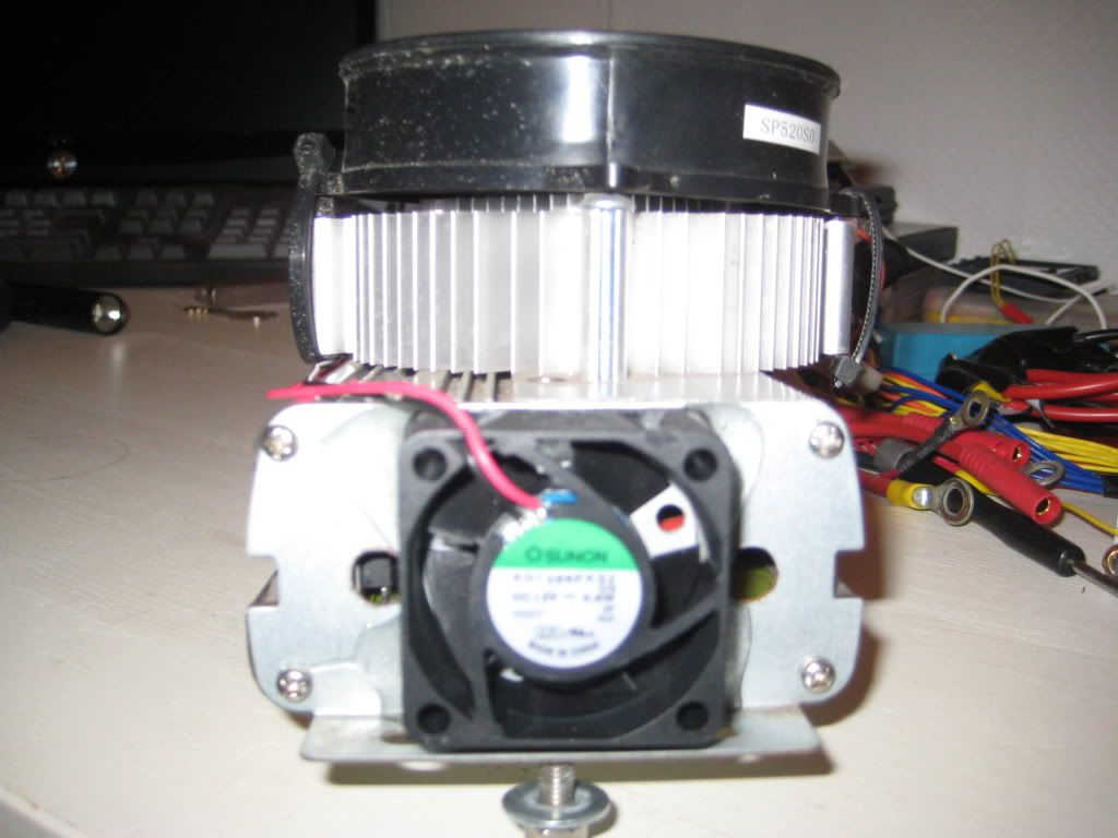

Yesterday i pulled out the DC/DC convertor to see what's inside. Because of the higher voltage i'm gonna use i don't want a broken DC convertor while riding and then suddenly my lights go off.
As you can see it's rated for 48 to 60 volts.
When i took a closer look on the input wire i saw that there was one capacitor with a value of 63V.
I removed that one and replaced it for a 400V 100uF which i desoldered from a old AC/DC power supply.
Than i tested it with some lipo's and measured the amperes. it could take 85 volts now and it draw on no load aprox. 20ma
I will continue tommorow when i replace the controller and take it for a test drive.

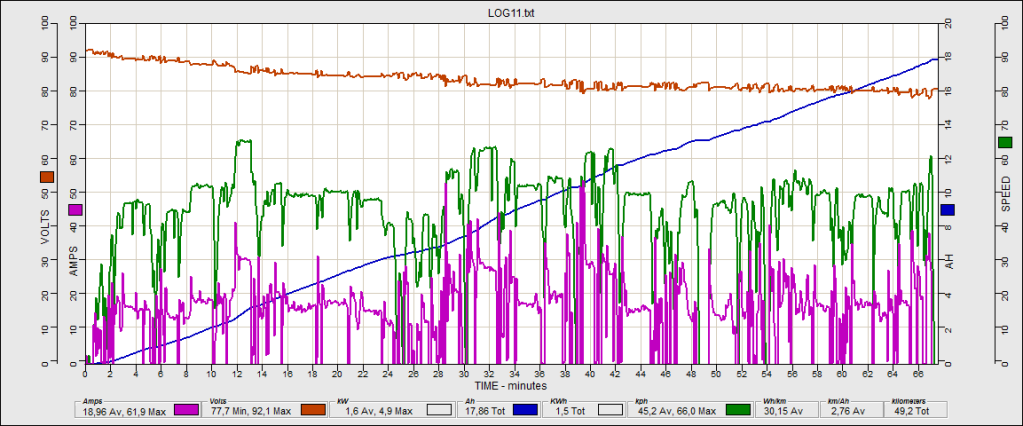

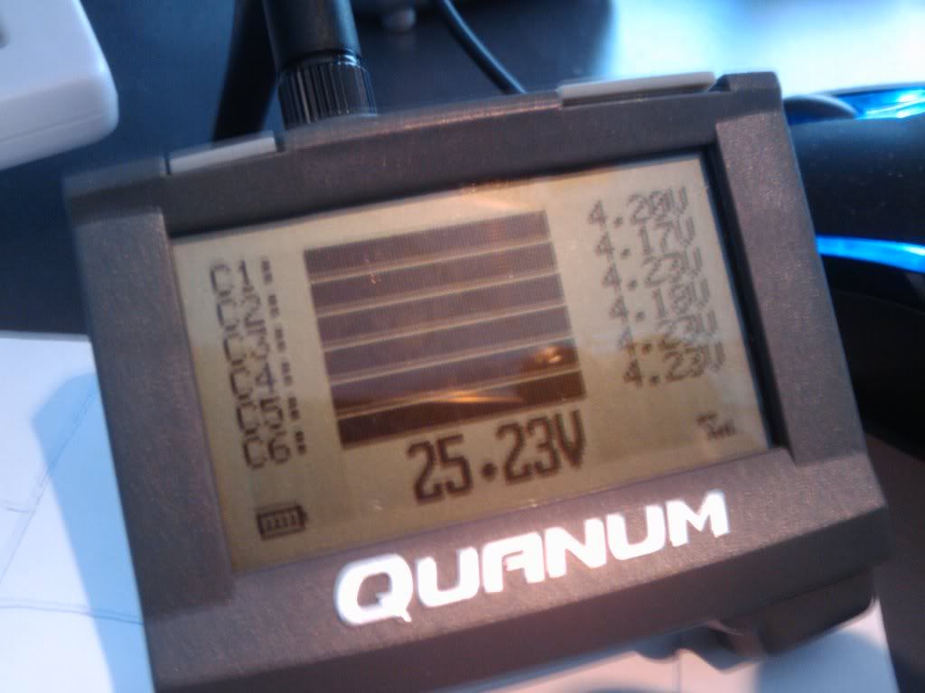

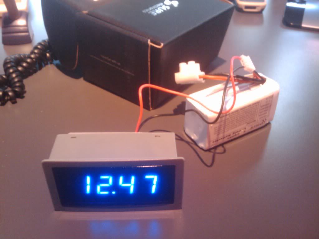

I will check my lipopack with a 6S wireless lipo checker i bought from hobbycity. that's a nice gadget i can implant later on my dashboard of the scooter.
Here tested with a 3S lipo
I will make a video and have a GPS measurement while driving for actual speed.

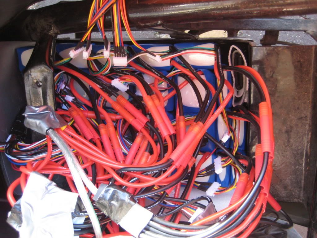

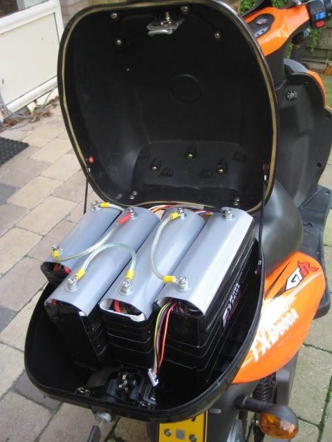

This morning i started to combine all my 22.2V lipo's onto two 6P packs.
My working table like all hobbiest....messy
All packs desoldered , becaue they were first connected two in serie. and now i had to make them single again.
Then made 2 packs of 6P
I made the 6S balance boards
and then connected and tested the min-max voltage between the lowest and highest cell.
pack 1
and pack 2
also checked the 18.5 pack

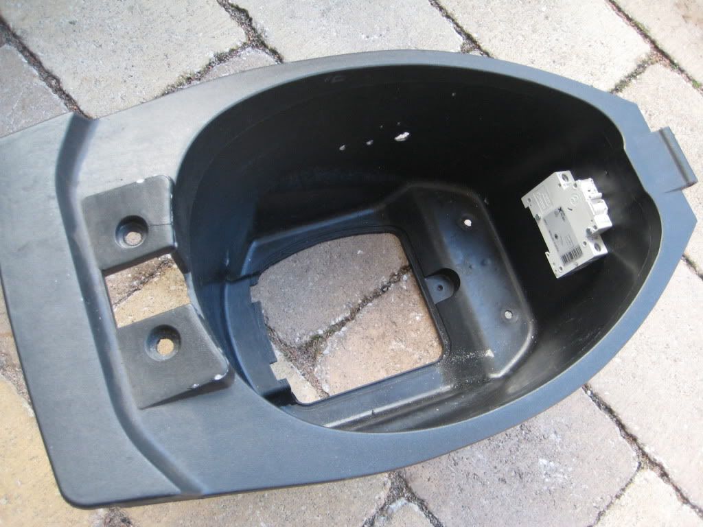

so with all 4 packs i'm ready to build them in...didn't know if it will fit the coverseat...
They all fitted well. did a short test and noticed that the controller shutsdown.
i think the voltage was to high because of the fully loaded lipo's
the total voltage was almost 90Volts...so i removed my smallest pack of 14.8V
Which resulted in a total of 72 volts.
I went for a little test run and noticed the torque power and the acceleration!
