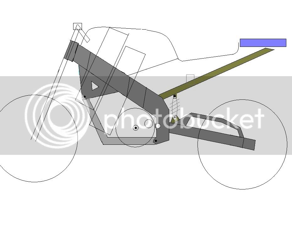

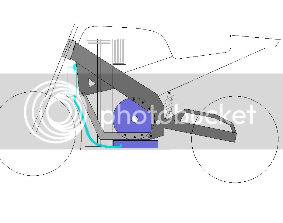

High voltage AC controllers are huge, and I'm not sure where to fit them. I've drawn a bit of a mock-up to estimate where things could go:
It will seriously affect the bike's lean angle down there, but it might work. Otherwise under the tank? Or as Chip Yates did, pizza-box behind the seat can work with some clever fibreglassing. It still weighs 13-16 kg, so that's a LOT of weight to have over the rear wheel = failbike. Hahaha! I just realised my race number is the same as Chips! :lol: What a coincidence :)

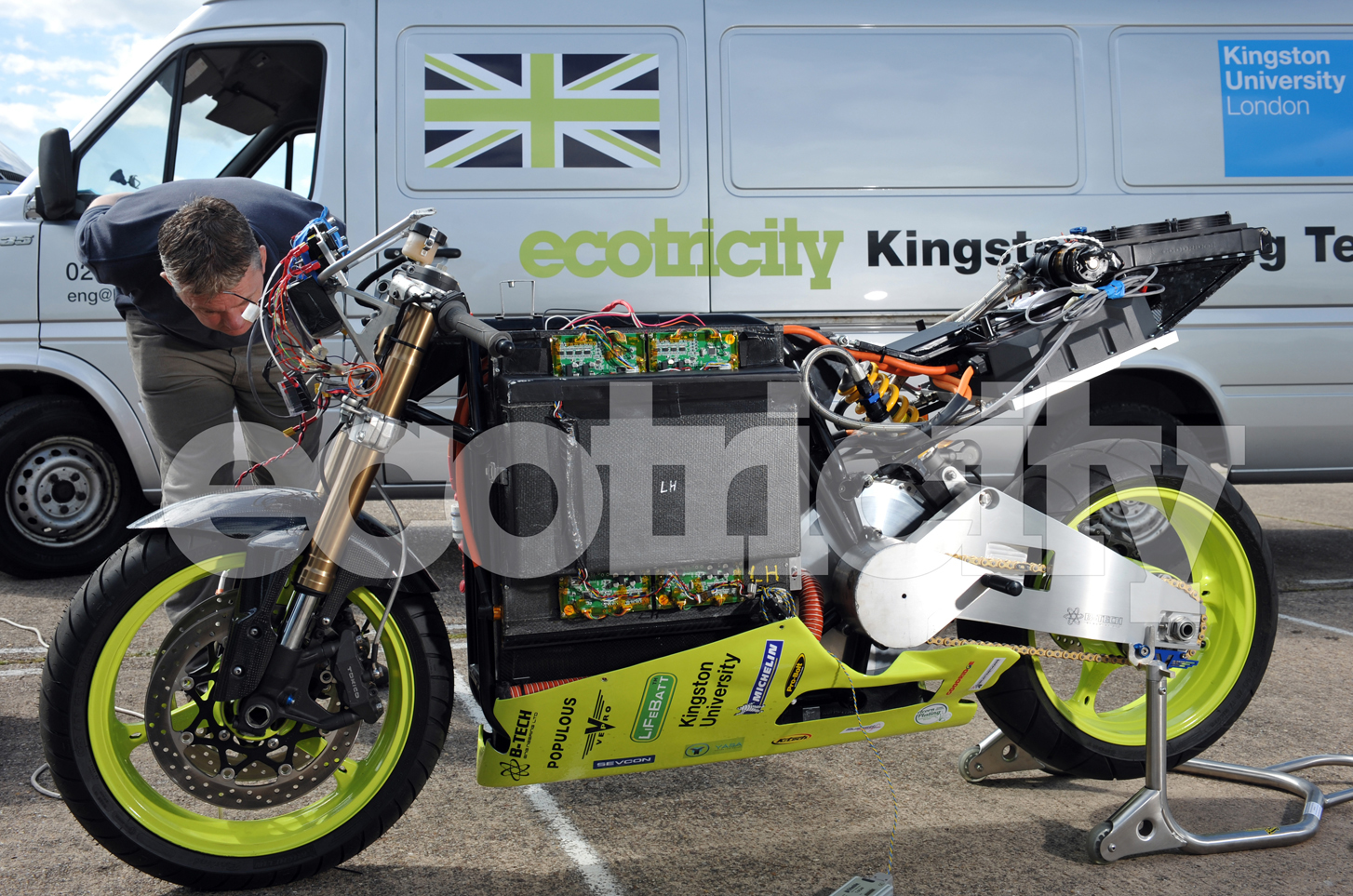

I want the total capacity to be about 7.5 kWh. As I can get access to A123 pouches this could be a safe, convenient option for energy storage. 113 cells will give me a capacity of 7.6 kWh and a hot charge voltage of 412 V, but is sure to stabilise around 380 V. This voltage is ideal for running most high-powered AC motors, and the controllers can use IBGTs. Unfortunately, 113 cells needs a careful arrangement of cells to make sure it all fits, and makes use of the space available. Fireblades, like most Jap IL4s are right fattys, so width is your friend. Still trying to arrange these large format pouches in an efficient, yet convenient way. Cell weight would be about 55 kg.
I was hoping to use acetal plastic to make it like Daniel's bike; super convenient to rip out when you need to. An idea for a tall stack is below, however, this is too tall, and I would probably do something like the image above to get the weight lower where possible:
Another alternative is using the 5 Ah 40C Turnigys and making a stack 84 cells high and 5 cells wide (105 S 4 P, 388 V, 430 V hot). Being much narrower, this leaves more room for motors and controllers etc. Balancing them will be a matter of multi-pin plugs in the right spots, with appropriate BMS/monitoring wires everywhere. This pack would also weigh 55 kg. despite their safety issues, this would give me a very energy dense pack, and slightly higher total capacity ~7.7 kWh.

Well I just went and measured up a few different bikes for space availability, and it looks like the GSXR1000 has a more spacious under-tank volume, with the R1 being second, CBR1000RR third and the ZX10 last. Still, I won't really know until I can get a hollowed-out rolling chassis to work with. However, the Fireblade is without a doubt the nicest bike to ride, and althoug it will be tough to break my Honda fan-boy ways, I might have to resign to a Spewzuki. So I will keep looking around. All three bikes had enough room for a 250 mm deep motor where the gearbox resides, meaning a UQM or Ultra motor will probably fit in there, but the >280 mm diameter of these guys means there is not much room left for batteries down low at the front. An alternative might be to shift the motor to the front and run a reduction drive to the pivot point:
This still means a lot of weight of batteries up high, so I;ll have to think a bit more about this one. Dammit I really need an empty bike to work on!

Not a bad idea on the battery stacks KiM :shock: It would almost be easy enough for one person to tug them out too.
A 600 chassis doesn't really offer much of a weight reduction than a thousand, 10 kg at best. The thou's are a little bit wider across the bow, which helps when trying to fit more cells in. With the motor power I have in mind I'll certainly need the extra capacity anyway. I managed to fit everything on the RG cause the Agnis were able to free up an extra 30 mm inside, meaning I could fit the stack of 48 cells in the engine bay.
Shame someone doesn't make a powerful synchronous motor with a long profile but no bigger than 250 mm diameter.
