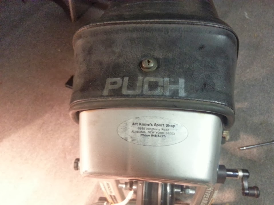

Postby grindz145 » Fri Jan 17, 2014 10:57 am
I don't do resizing...
12 - 1.jpg (44.36 KiB) Viewed 7276 times

Postby rjoe » Fri Jan 17, 2014 1:13 pm
Where did you find such a nice specimen?
And is that an MB5 front end?
Last edited by rjoe on Fri Jan 17, 2014 1:14 pm, edited 1 time in total. View post history.
rjoe
Posts: 87
Joined: Fri Sep 16, 2011 1:19 pm
Location: Baltimore
Re: The Revival - Puch Magnum Build
Postby grindz145 » Fri Jan 17, 2014 1:17 pm
rjoe wrote:Where did you find such a nice specimen?
An inverted cartridge fork on an MB5?

Postby EVTodd » Sun Jan 19, 2014 11:52 pm
I'm really looking forward to this build!
I'm hoping it gives me inspiration to start back up on my Garelli moped project. I've changed my mind about what I want to do so many times...
Are those pit bike forks? They look great. I think I like them better than the k10 forks I'm using.
I really like the idea of using a moped as a base for a project like this. Only issue for me is that I look like a circus bear on a trike when I ride it since I'm almost 6' tall and around 200 lbs. It's lots of fun (still ice powered btw) but they're soooo small even compared to a mountain bike. Perhaps longer forks like the ones you have along with longer rear shocks and maybe an extended swing arm would make it look bigger and less silly. We have too many harley guys around this area being dicks... Kinda makes riding a moped less fun.

Postby grindz145 » Mon Jan 20, 2014 12:09 am
EVTodd wrote:I'm really looking forward to this build!
If you see the other thread, you'll understand that I share your mind-changing tendancies :D I have some enertia now though.
They are indeed pitbike forks, made by fast ace. They're oversized, but It looks like I'm going to be able to tune them in. I'm a freaking midget (5'5" with very short legs), so the proportions make more sense. It's easy enough to build a simple moped frame from scratch, and register is as the Garielli.
As far as the dick motorcyclists are concerned, a rocketship moped is a surefire antidote :mrgreen:

Oh my goodness that frame is absolutely perfect for an electric commuter. I am really looking forward to seeing the finished product here.
