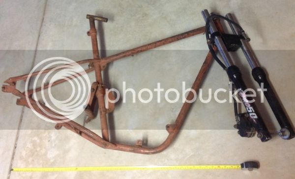

I have a picture of the frame stripped and a set of forks I had laying about. I want to have a bobber/ cruiser kind of look to it.
Tape measure is for reference, 1metre.
My first idea was to connect 2x 36V-10Ah 'silverfish' batteries in series to give me 72V, make 2 sets of that, and parallel those bad boys to give me ~20Ah as well. They'll be around 30kg including brackets, etc, and bolt into the existing holes on the frame.
Step in and correct me at anytime people, this is all theory for a few weeks, while I iron creases out.

Well an interesting project.
But have you thought at all about metal fatigue? Your asking 66 year old metal to suddenly be able to handle forces that it was never designed for even when new.
Take a look at some of the frame up builds that are being discussed here. Note that they are all starting with a much beefier frame which has been designed for its intended use as well as accepting contemporary parts.
Why spend upwards of $2k on parts only to end up with a finished product which is not up to the task? Its like building a house on a wobbly foundation.
Best of luck

Excellent point Kent.
My first impression of this frame was that the gussets and general heftiness of the whole thing would be adequate for ON ROAD use, as I intend to do zero bush whacking with the bike.
The old red oxide paint its been splattered with does it no favours in the looks dept.
Regardless of impression, I will definitely be taking it to the metallurgist at work and seeing what his Verdict will be.
Thank you for informing me, I definitely don't want to bust a weld at 80km/h!! :shock:
