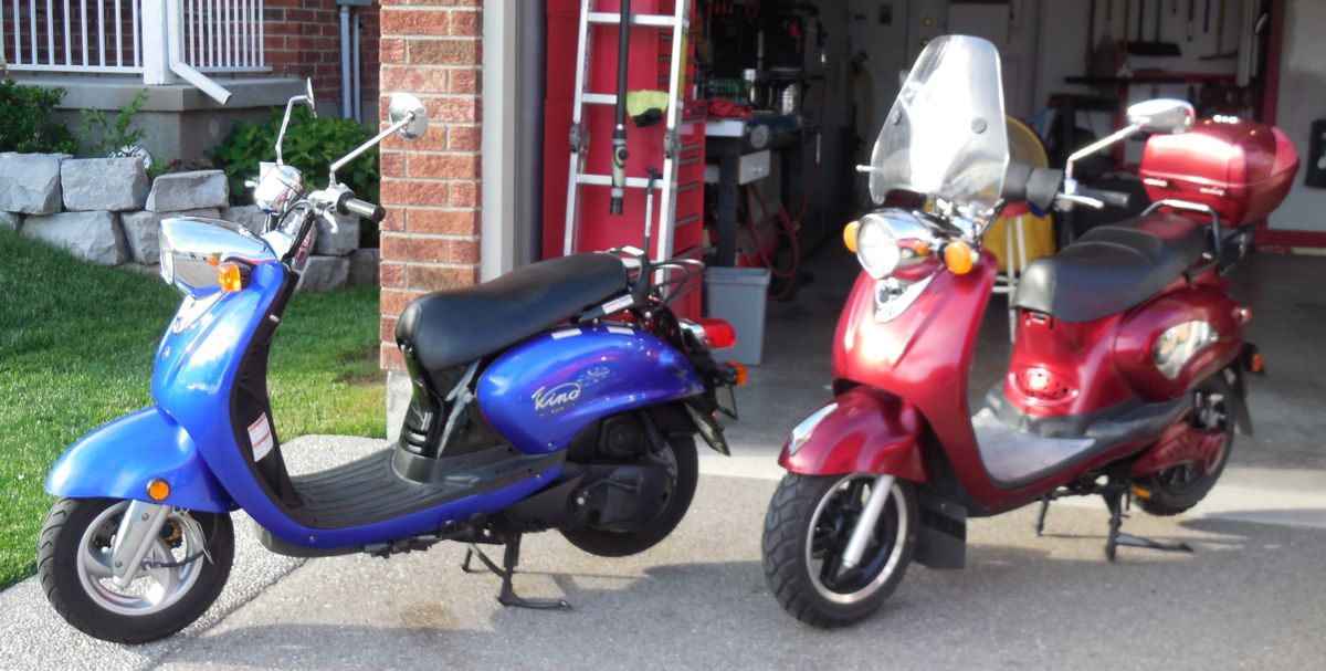

Congratulations are in order, you got it done. I really had my doubts :) QS Motors has an 8kw motor in a 13 inch wheel. Yours looks like a 16 inch wheel. With that 120/70-16 tire that's a diameter of 22.6 inches :shock: The QS Motors 8kw V3 13 inch with a 120/60-13 tire would have a diameter of 18.7 inches. The fitment and look would be much better. You would loose a bit of top speed but you'd get even faster acceleration, maybe enough to beat that GSXR750 off the line.
And here's another suggestions from an old guy :wink: Now that you know how well your system works, get a 2004/09 Yamaha Vino 125cc. I'm sure there are plenty of them for sale in Vancouver. Then convert it to electric with your system. Bring back the Motorino to stock form and sell it, you won't need it anymore because you'll have a legal scooter with insurance and registrations and a motorcycle license and best of all, that little scooter that everyone likes to laugh at will smoke just about everything that's on the road off the line :lol:
That is what I'm doing as a father/son project. We're going to convert a Vino together. Here's our blue 2007 Vino we found for 1000 bux sitting pretty in front of my illegal Motorino. As you can see, the Motorino XPn uses the chassis and body of a cheap Chinese knock off of the Yamaha YJ125 Vino. But the fit and finish and quality of parts of the Yamaha Vino is 100 times better.
