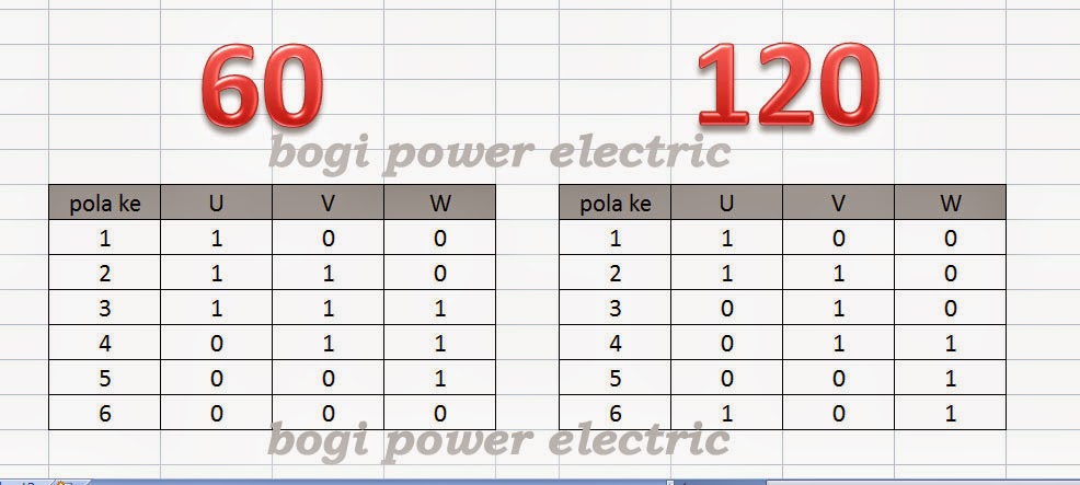

I am trying to pair a new Sabvoton controller with a Sunra Motor - the model no is XR3000W72V15008002.
The issue I am having is with pairing the hall sensors to the controller.
I have tried all combinations of hall phasing and motor phasing but it keeps failing.
When I rotate the wheel the hall status field varies from 0 to 7. I have read elsewhere that 0 and 7 are bad but I do not know why.

Hall sensor tester shows all sensors are fine but there is a position where they are all off which is corrrct according to the tester documents

I'm pretty sure it's a 60 degree hall setup.
Can you switch to 60 degree hall sensors in the programm?

yes i have set it as a 60 deg setup - the test gear shows it as a 60 deg and the oem controller indicates 60 degs.
Do you suggest set the software to 60 then swap hall sensor signals and motor phase signals until I get a working set up and ignore the hall sensor setup?

What I meant is to set it to 60deg in the debug tab of the software, and then run auto identify.

Tried various combinations of hall angle - still no joy. Getting really annoyed with it!
Re: Sunra 3kW Motor and Sabvoton Controller
Got it working by moving the hall sensors. Though now seems to max out at 300rpm, which is only 25km/h
