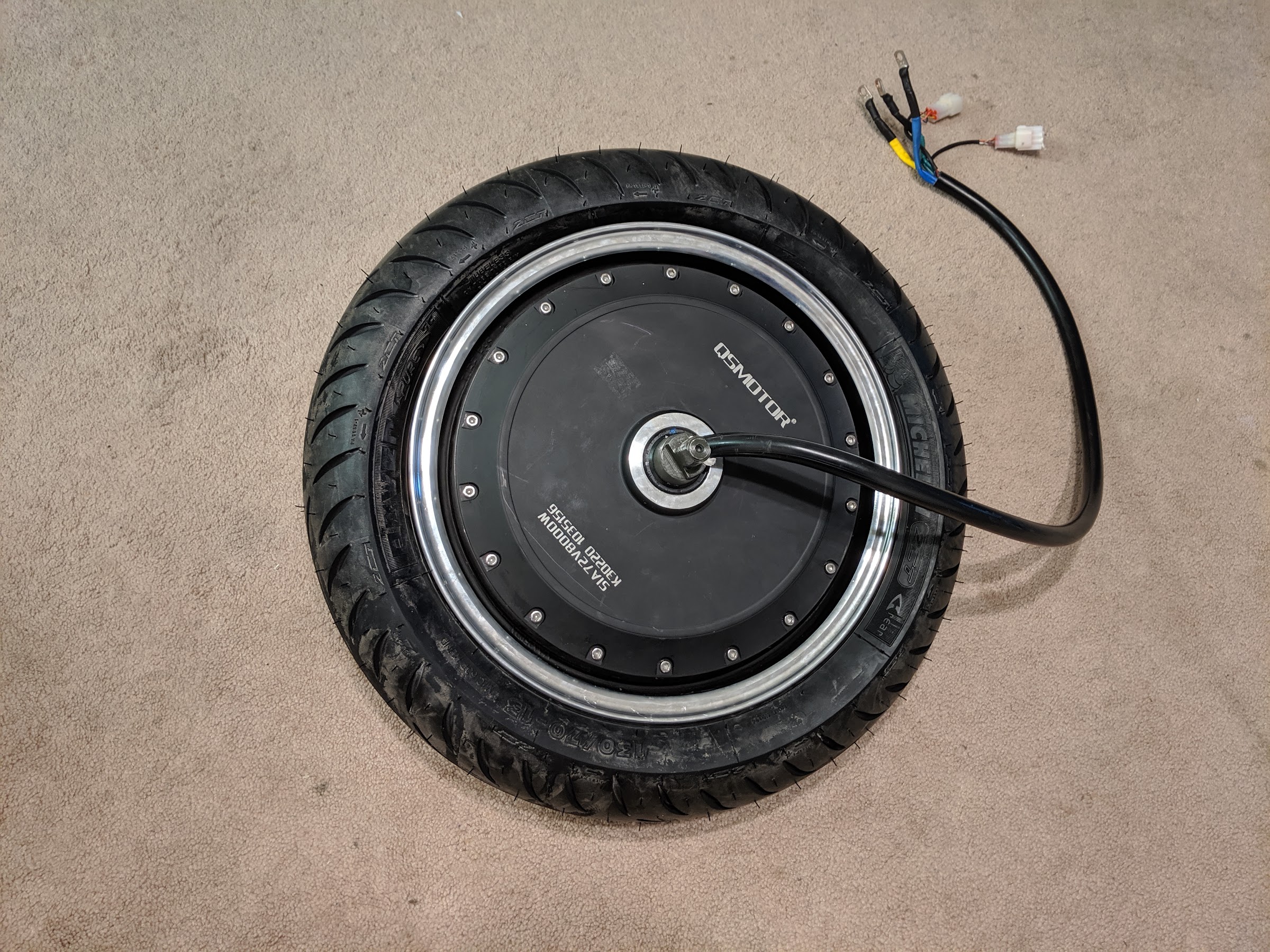

Hello! I just finished up my Kawasaki Z125 conversion and I wanted to share it with yall. This forum was super helpful for ideas and info during the build.
Here was my totally stock Z125 Pro (excpe the bar end mirrors).
This is a small bike so I decided to go with a hub motor to conserve space. I ended up selecting an 8kW QS hub motor and a Kelly KSL-7275H controller. This system runs on 72V.

Next I wrestled the tire over the wheel.

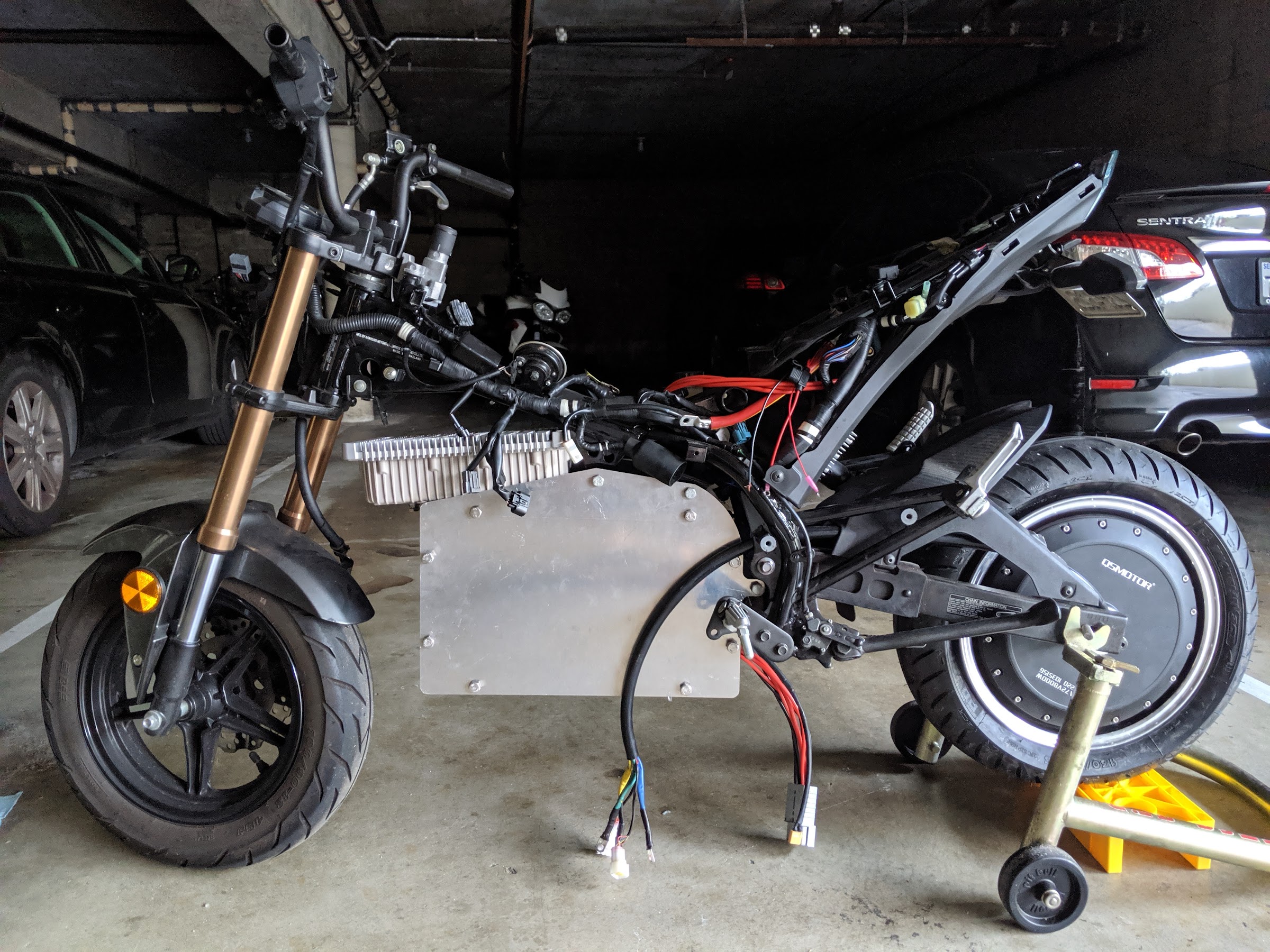

After that, I got everything mocked up on the bike. Overall I like how it looks! The battery fits really well (mounted to the old engine mounts) and doesn't really look all that out of place. The controller is a really tight fit on top. I took some measurements during this mockup install to make some brackets for the controller. I also needed to relocate the horn since that goes right where the controller is sitting.
The wheel/motor will sit slightly behind where the stock one was. I made plug that goes into the back of the swingarm and provides the slotted mount to hold the motor axle. The cable bundle from the motor runs up along the inside of the chain guard toward the controller.
Once I took the battery and ECU out, the DC-DC converter (72V battery step down to 12V to run lights and gauges) and the main contactor fit in there.
I painted the battery box black, then added a strip of black plastic around. This looks a lot better than bare aluminum and the blue battery plus I think the plastic will help protect against small rocks and debris kicked up by the front tire.
Things were getting a little tight with the new components so I also freed up some space by getting rid of the unnecessary wiring. There are a whole lot of wires once I cut the harness open and I really gave those Harbor Freight wire cutters a good workout. I even got a little too snip-happy and cut off the horn (oops). The only thing I really wanted to keep was the lighting circuit. However, it turns out everything runs through the speedometer so once I got rid of that I needed a separate standalone flasher relay. It works now and I reduced the the wiring by a lot.
I figured out some brackets once I had everything mocked up and cut them out of aluminum. I don't have a lot in the way of tools and workshop space so everything takes longer than it should.
The controller packages tightly right above the battery and picks up the old airbox mounts. There is barely any space with steering at full lock, but it does fit.
The DC-DC converter goes under the seat, where the battery used to be.
The bike looks super clean from the right side after installing the wheel/motor. Finally back on the side stand! I also installed the throttle and mirrors.

I asked Damon of QSmotors if they could supply this 8Kw motor with a 320mm axle, and he confirmed they would. That would ease the construction of the swing-arm plugs enormously for my build.
I am still trying to figure out, if it would be possible to machine the outer plate of the motor, that it can hold a Yamaha disk with 6 bolts. This tiny 3 bolt disk that QS suggests doesnt look tough to me...

I used 6061-T6 aluminum. The motor axle and the plug shouldn't be moving relative to each other, so in theory you shouldn't have any wear problems with any material.
Thanks - I went ahead and got a set of adapter plates machined in 6061-T6 aluminium that slot into the box section of my swing arm. Just mounted the motor and test wired everything up - seems pretty solid with the brake disc mounted as well.

Here's the motor and battery. I'm not sure I understand the question about assembling the motor and hub? They are integrated when you buy it.
I think it was this hub motor: http://www.cnqsmotor.com/en/article_rea ... r/264.html

Re: Kawasaki Z125 build
Posted: Mar 30 2020 2:34am
by Dui, ni shuo de dui
Awesome build, very clean.
Just a few remarks and suggestions, if I may:
-You should put a second nut on your motor axis, to secure the first one. If it gets loose because of vibrations then you'll ruin your motor.
-150A seems quite weak since you're using a 8KW motor. I dont know if your battery and controller allow you to go for more, but your motor is way overspec. You could double that amount of current and still be totally fine with such a motor. :wink:
-If you can, don't hesitate to change this puny front brake and upgrade to something better. You can find some really good brake kits, stuff like frando or clones like that. They re very affordable and you'll see a clear difference agains the stock ones!
-Carbon vinyl might look nice on your battery box. It is already ok in black, but everything looks better with carbon :wink:

Thank you! You're right I should get a double nut in place. I maybe need to cut one down since there isn't much thread sticking out.
You're also right about the motor power, but my battery is the limiting factor for current draw. Maybe in a few years as batteries get better and cheaper I can upgrade and keep all the same motor and controller. The cost difference between 5kw and 8kw hub motor was pretty small so I just went with the bigger option that will run cooler and allow upgrading later.
With the rear regen brake, it's like a game for me to try not to use the front brake as much as possible so I probably won't upgrade it. I want all that energy back!
