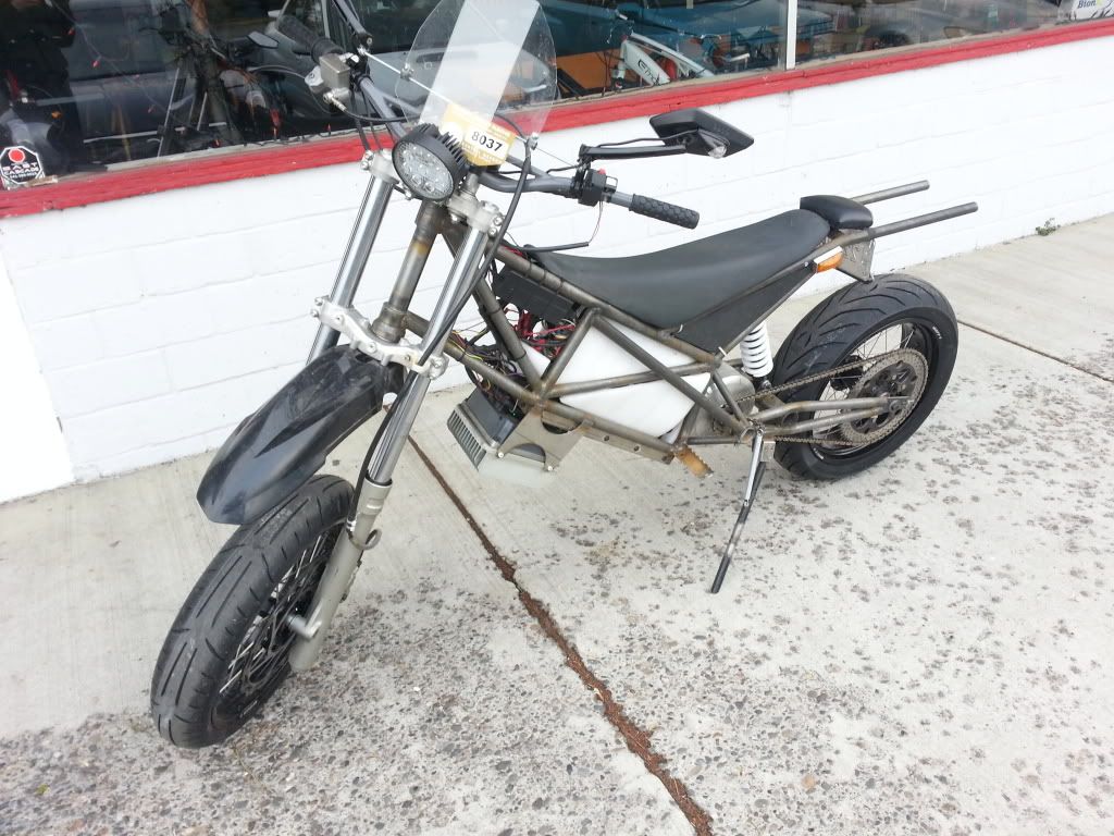

Postby Farfle » Tue Apr 16, 2013 10:00 pm
Heya guys, because the emotarpedcycleracer has evolved REALLY far, I am starting a new thread. I plan on racing with (and beating) the zeros and gassers in the M1GP race series down in socal. :twisted: :twisted: :P
Here are a few shots of it in its current state. Not a whole lot of stuff left to do, After the real spokes get here, and I get the folding pegs and sliders set up, she will be track ready.

Looking good Farfle...what are your intentions for the two pipes straight out the back of seat, mudguard?
Looks very long and low, seat height is low thats for sure.

Its a little lower than I had expected, seat height is 31" . The tubes are going to be a cargo rack/rear seat for my GF. They will probably get cut off for the racetrack. Speaking of which, ill do that today and take some nekkid pics if the frame and components.

We have done 2up on the bike before this guy (same motor diff frame) and horsepower wise it was fine, but the suspension and brakes suffered. The new frame has unlimited stopping power, and much more beef, so should handle it just fine.

One other thing it uas started to do though, is when you apply the brakes lightly, it makes a farting sound. Not a loud flapper fart, but a musical one with a very audible tone to it. :| . Hopefully it goes away as the pads bed in.

Had a lil problem last night. It seems that my pile of spacers and bolts got too cantilevered, which caused the inner hub to separate from the outer. 8 mangled bolts and an oz or so of ground rubber later...
Worst thing about that is that the gf was on the back for a lil date night.... :roll: . She is super awesome tho, and was suggesting ways we could fix it and keep rolling . :mrgreen:

The new hub is now indestructible. I would be totally confident in 1k+ ft/lb and this hub not failing. Eight 1/4-20 bolts on a 2" radius threaded into the hub, and nutted on the backside. And six 1/4-20 bolts on a 3" radius, also threaded into the hub, and nutted from the backside. Oh, also got the rear brake mounted and bled.

You use an O ring chain that retains oil well, and lube it off the bike. I take it off and throw it in an old crock pot full of motor oil then wipe it clean and put it on the bike. As for the sprockets. They get a dose of super heavy metallic grease. Also, the rear caliper is also REALLY badass (origionally from a fat utility quad with tiny lil rotors) So it doesn't care if the pads are fouled.

Thanks man. The reason I run the sprotor, is because its a lil lighter, mechanically more simple, and it looks cleaner. I also started with it, as I had pedal drive on the right.

The bike can walk a stock 450, but was a touch slower than the 613cc factory racing overbore/ stroked monster ktm :twisted: :twisted: :twisted:
We had a pretty competitive rider take it for a spin, he was a little doubtfull riding onto the track but after the first lap he was on the hunt catching up and passing a few of the other bikes. 9 laps later when we were finally able to flag him off the track (he went in with a half full battery), he was grinning from ear to ear, the first words out of his mouth, were how much he could get one for, and that that was the most fun he has had on a bike in a long time. (I think we have a convert :mrgreen: :twisted: )
We were pretty stoked. Here are some pics of the event.
