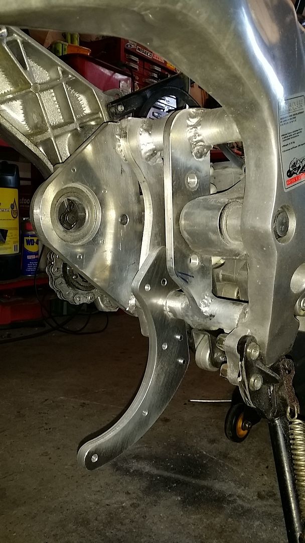

They are just casting marks Jay
Andy you will still need to run a tube between the swingarm bearing inner races over the exposed part of the swingarm axle.
So the screw in the right frame can push the swingarm over to the left without flexing it.
My 2 short pieces of SW axle thread into the 2 alloy plates so they are effectively held either side of each bearing.
The 2 alloy plates still need to be welded to the frame

You mean like this one I made the other day... :wink:
Bored to 14mm, outer diameter 30mm, length 93mm.
Spacer sandwich to get the motor plate in just the right spot.
Fits nicely. I will use the small square block as part of a bracket to hang the controller from.

That spacer looks suspiciously like steel in the first shot but bright like alloy in the second shot.
Stick with alloy there is a Capral aluminium place in Minibung rd Cardiff that sells offcuts, not sure about rounds though.
That spacer will work but would be heaps better if the motor was back.
