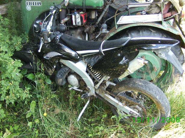

Hello
So the last days i getting started the work on my "old " Motorhispania RYZ .
First i order the Parts (Motor"HPM300b" ,a raw rear Sprocket 75 T ,a 12T front sprocket ,and a raw Sprocket for adapt the front Sprocket to the Motor and a Motorholder plate made of Alu .
This time i test direct Order from the GM-Homepage in China i order it and use Paypal and 8 Days later the parcel arrive include QualityCheck papers etc. !! Great !!
First time (E-Chopper Projct) i order the Motor from my local Dealer i wait 60 Days and pay 100 bugs more and there where no Papers inside .
So in future i only use Direct order !
So the sign reveal the origin
first i test the Motor because quality check Papers are good but i have to checking it myself (Ampere-RPM-and Voltage sag and ohm of coil )
The "new" Motor looking differnt to the first one .I think the change some things ......the axis is now black and larger inside of the motor .
The old HPM3000 Motor you can see the inner side of the bearing-ring from the outside .Now there´s a bigger bearing and you cant see it from the outside because the axis is bigger .
May a picture can explain .
the parts i need to get started now all arrived
more work progress Pictures etc. will follow
Sorry for my bad english
Greeting Martin

so the bike was strip down
next picture show the DIY adapter i take a old drive shaft from the original Minerelli motor and weld it on the raw sprocket, and i also weld a splint pin on the inside .
Now it fit with the motor axis and i can change the sprocket any time against a bigger sprocket .
next step was to adapt the raw rear sprocket to the tire .
i also rebuild the rear swinging arm and lubricate it .later i put the parts together ( my dog monitored all !)
greetings
Martin

Hello!!! now the Work an the Cover is completed .
front side i mount the Cover with two srew´s and back side i use a elastic rubber band for easy and fast remove !!
picture show the Bike from rear side
from the left side
and this happy guy is the owner of this bike :mrgreen:
after a longer testride( +-10min) i was happy with the Result only improvment -
i change the position of the seat (height) .
now i save money for the cross tires .
meantime i think...... the conversion is well done
