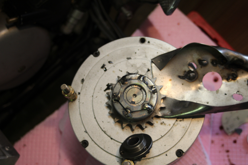

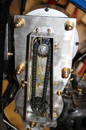

I am wondering if anyone out there has found a sprocket that works with the golden motor HPM3000B?
I already have the motor and it has a 20mm shaft. I am using a 420 size chain and cannot located a "bore sprocket" that works with this chain with 20mm shaft and a key. I cannot switch to a different chain size because the sprocket is custom to the rear wheel. I do not have access to a mill or lathe to make my own sprocket. I have only been able to find 3/4 Inch sprockets with keyways but not 20mm ones.
I would be willing to pay extra to have one made as well.

I cant find a fin 420 Sprocket with 20mm too so i made it DIY..........
I buy this Sprocket https://www.ebay.at/itm/1-Kettenrad-mit ... 1027621264 and costum it .
In your case i would buy this "https://www.ebay.at/itm/1-Kettenrad-mit ... 1027621264 " and weld on one of this https://www.ebay.at/itm/1-Kettenrad-mit ... 1027621264
But it must weld with Precesion .
My other Project i use this method too i buy this 20mm Sprocket and weld a other sprocket on it .
hope i could help .

Thank you for taking the time to respond and posting the pictures, I appreciate it. Ill look to fabricate a sprocket myself as you did. If I find some options pre-made, Ill post them here as well.
Thanks for posting your build!
