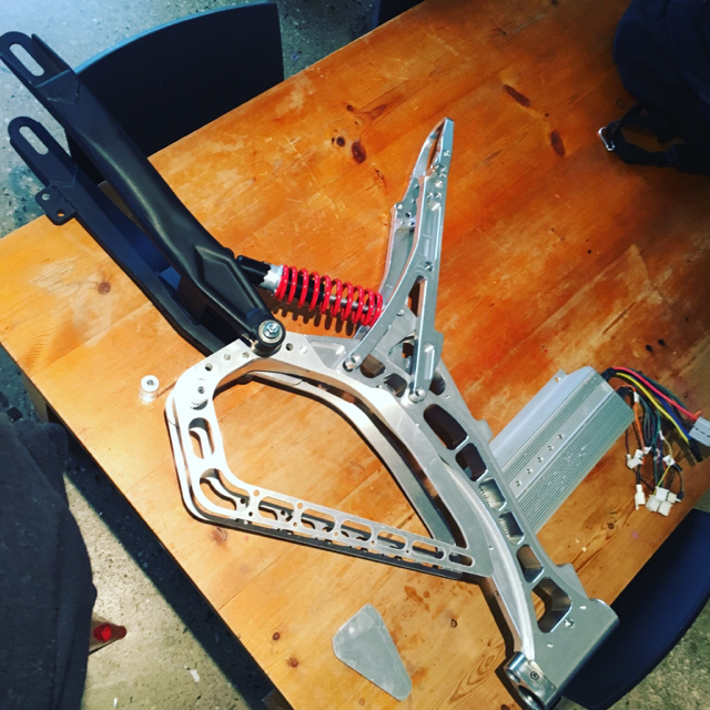

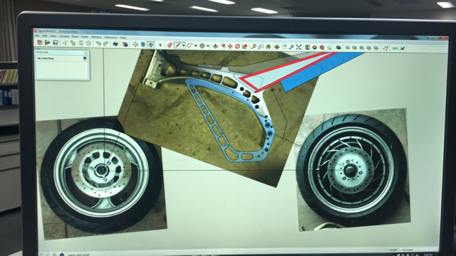

Hey guys I got this frame cheap for $50Aud and waterjetted up the side plates for a battery cradle.

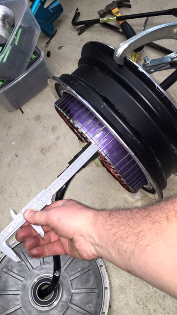

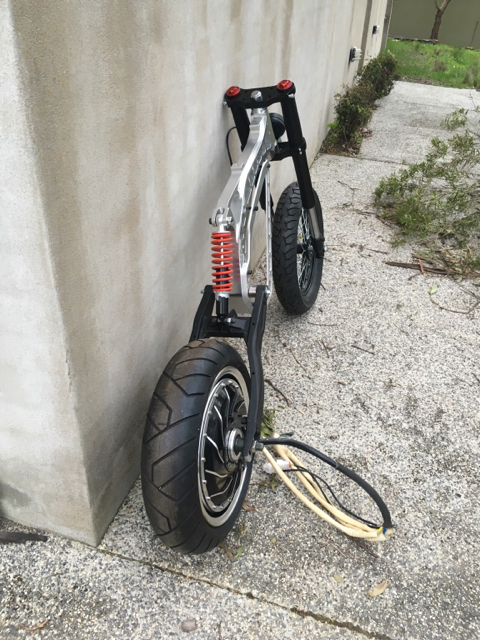

Also got a bunch of cheap 13" scooter motors. Quanshun axles and magnets aren't exactly best in class but it will do. Mxus45mm up front for comparison.
Pleased to crack open the motor and find a 273mm stator in v2 aluminium with 45mm wide guts.
Did some CAD work.

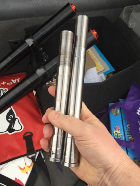

Forks needed a new steerer turned up.

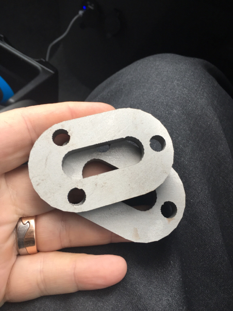

Torque plates waterjetted for the steel swingarm.

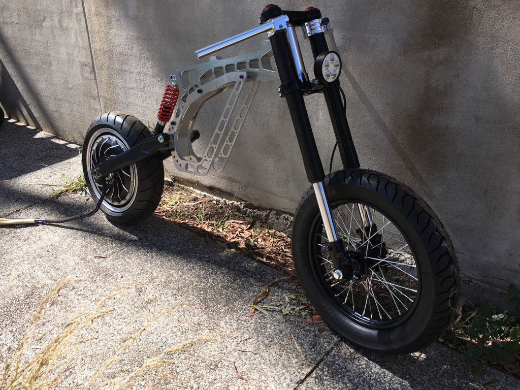

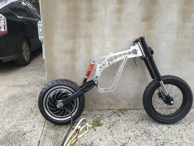

Front wheel sorted. Scooter tyre just clears.

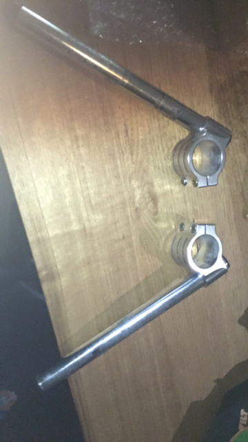

Clamp ons need about 1.0mm reaming to fit.

You'll want to extend the swingarm to be able to take advantage of the torque potential...and a big-ass controller too, since several hundred amps battery side with less than a 1.5:1 phase/battery current limit ratio is what the motor deserves. I have a 50mm wide with a Kv of about 18rpm/v and had no issues whatsoever pumping 425A battery side 510A phase limits. Well I did have one issue, which was keeping the front down with a much longer wheelbase and weight forward bias. Like LFP said, you'll definitely have a handful with the right controller.

Heya John, thanks for the advice. Yeah no surprises with the wheelbase issues. I'm a mech eng and am mindful of it.

Got some new clampons. Too hard to ream the old ones

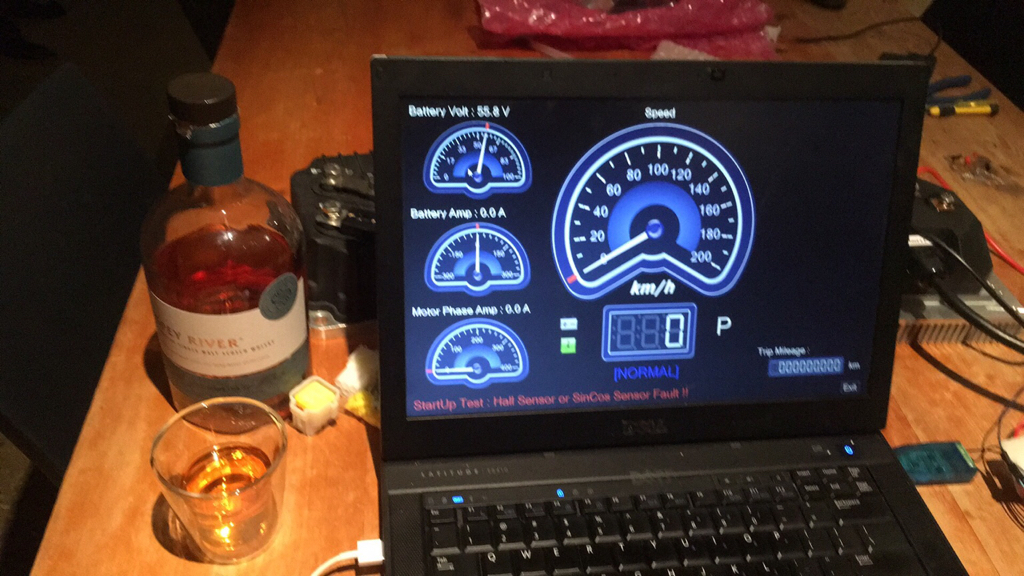

Mobipus 72200 and 72600 controller testing looking good. Just bought a 7" tablet for the dash.
Here's a video overview of what these oem level controllers can do.
https://youtu.be/_zL8zXFmEbI
I like that foc can be invoked at a given speed to increase top speed.
