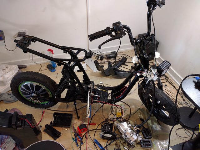

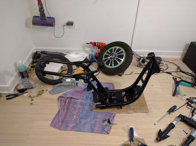

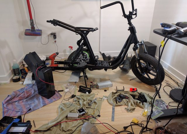

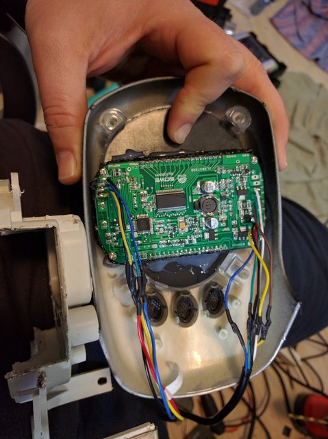

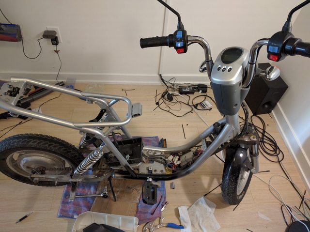

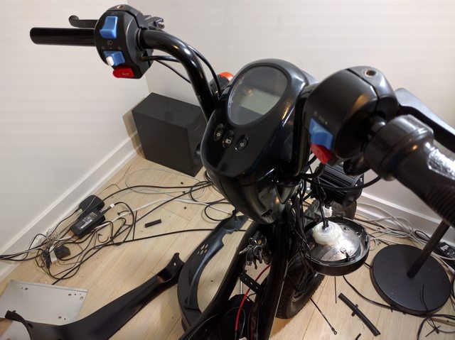

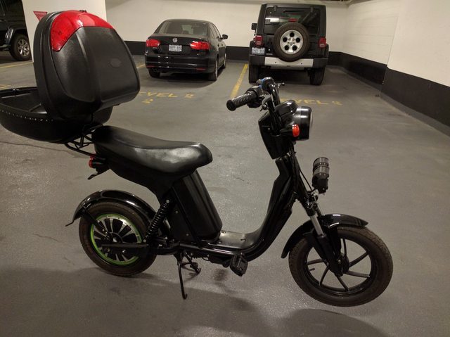

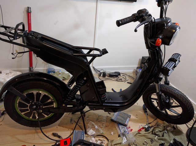

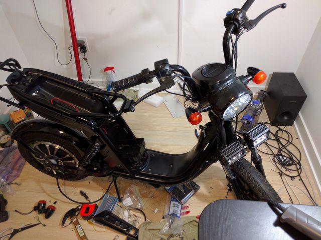

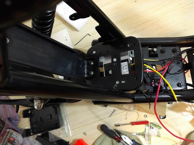

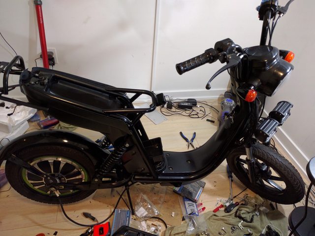

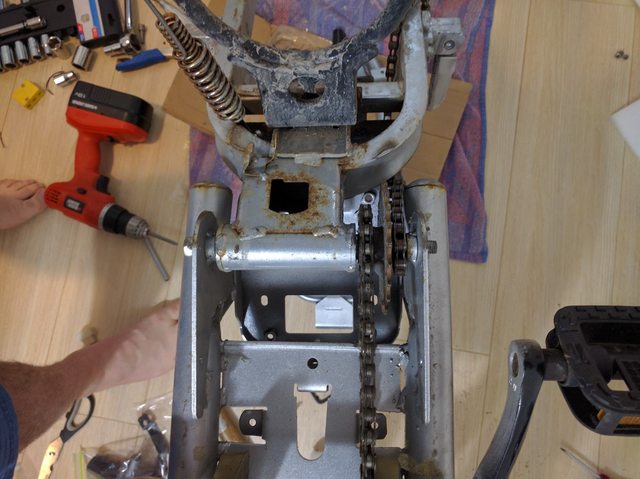

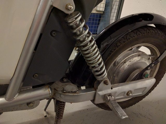

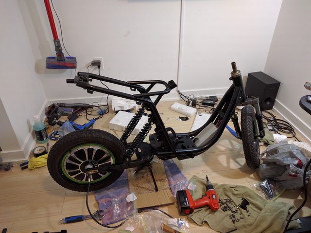

Here is my first project. Bought a cheap crap e-scooter to upgrade Kiwi E-bike (clone of Emmo Urban, Daymak Torino)
Thanks to electricgod and mistercrash for your advice on other threads
https://endless-sphere.com/forums/viewt ... =2&t=79964
https://endless-sphere.com/forums/viewt ... 10&t=79275

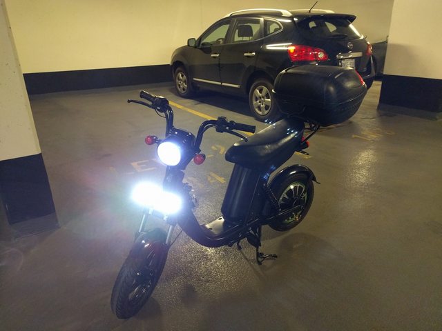

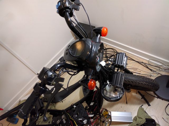

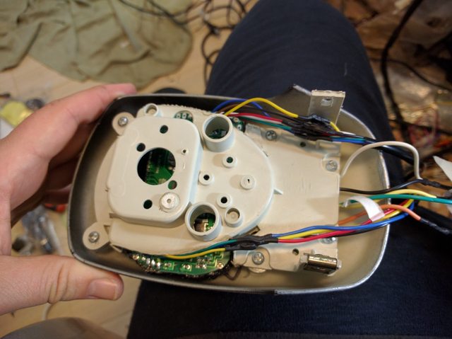

I use this little bike all the time around the city, fastest I've seen going down a hill is 55km/hr. I think the speedo might be off slightly (about 5km/hr difference to GPS) I set it to 16" wheel size. Avg speeds around 40-45km/hr which is fine.

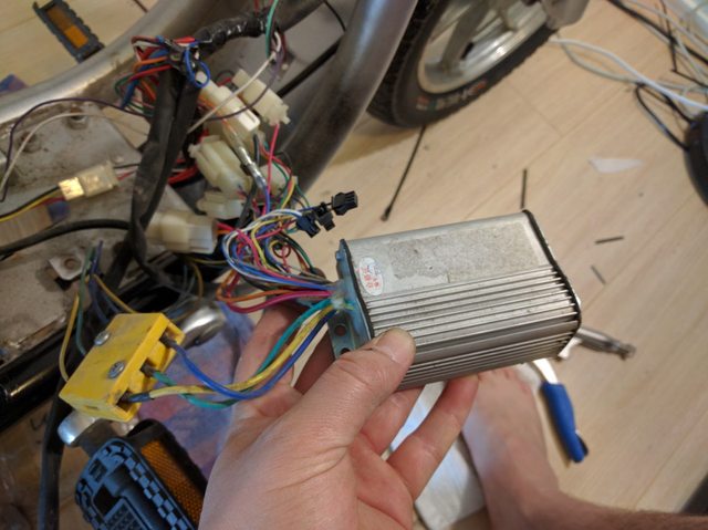

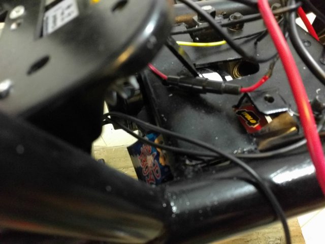

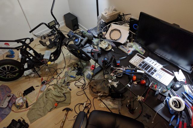

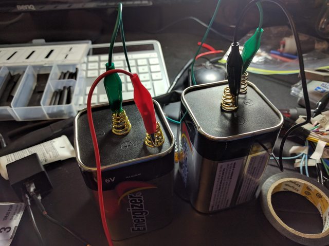

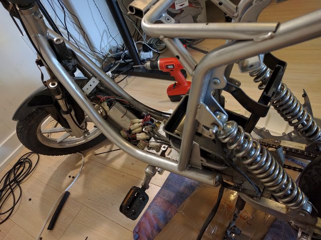

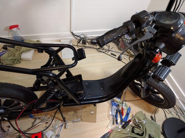

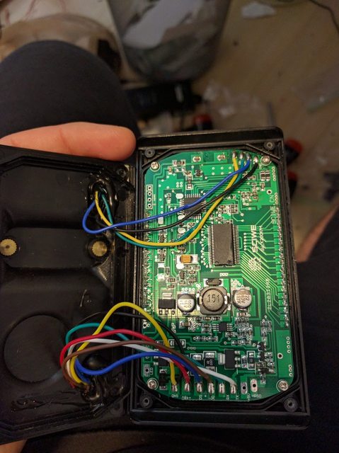

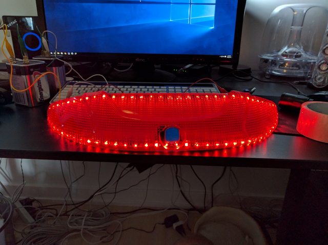

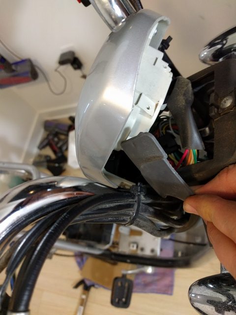

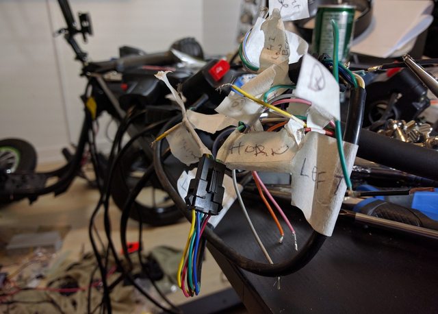

The wiring was the hardest part, I should have left the connectors on and tested and labeled with multimeter continuity. I was a goof hooking up two 6v batteries and a LED blinker light testing circuits.
Now onto more serious project 72v QS 7kw 100a https://endless-sphere.com/forums/viewt ... 10&t=85164

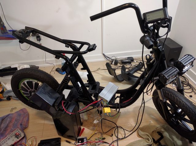

Heres the parts I used
- New hub wheel 1500w rated (3kw peak)
- 45a 48v controller (modified shunt)
- 48v 30ah triangle battery

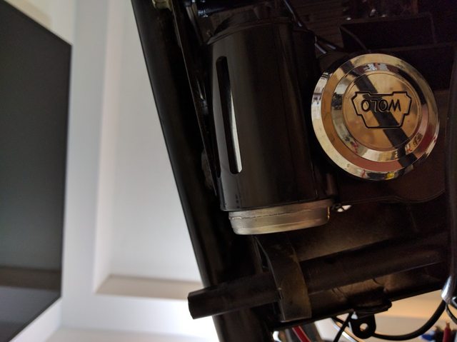

- Wolo 419 Air horn

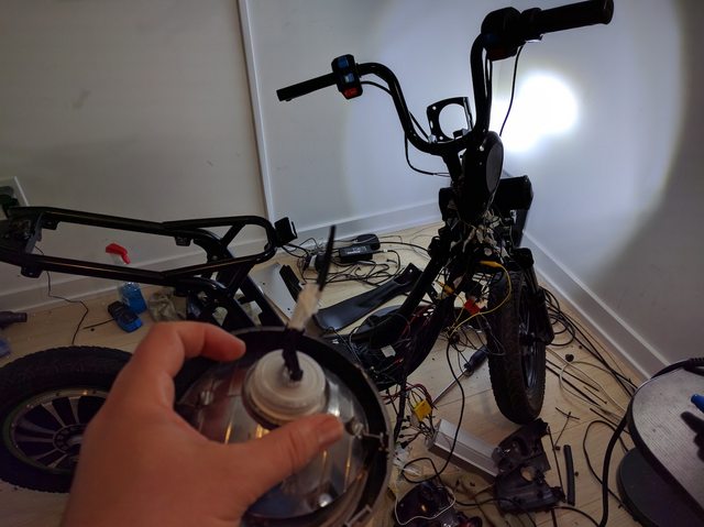

- 2x 18w Front LED lights
- LED strips & indicators, brake light
- 10 AWG battery wire, 45a anderson powerpole connectors

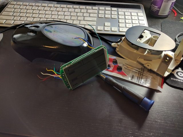

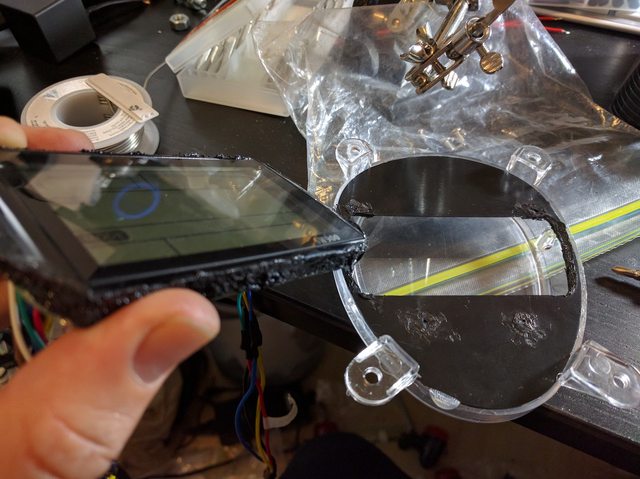

- LCD screen from old ebike aliexpress kit
- Front all light flasher
- Alarm with flashing lights
First project small E-scooter upgrade 3kw 48v 45a https://endless-sphere.com/forums/viewt ... 12&t=86228
Current project medium E-scooter upgrade 8kw 72v 100.5a https://endless-sphere.com/forums/viewt ... 10&t=85164
