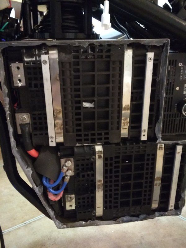

Wow I like 20ah punch cells because they are very powerful but I wonder how can you fit 48 of them into an e bike frame ?
I've tried before and it was impossible!
Which frame do you have ? Do you have any photos ?

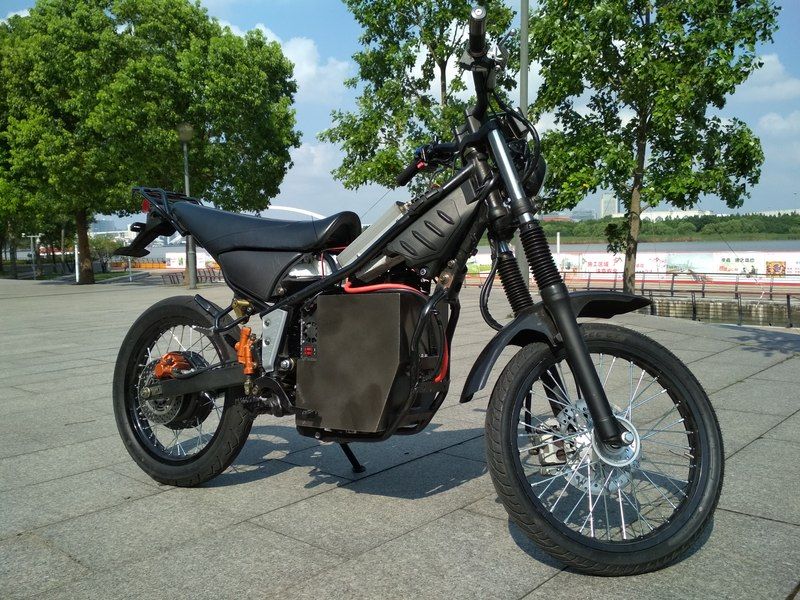

Its not and Ebike, its a Magician 250. Yet, it was'nt easy to fit the battery there!
I'll make a thread with pictures later on, its just a bit of a hassle to do from China that's why I haven't done it yet

Aha I see, lucky you then that you have so much battery space!
I used every bit of it. I will choose a different geometry for my next build to fit a larger battery.

Here are a couple pix showing battery fittment
I always liked that magician 250 enduro but it disappeared from Ebay about a year ago. I also wanted to convert it to road legal electric. Much smaller looking than the hawk model.
Conversion looks good!
