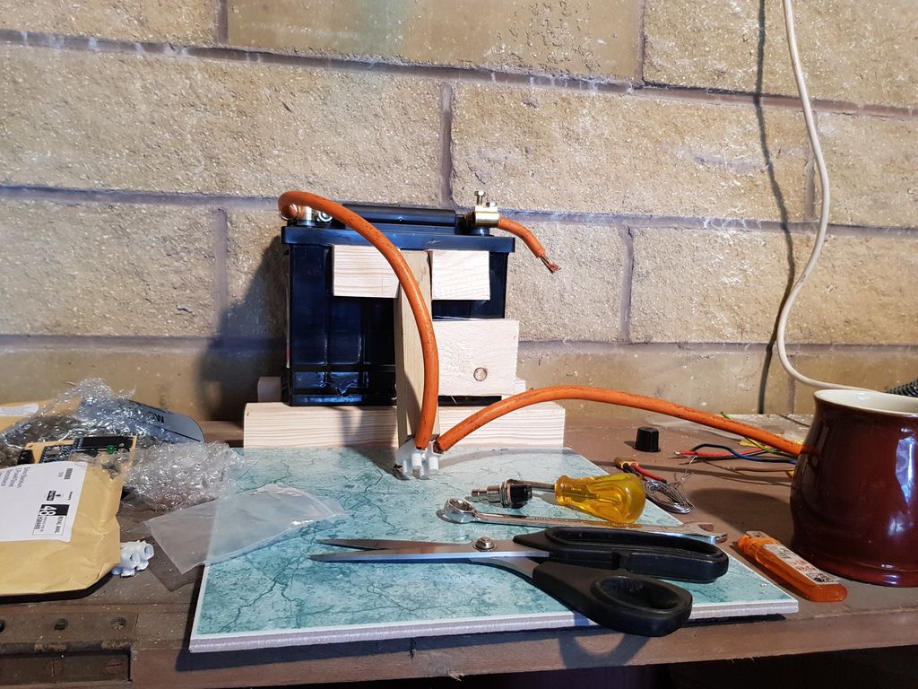

Cal3thousand yes spot welding. Im in the process of makeing one. Updates will be posted here.

Ok my cells and nickel should be here in a few days. Also waiting on my ssr relay to arrive then i can finish my welder
I know people have had varied amounts of success with this style of welder so im aiming to iron out some inconsistencies. Will add a spring to the arm to keep an even pressure on every weld .got the timer. And have the electrodes on a swivel so they can self level.
Needs a bit of a tidy up then im all set for some test welds.
Thoughts?

Nice. Good luck. Keep us inform. Use a gasket on the pos side.
