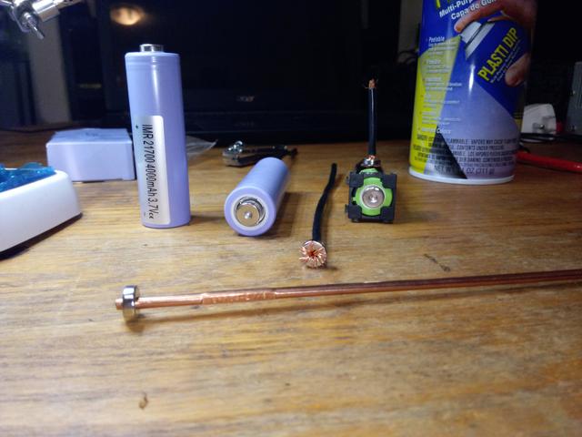

Im getting ready to life cycle a 40T @ 7.5 amp discharge, 5 amp charge 1000? times. I don't have everything I need yet but im going to start playing with what I do today and share. these magnets are 3/8 diameter 1/8 hole, 1/8 thick. I have more magnets coming with 1/16 hole and smaller diameters and thickness
my tester
40T magnets wire
12 gauge/19 strand wire

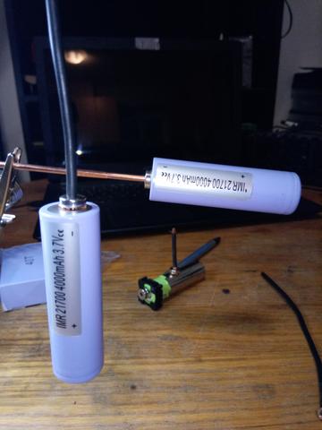

attached magnet to 40T and ready to plasti dip
spraying plasti dip didn't work, the force of the spray got into the air gap between button and magnet but that's ok, im just playing, you can get pourable plasti dip, my plan is copper electrode
with the copper wire you cant hold the battery sideways, it will fall off but with copper electrode you can and you can solder a fuse wire to the electrode. im going to start playing with the tester on the 40T today, ill share more later

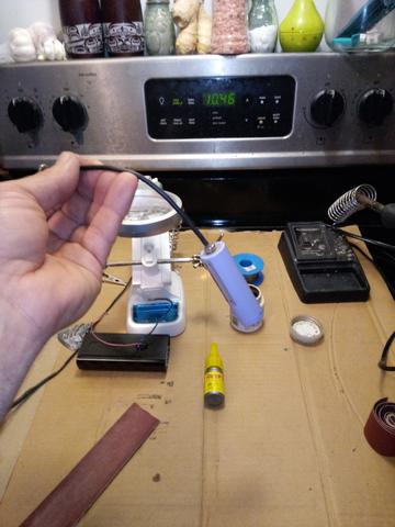

tried soldering the wire into the hole, gave it a scrub on emery cloth. the magnets are nickel/copper/nickel coated and you cant really see it in the picture but that halo around the hole is copper
it worked, sort of. the heat from soldering probably took half the magnetic pull away, battery can still hang from the magnet but I used to be able told the battery horizontally and the wire would stay horizontal but not now, it flops down and hangs at a 90
I guess ill have to glue a copper electrode in the hole

heres the the joint
under uv
I know john talks about a glue, he'll be here soon :D
I just want to start playing with the tester so mickey mouse it for today

I received the N52 magnets I was waiting for
I used 14 gauge copper wire, it was too thick to fit in the hole of the magnet so I stuck the wire in the freezer for 30 minutes to let it contract and then I was able to tap the wire into the magnet.
it has pretty good holding power
if I try to hold the battery any more to level the battery will fall off the magnet
now ill start the test

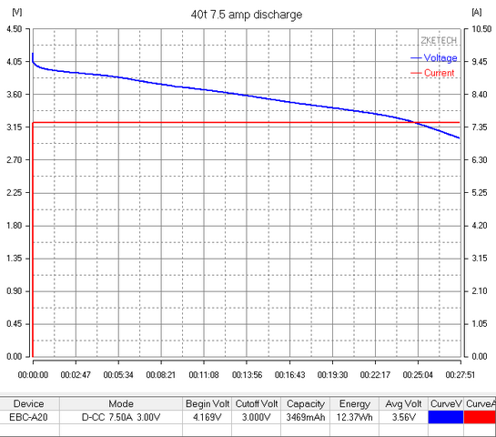

just did the 7.5 amp discharge from 4.1v to 3.0v battery and magnets didn't get hot 35 Celsius and delivered about 3ah. doing the 5 amp charge then ill try to upload the charts before starting the cycle test
goatman   100 MW
Posts: 2883
Joined: Jun 23 2019 6:50pm
Location: Surrey, B.C.
Re: 40T, neodymium magnets, plasti dip cycle test
Post by goatman » May 17 2020 4:33pm
7.5 discharge
5amp charge

I have the tester so at 10 amp continuous 4.1v-3.0v the battery temp hit 108f/42c on the 3/8 magnet 40T with plasti dip

heres the 10 amp discharge with numbers
then started charging at 5amp with 0.5amp cutoff but im going to change the cut off
it was charged in about 45 minutes but the volt dropped to 4.06v
if I do 0.10amp cut off it takes 90 minutes to reach 4.1v and stay
I might try 0.4amp c/o next
