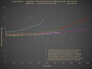

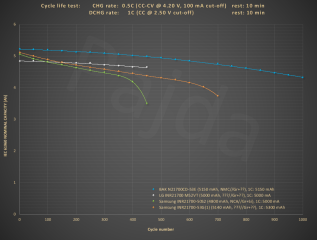

"Standard Power Rate" test (1C continuous discharge)
note: the 1C discharge test is performed at ca 90% DoD (4.15V-3.00V)
Test eqiupment:
- 2pcs ZKETECH EBC-X0510
- BF-2A four-wire cell fixture (10A version with Nickel plated contacts)
- tested in room with relatively stable temperature 23 ±2 °C
Remarks and comments:
- sister thread to the High Power cylindrical cell tests with the same settings Cycle life tests of High Power density cylindrical cells
- the reduction of tested DoD to about 90% (4.15V-3.00V) is based upon requests from the ES community
- from a purely technical point of view, even this small reduction of DoD significantly reduces the differences between high-quality and lower-quality cells.
- it means in practice that almost all cells shows results very similar to each other at 70% DoD or lower (see docware results), but you miss the information that some of high-quality cells perform very well even at 100% DoD (as was shown in 5C @ 100% DoD "torture" test of modern HP cells)
- you will certainly notice the "wawes" in the capacity test at 90% DoD, these are caused by the insertion of a nominal capacity test at 100% DoD. This behaviour is tied with the internal design of HE cells as the HP cells does not shows this effect significantly.
- tester accuracy is 0.2 % ±0.01 A. The stability is relatively good.
- do not much look at the absolute values, particularly at low currents in nominal capacity tests, trends are here important results.

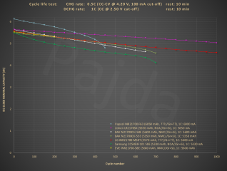

- each 50th cycle is inserted datasheet nominal capacity test with 10s DCIR test (see dots in figure)
- minimal charging CV phase cut-off current is set to 100 mA due to the ZKETECH testers limitation

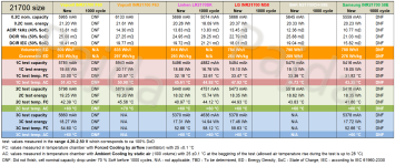

"Table" with values measured on precision battery tester (not ZKETECH). Those test were performed in temperature chamber under 25°C, TC is using forced air flow to maintan consistent temp. This 25°C air flow acts as cooling force on the cell surface, so the measured temperatures under high load will be affected by this.

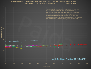

*Temperature is measured by the K-type thermocoupler, attached to the cell body using Kapton tape. Some cells are sold as Naked (without tube) and these shows significantly higher temperatures than cells with tube due to the effect of the tube thermal insulation.

All in One:
HE_1C_cycle_life_test@voltage_drop_new.png HE_1C_cycle_life_test@voltage_drop_1000cycles.png HE_1C_cycle_life_test@temperature_1000cycles.png HE_3C_cycle_life_test@voltage_drop_new.png HE_3C_cycle_life_test@voltage_drop_1000cycles.png HE_3C_cycle_life_test@temperature_new.png HE_3C_cycle_life_test@temperature_1000cycles.png HE_1C_cycle_life_test@DCIR10s rise.png
21700 size
HE_21700_1C_90%DoD_cycle_life_test@capacity.PNG HE_21700_1C_90%DoD_cycle_life_test@DCIR10s.PNG
18650 size
HE_1C_90%DoD_18650_cycle_life_test@table.png HE_18650_1C_90%DoD_cycle_life_test@capacity.PNG HE_18650_1C_90%DoD_cycle_life_test@DCIR10s.PNG

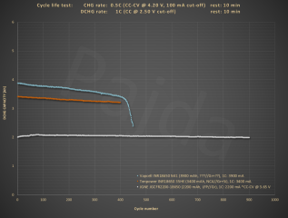

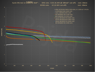

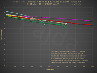

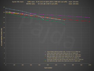

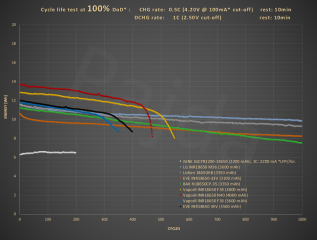

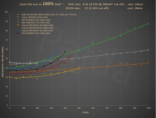

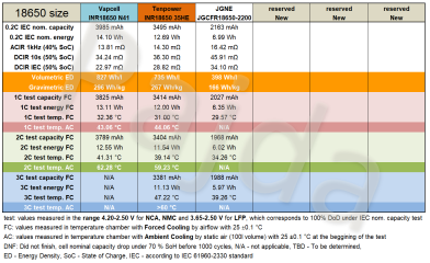

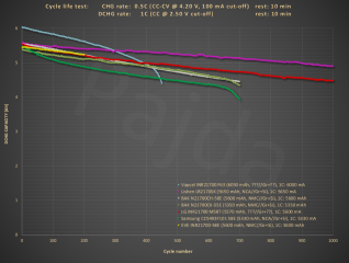

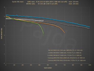

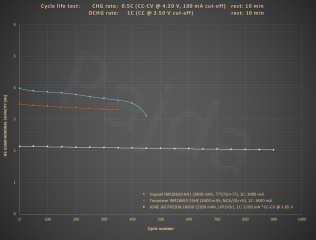

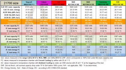

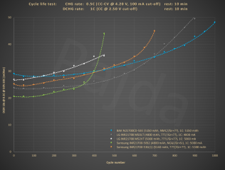

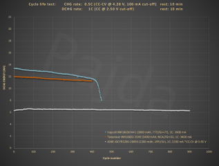

note: the 1C discharge test is performed at 100% DoD (4.20V-2.50V)
Test eqiupment:
- each 50th cycle is inserted datasheet nominal capacity test with 10s DCIR test (not shown in the graphs)
____

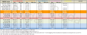

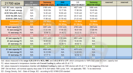

added LG INR18650-M36 to the chart (X0510 tester, cell supplier: NKON)
added EVE INR18650-35V to the chart (X0510 tester, cell supplier: NKON)
added BAK N18650CP-35 to the chart (X0510 tester, cell supplier: NKON)
added Lishen LR1865HB to the chart (X0510 tester, cell supplier: NKON)
added EVE INR18650-33V to the chart (X0510 tester, cell supplier: NKON)
added Vapcell INR18650 F36 to the chart (X0510 tester, cell supplier: Vapcell)
added Vapcell INR18650 F38 to the chart (X0510 tester, cell supplier: Vapcell)
added Vapcell INR18650 N40 to the chart (X0510 tester, cell supplier: xxx)
added Tenpower INR21700 50ME to the chart (X0510 tester, cell supplier: NKON)
added LG INR21700 M58 to the chart (X0510 tester, cell supplier: NKON)
added Vapcell INR21700 F60 to the chart (X0510 tester, cell supplier: Vapcell)
added Samsung INR21700 53G(1) to the chart (X0510 tester, cell supplier: NKON)
21700 size
HE_21700_1C_100%DoD_cycle_life_test@table.PNG HE_21700_1C_100%DoD_cycle_life_test@capacity.PNG HE_21700_1C_100%DoD_cycle_life_test@DCIR10s.PNG
18650 size
HE_18650_1C_100%DoD_cycle_life_test@table_1.PNG HE_18650_1C_100%DoD_cycle_life_test@table_2.PNG
HE_18650_1C_100%DoD_cycle_life_test@capacity.PNG HE_18650_1C_100%DoD_cycle_life_test@DCIR10s.PNG

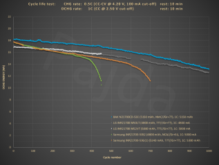

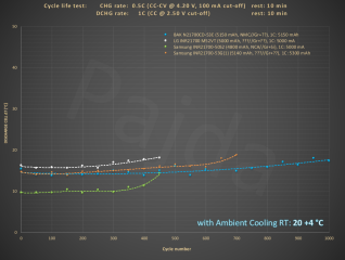

100% DoD vs. 90% DoD comparison (1C continuous discharge)
Test settings: 100% DoD (4.20V-2.50V) vs. 90% DoD (4.15V-3.00V)
Purpose of this test:
- To show the "unexptected" behavior which can be encountered when cycling modern lithium cells at lower DoD than 100 %.
- The generally accepted statement is that lithium batteries do not suffer from so-called "memory effect" (often seen in NiCd/NiMH technology).
=> The practical problem of this effect is an unwanted (but recoverable) loss of capacity/energy of the cell .
- Tricky thing is that some lithium cells show significant "memory effect" and some does not show it at all.
- It seems that this problem is connected with HE cell technology as HP cells does not show it.
=> The way how to recover the lost capacity/energy is to perform single "formatting cycle" which is one full (100 % DoD) charge-discharge cycle (same as with NiCd/NiMH technology)
Test eqiupment:
- ZKETECH EBC-X0510

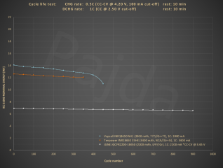

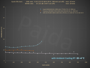

Thanks to Tumich (ES member) I got samples of LGX E78 (78 Ah) pouch cells which are used in several EV platforms. One of them is VW MEB platform, so you can find them in VW ID.x or Škoda Enyaq family vehices (but recently they start to use also prismatic cells from CATL, so it is hard to tell)
The sample of LGX E78 pouch cell have this parameters:
supplier: LG Chem
format: pouch
L: 550 mm (595 mm with unfolded side terminals)
W: 9 mm
H: 98 mm
capacity: 78Ah
nom.volt: 3,65V
cathode: NCM712
weight: 1090g
vol. energy density: 590 Wh/l
grav. energy density: 265 Wh/kg
DCIR 10s (50% SoC): 1.65 mOhm
DCIR IEC (50% SOC): 1.44 mOhm
0.2C nom. capacity (4.20-2.50V): 79.19 Ah
0.2C nom. energy (4.20-2.50V): 290 Wh
1C capacity (4.15-3.00V): 72.39 Ah
1C energy (4.15-3.00V): 254 Wh
Test conditions:
This cell si huge and unfortunately it will not fit in my temperature chamber, so the test below was conducted in room temperature. It must be said that the temperature comparison with other samples is misleading for E78 as it was not "cooled" with 25°C forced air in TC.

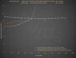

Small update after a while
Panasonic NCR18650T1 (aka Tesla Plaid cell)
- For those who are familiar with Tesla/Panasonic cell performance it is no surprise. Cell shows similar results (capacity fade) as another cells from 18650 line used by Tesla
BAK N18650CP-35
- A cell promising very good price-performance ratio in the 18650 HE category
LG INR21700M50LT
- The prices of this LG cell have recently returned to pre-crisis levels and therefore it returns again to the competition of the best price-performance ratio in the 21700 category. And one remark "L" or "LT" M50 cells shows significantly better cycle life performance than "T" model.
Lishen LR2170SD
- I came across a problem with the used ZKE tester channel and so the values of the nominal capacity test inserted every 50 cycles (dots in the graph) are skewed, but 1C discharge values are not affected. At the end of the test, I will try to correct it based on the initial and final values.

This is fun when working with electrochemical cells that you are never sure in advance of what you will measure. But the fun stops when someone puts a knife to your neck to tell them the essence of the phenomenon. I observed two major phenomena, which I would call the "memory effect" and the "self-healing effect". In addition, these can be tied together.
So called "memory effect" is what you can see in this particular 90% DoD chart. The waves are caused by the insertion of nominal capacity test, but the root cause here is application of full charge voltage 4.20V instead of 4.15V used in the cycle life part of the test. For example if both nominal capacity test and cycle life test will use the same charging voltage, there will be no waves as you can observe in 5C chart. Both C-rate and the discharge voltage limit (DoD) does not have impact on this effect. In this case, I would not talk about the self-healing effect, because the "recovered" energy is still present in cell at that time, it is only not used. And of course no generalization, you can see that LG M50LT does not show this effect at all.
So called "self-healing effect" can be described as after prolonged period of the time you can measure significantly higher energy, particularly at higher C-rates (recovery of DCIR) than that was available after finishing the use of the cell. This phenomenon is mostly talked about in connection with Tesla/Panasonic NCA cells.
Ah, thanks, I missed that. Explains why the memory effect is so much more pronounced with some of the cells here vs not present on your high power tests. A good reminder for me not to directly compare charts without care.
OK, funny, first thing I wanted to do is ask a question about generalized behavior on the self-healing effect, but I get it more now, it's not possible to generalize this nuanced behavior between different cells and possibly even generations of cells. Well let me put it a different way if you can answer--
Is it fair to say that the memory effect only creates a temporary wave or capacity gain and doesn't effect the slope of the capacity degradation curve of a bench-tested cell OR does it actually contribute to slowing the capacity degradation curve to some small degree in these type of tests? In other words, does the memory effect matter in the long run for slowing capacity degradation as a kind of technique or can it be ignored then?
Ah, I initially thought that every 50th cycle you had a 24-hour break or so in which these comparatively less abused cells (vs 5C test) were experiencing some measure of "self-healing", but moving forward with the understanding that the HE_1C_cycle_life_test@capacity chart is only demonstrating the memory effect, for cells that can experience self-healing then, what kind of time-frame are we talking then for this behavior to manifest noticeably from what you've seen? Days, weeks, months?

Samsung INR21700-50S
- Nkon few weeks ago listed them in their store. I was able to order samples from there before they went out of stock. This cell is interesting in terms of representing the "best energy-power performance ratio on the market" (at least until the LG H50 will be widely available), but its price is completely out of the question. Previous 50S samples coming from Vapcell show significant cycle life problems even at lower 1C rate at 100% DoD. Lets see if there will be any significant change at 90% DoD.
I also found Lishen LR1865HB 3350mAh newly listed on Nkon store. But right now when the LG cell prices (M36) are stabilising it is not as interesting competitor. But still will try to add it to the chart.
bmwupgrade said:
Have you tested 50s? Have photo? Expect them to have it at gen2 now
I recently moved actually running 50S test results from this HE chart to the HP one in the second ES thread. The tested "green tube" sample comes from NKON (you can find photos here) and it seems to be Gen1. I found some pictures of 50S also in a purple tube.
Lishen 18650HB (3350 mAh) and EVE INR18650-33V (3100 mAh), both samples from Nkon added to the test this week.
Finally, I have back access to my Temperature Chamber, so I would add other test results within a week.
