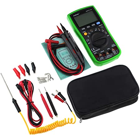

This is the one i used and it served its purpose. After checking all 200 cells you hopefully will find that you really didn't need to check them. What you need is a DMM that reads to 3 decimal places for checking the millivoltage of each of the 'new' cells as hopefully they shouldn't vary by more than 3 mV from one another (5mV at most) assuming all cells are from the same manufacturing run (for example 3.400V ± 0.005V) ...
azechimp AN870 19999 Counts True-RMS Auto Range Digital Multimeter Volt Amp Ohm Meter

You don't need to buy that azechimp AN870 Digital Multimeter if the benchmark norm for those 210 new Molicel P42a 2170 cells is a variance of one hundredth of a volt "or so" as acceptable. It won't take you all that long to check all 210 cells, if you are so inclined to do so with your DMM.

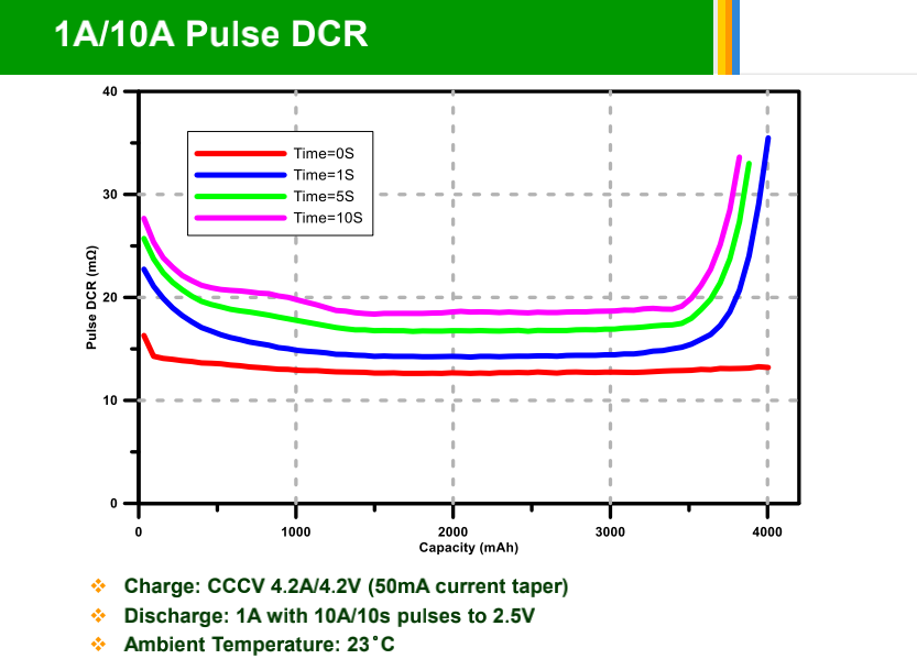

The following P42A IR Test Chart should provide some help when rating all 210 cells with the YR1030 IR Tester. After all is said and done you'll hopefully find that all 210 cells are **acceptable**. IF say 10-15% of the cells test closer to 25mΩ than 20mΩ, (or better yet closer to 15mΩ), you may still decide to rate them as **borderline acceptable** or if in doubt build a DIY 20S9P battery pack instead of a 20S10P. Hopefully (ideally) all 210 "new" cells will test closer to 15mΩ than 20mΩ.
Depending on how "new" the cells and storage conditions over half could test closer to 25mΩ, but hopefully closer to 20mΩ (or better yet closer to 15mΩ). Never-the-less attempt to arrange the cells so that each 20S parallel group has the same IR ... which you can also verify (measure) with your YR1030 before, but more importantly after spot-welding.
