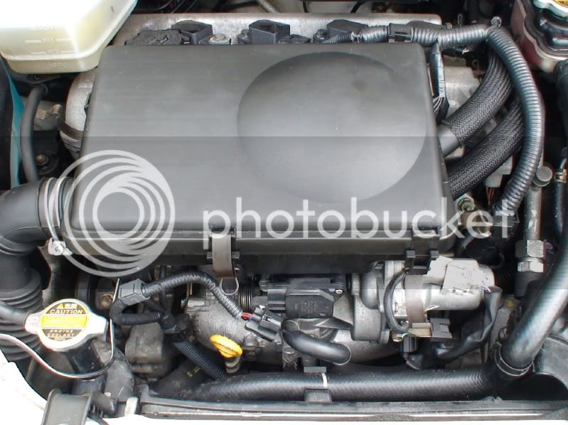

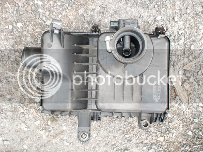

The Prius NHW10 (MK1) MAF Sensor (Mass Air Flow) is sometimes the cause of baffling performance problems of the entire hybrid system.
If the MAF sensor is too dirty, it measures the amount of air entering the ICE incorrectly, causing poor combustion, poor power, high emissions, and over-use of the electric motor and HV battery to compensate for the loss of power. Soon this may look like a battery problem, when the actual problem is the lack of power generated by the ICE.
The MAF sensor is located on the air filter housing and can be unscrewed by loosening two Phillipshead screws. These are a bit hard to get to, the first time I used an angled screwdriver.

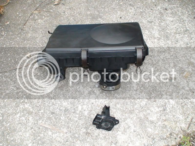

I found it is much easier to remove the entire air filter housing. That also allows inspection and cleaning of the "Butterfly Valve" underneath the air filter.
A few hose clamps and other screws are easily removed to take the whole air filter out. Much easier than removing the MAF sensor when the air filter is still attached to the car. The electrical connector comes off easily if pushed the right way...:
The lower one of the two Phillipshead screws is difficult to remove if the air filter is still mounted to the engine:
The underside of the air filter:
The air filter - old and new - inside the filter housing:

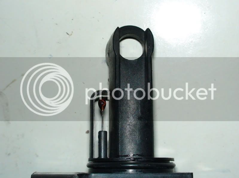

MAF Sensor removed from air filter:

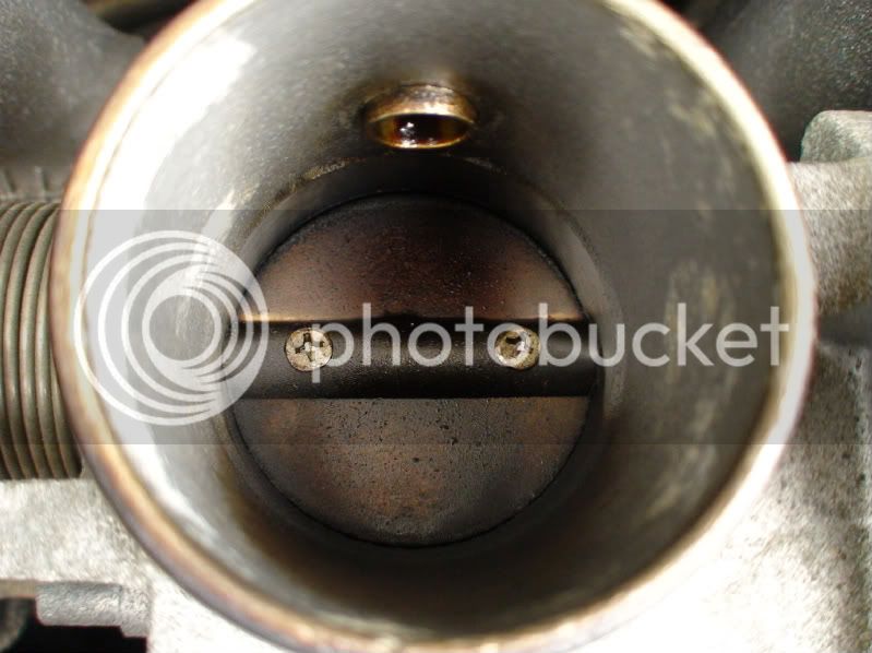

Butterfly valve before cleaning

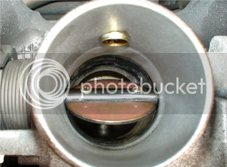

And after cleaning:

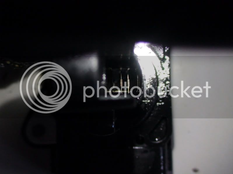

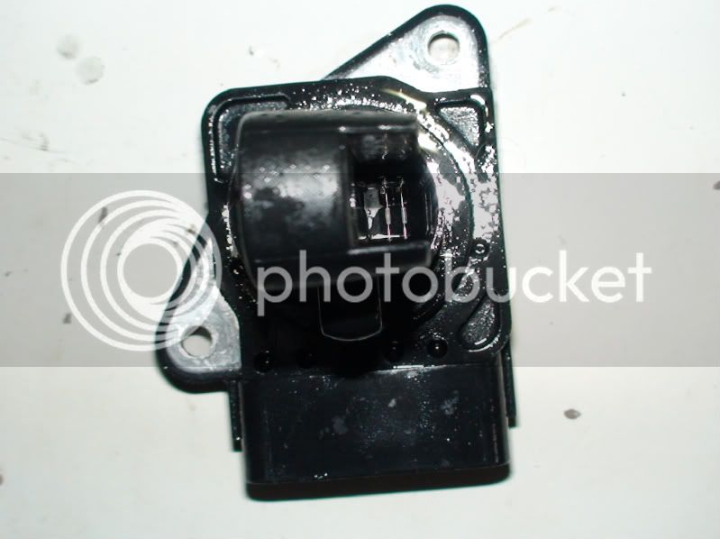

There are three different parts in the MAF sensor that need to be cleaned for normal performance. A temperature sensor on the outside, and two sensor wires deep inside the MAF sensor housing. These two are often overlooked and only the temp sensor is cleaned. But all three need to be clean!
The delicate sensor wires can quite easily be destroyed and it is expensive to replace the MAF sensor!
An artists brush can be used to gently wash the wires, using contact cleaner or other solvents. I'm quite certain you can also destroy the wires by pushing the artists brush in with a little bit of force!
Before cleaning:
Still wet from the solvent:
