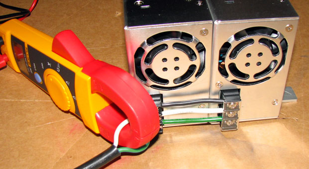

Meanwell HRP-600
Pals and compatriots –
I received two units of this series yesterday; the 24 and 48V versions. Tonight I had the opportunity to hook these devices up and review them.
I wish to chronicle the timeline here rather than in the review mainly because I had already provided a similar timeline for the SP/S assembly. Some information may be repeated here from the review.
Disclaimer: These HRP-600 units when combined in series still create a 63-84V charging assembly, therefore qualify as worthy of discussion under this here thread <nods>.
  • HRP-600 24 + 48 = 63.3V PSU. No Load = 0.20A @ 121.1 VAC
  • HRP-600-48: Tested Range = 39.1 to 58.2 VDC. Set to 39.1.
  • HRP-600-24: Tested Range = 20.6 to 30.49 VDC. Set to 24.2.
  • After assembly into series, fine tuning was required to reach 63.3 V. No Load now = 0.18A @ 120.8 VAC
Amp meter connected to VAC.
Charging:
At 9:00 PM sharp, 15S6P LiPo pack was at 58.0V. No mods were made to the HRP units; they were assembled and put to use right out of the box (sans voltage adjustments). The charger was put on the pack, the voltage jumped to 58.8V (monitoring per CA), assembly current goes to 8.1A @ 118.8 VAC. Fans take off loudly relative to the SP/S assembly. For the first brief minute there was some strange whining, and possibly buzzing, but it went away. The first ½ hour was loud – however the pack was most definitely charging! I moved the amp meter around a bit and received a better reading; it was actually pulling 8.7A. The charging cable was 14 AWG that I had lying around; I thought it would make for a good experiment to see how it handled the current: It became very warm but not hot. Note to self: Use 10 AWG for in the field.
After about ½ hour as the pack voltage reached 62.8 VDC (with the charge still on) the assembly was pulling 9 Amps; I noted this figure was slowly climbing as charging progressed, though I do not know why. Back-calculating, the assembly is using about 1 kW of power which is about double the SP/S assembly. The power usage is better than I had hoped, and not at double the maximum limit for both units. The 48V unit was definitely warmer than the 24V unit in one spot where the heat sink must have been, although it was by no means hot. Except for the fan noise, the process is going smoothly.
At 9:35 PM there is a marked change as the pack hits 62.9V! The fans begin to quaver and downwind off the full speed, although it is still quite loud. The current begins to drop off at a linear rate below 9A, then 8A…
At 9:42 PM the fans make a dramatic change in speed and drop to about 30%; it’s well above a whisper though welcomed nonetheless. The assembly current is now dropping below 5A.
At 9:51 PM the fans stop! The CA says the battery pack is at 63.4V, with the assembly current down to 2.75A. I elect to disconnect the charger; doing so the pack voltage drops to 63.1V and the assembly current goes to a no load state – drawing 0.19A. I decide to reconnect the charger and wait out to see what happens if we leave it alone. The pack is essentially charged at this point, less than one hour which is truly quite impressive.
About 10:25 PM I check the pack and the CA says it’s 63.5V. The assembly current is now pulling less than 0.5A and still dropping. Pulled the plug to check the real pack voltage – and it’s 63.5V! Shite I’ve never taken my pack this high before, however a quick calculation says the cell average is about 4.233 V so I shall not worry; we are done. :mrgreen:
I wish to conclude that this HRP series is most excellent for charging LiPos. The caveat, as I stated in the review is that we need to monitor when the assembly goes into trickle mode so we can pull the plug. By this estimate, I expect my charging times will be reduced by at least 50%. I am most pleased.
Maybe next year I’ll upgrade to the HRP-1000. Whatcha think? :twisted:
Huntin’ fer a Pepsi machine, KF

Did you measure output current at all?
It is the current going in to the pack I am concerned with rather than what the charge assembly is taking from the mains. To me, that figure is immaterial, I want to know the charge current relative to pack capacity and C rating
:) Only Irish coffee provides in a glass all four essential food groups: alcohol, caffeine, sugar, and fat :)

Neil: Output current = No; based on the VAC usage it could never be more than 1 kW, though I suspect it was at least 600W. My pack is 15S6P Zippy FlightMax, each brick rated at 15/2C and 5000mAh. It can handle it. The Amp Meter that I use for some reason will not measure DC amps, which I admit is odd. If you know of a device that can do it, I’m all ears friend :)
An educated guess, based upon the efficiency of the series (88-89%) suggests it could have been 955W. Given that the pack went from 58.0V to 63.1V in 51 minutes has me to believe the efficiency is valid. I checked the pack this morning and it is still holding at 63.5V.
Db: I listed the supplier in the Review. Though here it is again my friend: Power Supply Emporium. They had the most competitive pricing stateside and didn’t waste time processing; it was shipped out right away.
I did look at other models though once we step outside the SP/S world things become quite a bit more expensive which encourages shopping around. BTW – yesterday (a day after receiving the PSUs) I received a really well-produced thick catalog from PSE loaded with spec sheets of Meanwell and other manufacturers. This is one is for the library, or coffee table depending on your creature comforts 8)
Pepsi machine reference: If you read my thread on Going to California 2010 (in my sig), the first day I ran out of power after facing a stiff headwind about a mile outside my first town. There was a supermarket at the edge, so I headed there and immediately began hunting down the AC outlets. Found a Pepsi machine and plugged in next to it. I was there for 90 minutes and yet only gained enough power from the gimpy (and with the debased mod) SP/S charging assembly to pick up another 20 miles where I had to repeat the process at a stop-&-go type gas station. Thus developed the initial angst to address this pesky and (IMM) flawed assembly :evil: ~ grrrr & double-grrrr!
I think that today, we have done that. Honestly, I can’t gush enough how pleased I am: The HRP-600 does it correctly right out of the box!
Cheers, KF
PS - Don't take my word for it: Please experiment with other models! :)

Kingfish wrote: The Amp Meter that I use for some reason will not measure DC amps, which I admit is odd. If you know of a device that can do it, I’m all ears friend :)
All the cheap DVM's I have ever owned can measure DC amps, usually up to 10 amps..some 20...even the cheap $0.99 e-vbay ones from China do 10 amps DC.
As far as I was aware the wattage rating of these units is based on their outputs, so a 48 volt unit supplying 10 amps would be a 480Watt supplyat that rate it may be drawing 500 Watts from the mains, it may be drawing 600 and be very efficient...but irrelevant, I want to know what current is flowing into my pack...if I have a 5Ah pack and I want to charge it at 2C, i want to see 10 amps on my meter, not faff around with the supply input power, work out charger efficiency PFC to find out what current goes in to my pack. Rather like going to the fuel pumps with your car and measuring how much power it takes to pump the petrol to the car, then finding out the specs of the pump to work out how much fuel you put in the car...yes possible...but very long winded

There are DC clamp meters as well, they are just more expensive (well the accurate ones are anyway).

The meter I have now is a Fluke Corporation 322 AC Clamp Meter; it does not measure DC current - although I thought it did when I bought it. Sadly a decent DC clamp meter begins around $330 USD; 3X the cost of my 322-unit. It's not a hi-pri right now. I am happy as a clam with what I've got; it charges fast. Neil, yer on yer own to figure it out with the data that I've provided :wink:

Kingfish wrote:The meter I have now is a Fluke Corporation 322 AC Clamp Meter; it does not measure DC current - although I thought it did when I bought it. Sadly a decent DC clamp meter begins around $330 USD; 3X the cost of my 322-unit. It's not a hi-pri right now.
Well invest $0.99 on ebay and th cost of a battery and you'll have your self a usable DC meter//although not Clamp on, for less than $5
Kingfish wrote:color=#400080]Neil[/color], yer on yer own to figure it out with the data that I've provided :wink:
Well for my needs I do not need to, just thought that if you were doing that ( measuring DC amps) then it would have been easier for you in the earlier experiments to balance the parallel set of Meanwells. I happily charge at 9 amp and 83 volt from my pair of S-350-48's and have no need for a bigger charger. it would have been interesting to see the figures if you had them, but that is all :lol:
