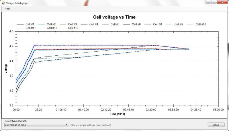

Is your final target voltage set to 4.15v because your cell voltages seem to be dropping down away from it.
I'm not sure why your cell voltages are not increasing toward the final target voltage (4.2v) like mine do.
Here's a typical balance session of one of my more unbalanced packs.
Note that the highest cell voltage is held at 4.2v while the other cells are charged up toward it.

Okay I think I see... you stopped the charge mode session, then started a balance mode session.
The balance mode session doen't try to get the cells toward 4.15v. I think it only tries to get the cell
voltages closer together.
I wonder if you started another charge mode session, would the cells votages go up toward 4.15v?
(although I'm not sure why it didn't do this in the 1st charge mode session to begin with)

This is a sign of a bad pack. One cell has low capacity, so it charges up early and then puts the charger into a crawling balance mode. The charger cannot allow that one cell to go above 4.15V so it must charge the other cells at a low rate. Probably should weed out the low capacity cell, perhaps get it balanced and see if the same thing happens each cycle.
I also wonder if it would be better to use 4.2V for this, at least for a few cycles to see if it improves.

@cwah
It does look like your #2 cell is getting to 4.15v first and putting the charger in balance mode. AlanB might be right that cell could be weak. You could verify if it is a weak cell by setting the discharge voltage to 3.6v the Hyperion 1420i and running a discharge cycle on your pack. (It will be considerably longer to discharge because the 1420i has a built-in discharge load that's pretty wimpy for discharging our relatively "huge" ebike packs). But take a look at the graph of the discharge cycle and see if that voltage in cell 2 drops noticably quicker than the other cells. If it does then you'll know for sure it's a weak cell and you might have to consider replacing it. Also, scroll thru the stats of that discharge cycle and take notice of the Amp-Hours expended and see if it's reasonable to the size of your pack (I believe you said your pack was 8Ah right?)
But honestly, on the first graph you posted of your pack charging, that cell 2 did not look like it shot up to 4.15v way faster than the other cells . Also, you're only looking at about a 20 milivolts gap (that's 0.02v) as your greatest difference between that cell 2 and the rest of the cells. To me it didn't look that bad and didn't look like the cell was weak. Looks more like an inconsistency in materials (chemical mix) or manufacturing between the individual cells.
One of my LiPo packs that I've used almost 2 years looks like that and actually has about a 35 milivolt gap when charged. I'm still getting a useable 8.9Ah on that 10Ah pack so I'm still using it and just keeping an eye on it.

I did the test 2 weeks ago on this pack:
From 4V to 3.65V I have about 5.35 AH available on the pack. My other pack has about 5.6 AH available for the same setting. It does seem like a weaker cell when you look at the red one.
