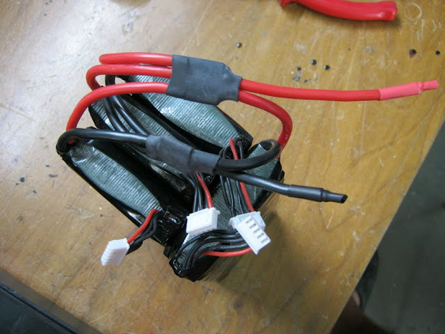

Homemade packs are working nicely.
I've gone about 1000 miles, using just my 25.9v recycled Lipo, in EZip, pack.
I've been using my Li-ion builds, for the past 3 years, thought I should concentrate on testing the Lipo.
My first Lipo builds were built from the "defective" packs, the ones that would not properly charge in the 4 bay laptop, bulk, charger.
25.9v.
The good news?
I have 200+ "good" packs, that fully charge, and more importantly, maintain 80% charge after sitting for 3 months!
(4 of 5 capacity meter leds)
4-5 kWhs of SONY cells (only tested at 11.1v 21.6ah, with 110v AC inverter, then replacing 2 - 6v cells in 12V florescent lantern.)
7-8 kWhs of unlabeled cells
No where near as cheap as Li-ion, but typically in much better condition, (Higher percentage of 100% usable)
For my ebike packs, I leave the individual cell fuses.
For my 18v B&D (Black & Decker) Power tool pack upgrades, I will bypass the built in fuses.
Of course I will closely monitor, as I apply maximum demand, during durability testing.
I'm guessing the 8" chainsaw should demonstrate the highest demand.
Testing will use an amp meter between the tool and an external pack, (temperature monitored , of course!)

Cell capacity-condition easy "quick check" ...
After evaluating hundreds & hundreds of cells, I noticed that the best cells were the ones with the "best" bleed down profiles.
Typically I charged all cells to a 4.2v resting voltage.
With a quick charger, the finish voltage must be slightly higher to attain this "resting" voltage.
My standard procedure was to confirm 4.2v, after 1 hour removal from charger.
Then ...
Voltage, of each cell is tested, and recorded at 24 hour intervals.
1 week of testing gives a very good cell evaluation, I use this method to compare cells of same manufacture and capacity.
Initial voltage drop seems to give a good indicator of capacity-condition.
This method seems fairly reliable for Li-ion, as well as for Lipo.
I have used this "yardstick" method to match cells for my larger pack builds, (84 - 120 cell packs), with good success.
Taking this method, to the next level, I intend to do my future cell matching, using a preliminary cell voltage of 4.25v.
While towards the high end of acceptable charge, daily "bleed down", should earmark the very best cells, (The ones closest to brand new condition), indicated by the 1st 24 hour voltage drop.
Typically I try to parallel together a dozen cells, or more, then "gang charge" to specified voltage, before separation and testing.
Oh! It is important to have a digital voltage meter ... capable of measuring 1/100ths volt!
Stay tuned for my 44 Magnum!
The Lipo packs I recycle, are nicely built in 3S, 11.1v, "bricks".
It has been bothersome adding 1S, to build 7S 25.9V and 10S 37V packs.
Fortunately, a 12S 44.4V pack charges nicely to 50.4V.
The 48V controllers, I've been eying, have low voltage cutoffs of 41V & 42V ...
41V / 12S =3.4V
42V / 12S = 3.5V, which is my personally recommended, optimal DOD (Depth Of Discharge)!
Update: Optimal DOD revised to 3.7+V (Li-ion - LiCo 18650 cells)
3.5V per cell, low voltage cut-off, should work nicely for 3.7+V minimum, actual, discharge. ("Voltage sag" under throttle.)
Test pack will use 2160mah cells, in a 12S 10P configuration. (.96kWh)
44.4V - 21.6ah
Which can be easily paired with Twin Sister Pack for 1.92kWh pack.
44.4V - 43.2ah
Yeah ... I stocked up on cells!
Initial charging will be done with multiple iMax B6 as 22.2V sub-packs,
or ... slower ... 22.2V dual charging from single charger.

Here are a couple of battery packs I've made recently. They are 14s 5000mah Turnigy 20c lipo contained in a 150mm x 150mm x 75mm enclosure. They fit very well. I have soldered a harness so that 2 x 7s jst-xh plugs are available from the outside for balancing on my hyperion charger. So gives me a total of ~55V 10Ah.
Finished pack. Contains two 3s and two 4s packs.
Unfinished pack. Contains four 3s packs and is missing a 2s pack (its in the post)
With the Cell Logs connected.

I must say, that looks super-neat!

Yes I very happy with the way they turned out. The batteries fit very nicely inside the boxes. I had 15s in there initially but went back to 14s for my charger. They are just general electrical termination boxes from B & R:
http://www.brenclosures.com.au/pj.htm
They were about $15 each from a local electrical supplier. Can probably find them cheaper online somewhere.
Probably should have just made two 7s 10Ah packs but they were not made at the same time. But overall very happy!
Improvements: Need to think of someway to mount the cell logs better, possibly add an LVC alarm output and maybe a temp sensor.

DrkAngel wrote: Stay tuned for my 44 Magnum!
41V / 12S =3.4V
Update: Optimal DOD revised to 3.7V+ (Li-ion - LiCo 18650 cells)
3.5V per cell, low voltage cut-off, should work nicely for 3.7V+ minimum, actual, discharge. ("Voltage sag" under throttle.)
44.4V - 21.6ah
44.4V - 43.2ah
mAh per 100th Volt graph, prompted revision to 3.6V maximum DOD! (18650 LiCo cells)
