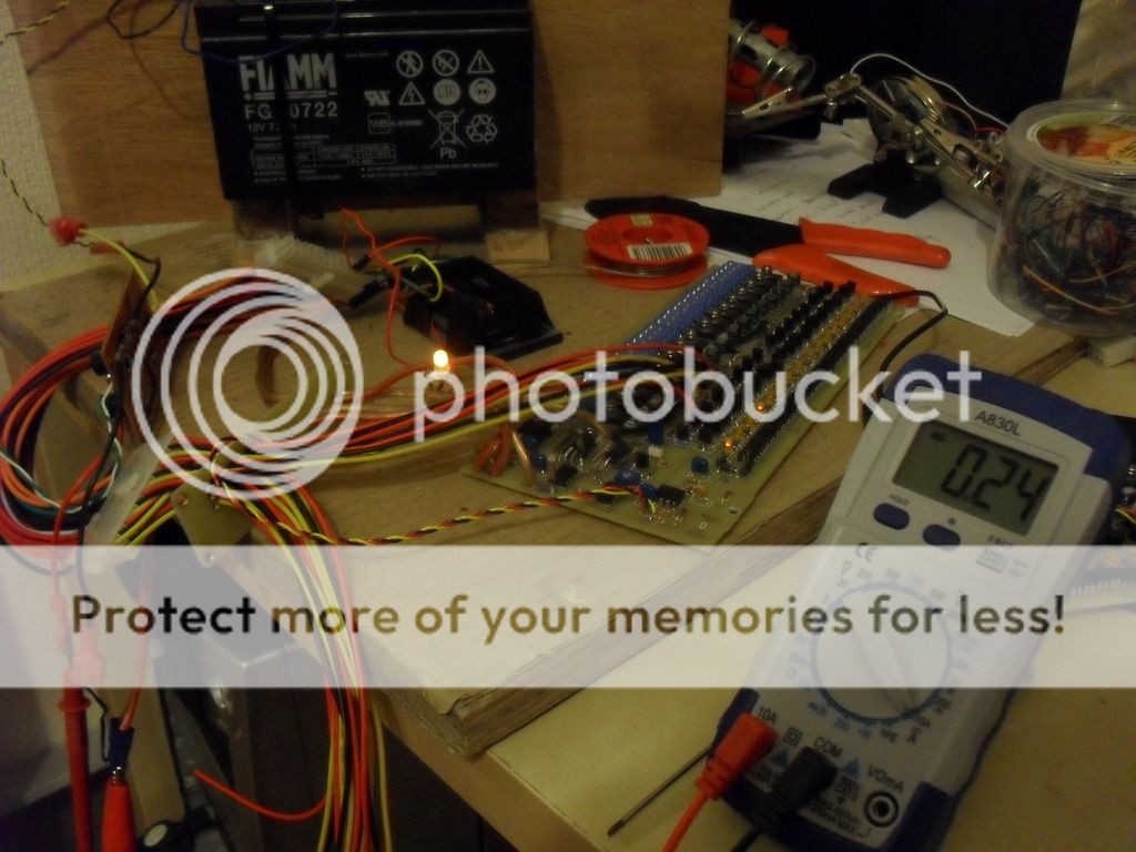

When Gary tried to explain his new-fangled 'shunt by exception' hooey, I thought he'd slipped a gear or two. ;) I didn't expect it to make much difference in performance - and to prove it I threw some really ugly imbalanced packs at the channels. Things like a 4S PSI pack with one cell fully charged and three cells 1Ah down. Or a 4S PSI pack with three cells full and one 2Ah down. And my 21S scooter pack with the PakTrakr feeding off 9 of the 21 cells and it's 'balanced once a quarter' condition.
And the damn thing worked. The high cells hit the shunt LED, then the shunt as voltage rose and the channel started making heat. And then the HVC tripped and the circuit started to cycle away while the low cells caught up. Once the cells got somewhat close, the HVC stopped tripping and the 1A shunts kept the high cells under control. Once things got late into the CV stage of charging, the shunts cooled down and only the LEDs were lit.
But just because the shunts have two layers of protection doesn't mean they need it. I've been running the V4.1.5 channels since last summer some time (after stealing the harness from...er...retiring my faithful V2.3 BMS) and it's had rough duty. The channels were working well early on but the charge controllers? Not so much...and it shows...
I've had to resolder some of the shunt resistors (and have had to protect my motorcycle with a piece of fibreglass...) but haven't had to swap a single part on the channels.
Chargers... The V2 units were designed for lead-acid and other 'dumb' chargers and power supplies - and they worked really well with those power sources. They would also work with some 'smart' or 'too-smart' chargers, but not all, and not without some tweaking. Two of the reasons I retired my V2.3 unit is that it wouldn't throttle my Thunder Sky charger - and my ElCon really gave it fits.
But I saw something Wednesday night I'd not yet seen - the V4.3.5 mod c (seriously!) auto-starts when the Thunder Sky charger starts, does its job as the TS charger works through it's computerized charge profile, waits for the charger to finish and shut down, and the automatically turns off.
Folks in a number of threads ask how to have 'plug in and walk away' charging. Here it is. :D

Yes, Andy's poor v4.1.5 boards have taken quite a lot of abuse, while we sorted out all the different charge control schemes. :)
Once we switched to 1A shunts, that's when all the fun started. We had two major problem areas heat dissipation and unwanted oscillations from excessive noise. For the former, we had all sorts of schemes for controlling fans, but I was never happy with this approach. Once I got my head around the "by exception" idea, the heat problems more or less went away. Now, a proper heatsink is all that is needed. What seems to work best for me is to mount the shunt resistors on the bottom, and then silicon glue a 3/16" bar across them and then slide the board into the Hammond box with the bar making thermal contact with the case.

This is how the board looks of one wants to use one of Gary's earlier heatsink techniques. I used it very successfully with a 'scooter BMS' product that's still in the field. It works well with the hotter-running 'old style' shunts so is more than up to the task for this new 'exception' shunt method.
The resistor spacer is a repurposed slice of V2.6c BMS. (Yes Amberwolf, you're rubbing off!)
It's very easy to install the resistors with a spacer, and there's enough case contact for positive heat transfer.
And it's much easier installing all the LEDs flat on the board than trying to space them to fit thru holes in the lid. :)
