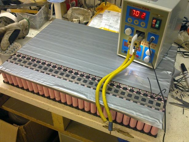

Just want to add to the previous information with a real world example to minimize voltage sag of otherwise saggy cells.
Below is the battery in my cargobike, and the cells are crap for high discharge applications.
But put enough cells in there and each cell will have an easier job for a specific power output, and it becomes a low discharge application.
In this case, the battery only need to put out 0,2-0,5C for enough performance.
This also means I typically ride 5-6hours on a single charge. The drawback is ofcourse the weight.
Which is less of a drawback on a cargobike. The main reason for this compromise, is to be able to use cheap cells and still get decent energy density + life expectancy.
This does in turn give the required distance between charges and removes range anxiety.
The cell being used is the LG D1. 3000mAh 4,35V capable cell.
I charge the cells to between 4,15V and 4,2V depending on occasion and expect to have around 2500mAh if fully discharging (down to 3,0V).
This still equals 4kWh+ of energy.
Today there are more cheap cell options than 3years ago!

Nice battery Wheazel. So the trick is to increase the number parallel of packs to get the max discharge of each cell down so that sag is negated. For lipos this appears the max discharge should be < 1/3 their c rating. I don't know if that's the same for 18650's etc.

That is generally correct, but as others have said earlier, the voltage sag will not disappear, it will just become smaller.
Just like when you are hunting efficiency in any system, you will never reach 100%.
If you parallel enough cells, something else becomes the bottle neck. (maybe the main cabling, or connections inside the battery for example)
I see 18650 cells as better manufactured, better qualitycontrolled lithium cells, more skewed towards the energy density direction compared to rc lipo.
With todays lithium technonlogy, there is always a compromise between energy density and charge/discharge capabilities (very much simplified).
It is no coincidence that high drain 18650s generally have lower capacities. The same applies to rc lipo. Look at the multistar cells compared to 50C rated cells.
Therefore it is just as important to choose the right cell characteristics depending on application.
