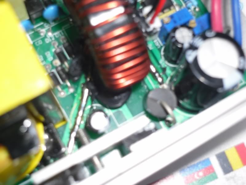

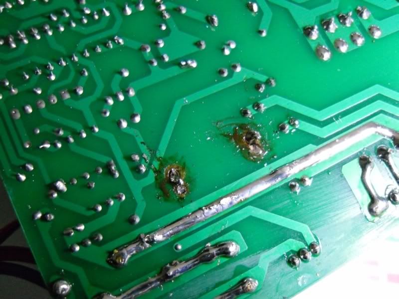

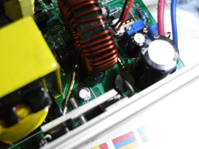

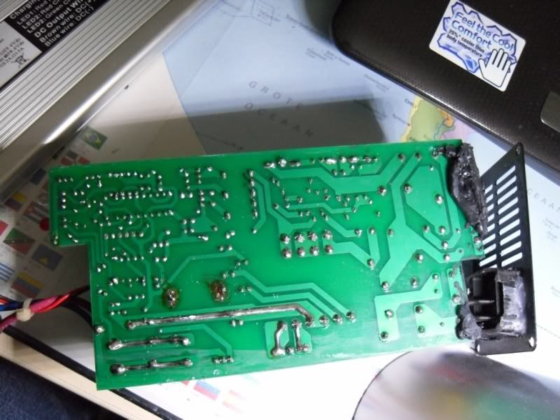

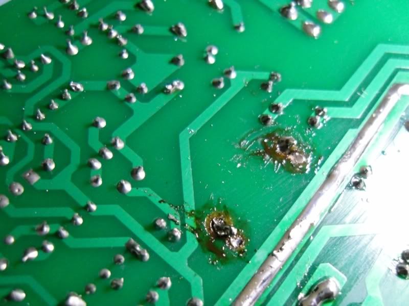

I think my new purchased charger has been repaired.
Because when I open the charger I see this.
Nothing is perfect until I touch it...
dnmun   100 GW
Posts: 16190
Joined: Jun 09 2008 1:32pm
Re: BMS Battery Alloy Shell Charger Problems
Post by dnmun » Oct 09 2012 2:27pm
nope, that is how it is made. you can add some more solder to the through holes if you want. this is a thread from people with problems, if you wanna create a thread to work up the courage to make them take it back that is ok, but you haven't any problems like everybody else. you can send the picture to BMS battery if you want to, but your warranty is now void since you opened the case. if you don't remount the switching transistors and the diode on their insulators properly it will blow up.

ok, i finally went and checked. shoulda done that first before yakking away.
the green led is lit when there is power switched on, and turns off when the power is switched off. the dim red led is the one that is on when the battery is connected.
if there is no green led when you switch the power on, then check the fuse in the input, under where the power cord plugs in. there is another fuse in the output to protect against reversing the output. if the dim red led is lit then that fuse is intact, so it may be the fuse on the input power. that little black piece under the plug slides out, it covers the fuse. you can hook it on that little lip with screwdriver.
but put solder on the the through holes where the choke leads come out before reassembling it. that is where they came apart from overheating and i bet the reason is that they use so little solder in the through hole. i had never seen one before the choke overheated.
