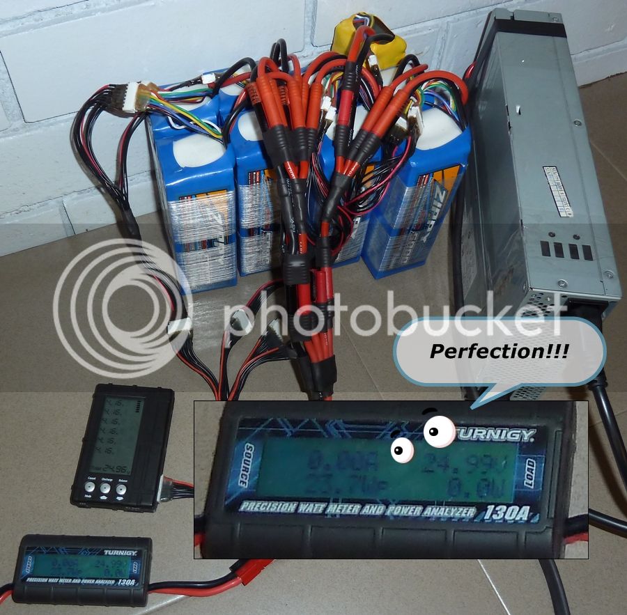

I asked Heath to build me one of these setups and it is FANTASTIC.
I am using it as rapid/bulk charger for my 6s packs when out on rides and while I am stoked how well it works we have one issue to address, the over current protection built into the supplies.
At low V's the PS wants to put out 60 + amps and trips over current protection. The first day I realized this was an issue I was charging while out on a ride and plugged the PS directly into the battery which worked fine during the home trials. But all of a sudden not in the field, hum? So I added a turnigy meter in line to see what was going on. I was happy/amazed that it started working. Started to try various connections to see what worked. Turns out between the meter and a bullet to anderson adapter i had made out of some crappy multi strand house wire years ago created enough resistance to give the PS time to get passed the current spike enabling it to stay powered. Needless to say I was really glad i had that crap wire with me that day. So of course the shit wire got HOT really fast and had to unplug it frequently until the amps dropped enough that the wire could handle the current. Oh i didn't mention that the current drops from 60a to .16a +/- depending on the time left connected, nice. now, I haven't had it long enough to work out at what is the exact voltage where over current protection no longer becomes an issue but it's somewhere between 23.5 - 23.7 volts.
As i said, the closer it gets to 25v the lower the amp/watt output. I let it run for an extra hr (watching it closely) and it worked its way down to .16a or 3w, amazing. So now when i go out on rides and it's time to charge I don't have to worry about watching it charge every second. Turn it on, go eat, and come back in an hr. I should mention, in this scenario the pack is not next to anything flammable and I use a 6s Hi/Low voltage alarm (which is quite load) just in case, plus Im never that far away.
Once we/he figure(s) out a way the best way to address the over current protection this will be the best thing sliced bread, to me at least. The only way it could get better is if it weighed a bit less. But it has a nice slim profile so it easily fits in my pack which i can cinch tight against my back so the benefits out weigh the cost (no pun intended).
My point for posting this is to say this PS is awesome and if you are local and could use one, you should buy it from Heath.
