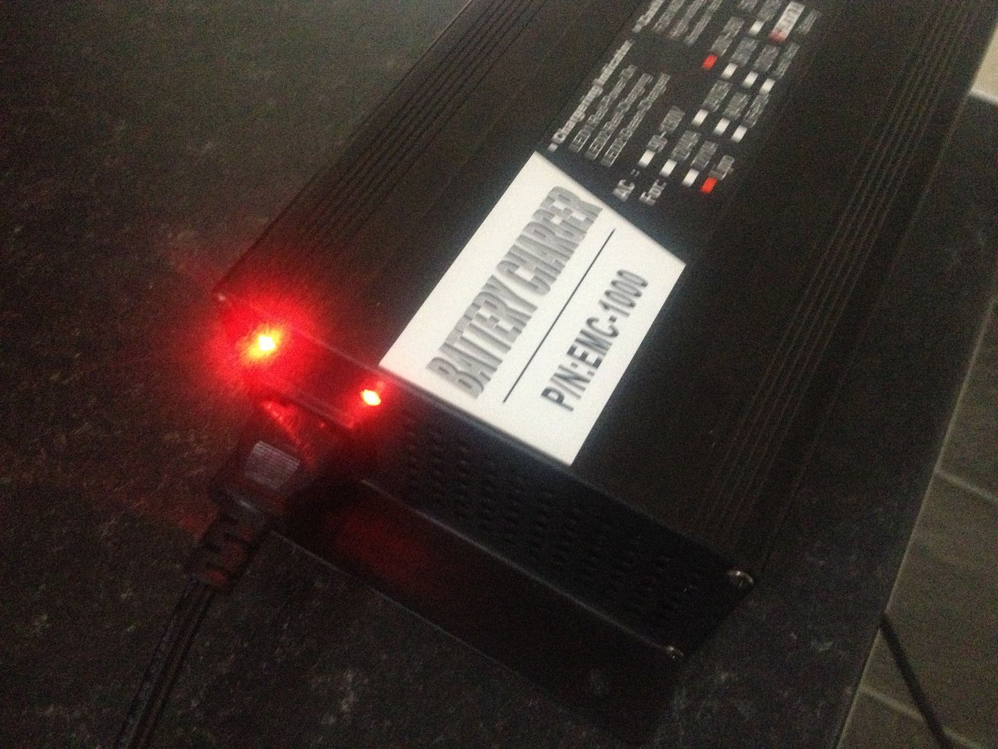

My BMS 900w charges up to 99.4v (as requested when ordered), but the green light doesn't come on when the charge has completed, as it says its meant to. It remains red and turns off.
Is this what it's meant to do with the BMS?

both of the leds remains red even when the charger is not pushing current? do you have an ammeter in the charging line so that you can measure the current flowing into the battery?
you can raise the charging voltage up to 100.8V if you are using the bestekpower BMS and it will balance around 4.2V/cell.

Yup, its not going green. I need to get an ammeter to check amp draw, is there a way to use the CA as a charge meter?

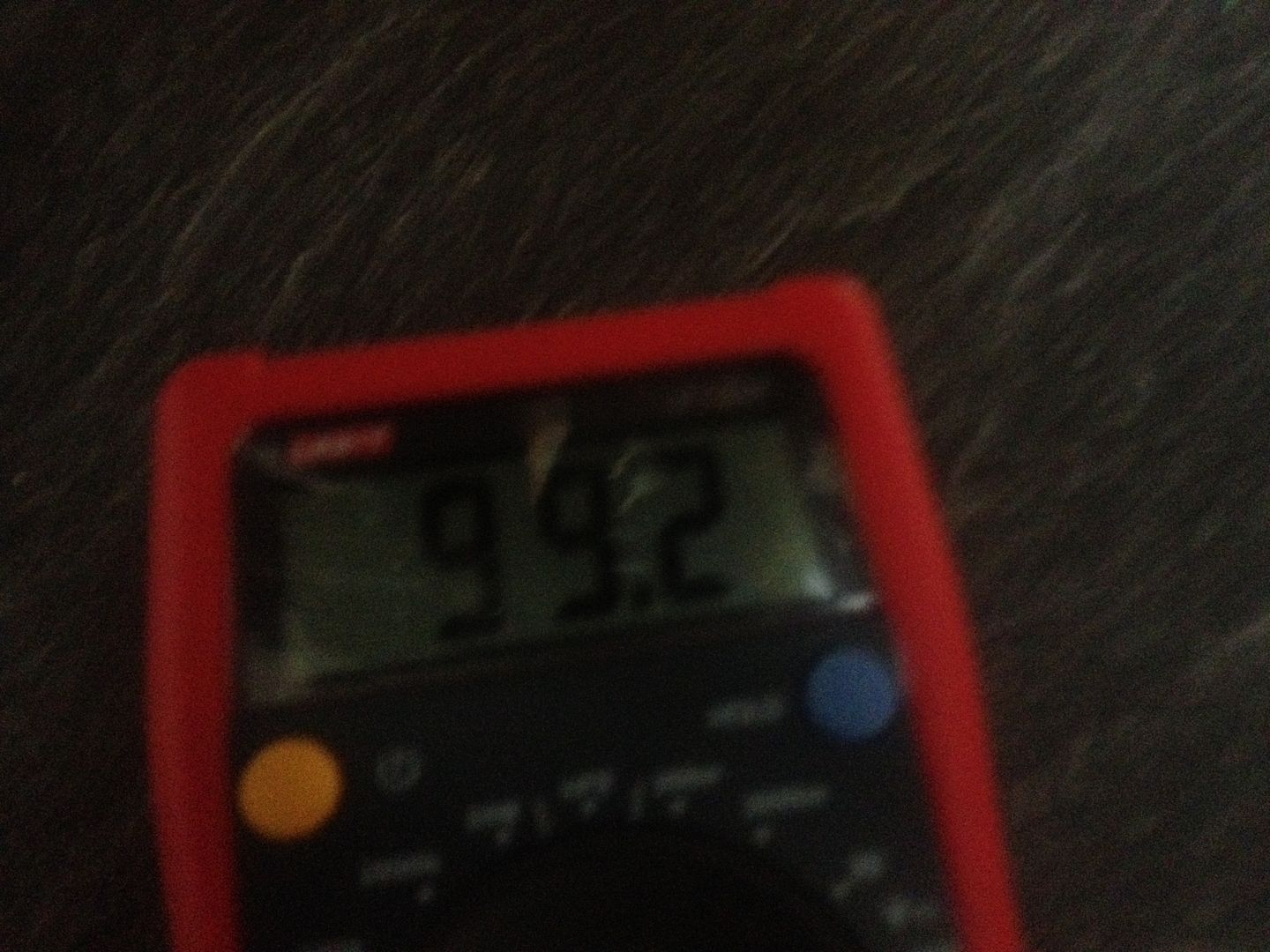

isn't that an ampmeter in the second picture? sorry, it's so blurry and dark that i just can't identify it.

No, I'm seeing 99.2V on the multimeter in second blurred picture.
izeman wrote:isn't that an ampmeter in the second picture? sorry, it's so blurry and dark that i just can't identify it.

Sorry, didn't notice the picture quality was as bad as it was until I logged on to the computer.
It is a voltmeter reaqding 99.2v.

sacko wrote:Sorry, didn't notice the picture quality was as bad as it was until I logged on to the computer.
It is a voltmeter reading 99.2v.
ok. so voltmeter only. that's bad. a multimeter capable of measuring amps, resitors, checking diodes etc, is almost the same price, and looks the same.

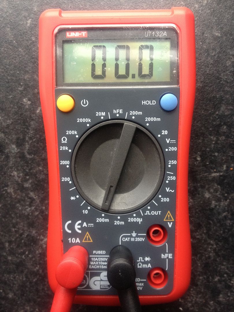

It is meant to measure amps etc, it just doesn't work :)

you would have to use the 10A range on the meter and switch the red prob over to the hole that says 10A.
but the red on the #2 led means it still has current flowing or the op amp will turn off the fan and the red of the led.

sacko wrote:It is meant to measure amps etc, it just doesn't work :)
maybe post a picture of the whole device, and we can show you what to connect where, and how to set it. just in case you don't have the manual. or if you know that it's broken, just ignore my post ;)

http://www.pollin.de/shop/downloads/D830348B.PDF
Something like this

no, put the dial on the 10A position. you have the red probe in the 10A plug so set the dial to 10A.
