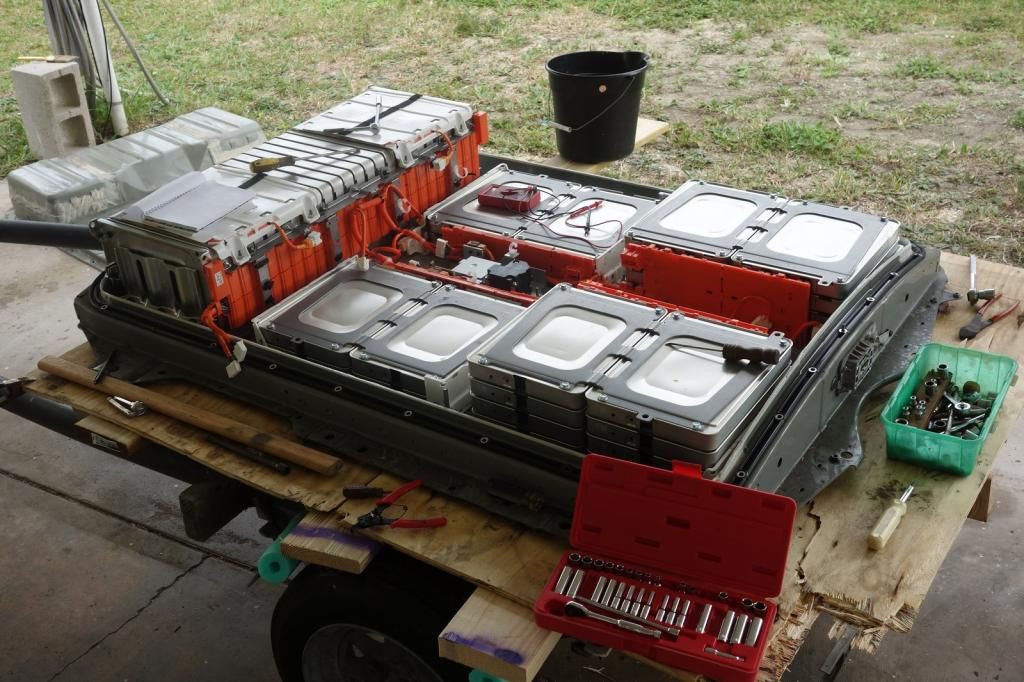

icecube57 wrote:The way the case is made I dont see how compression is being accomplished. Other than gravity compression when laying flat. You physically cant take a threaded rod and force tighten them like a123 does cause the packs have metal collars where the bar would go through which prevent it from compressing.
* I guess i answered my own question and then read it later in the forum post. LMAO.
Nissan has the cells laying on their side. Very strong and rigid steel compression plates go on both ends of each 24 module string, and the threaded rods are used to crank down and hold the compression force of those end-plates. It cranks down enough force to shrink that stack of 24 modules by about 2.5" more than just stacking them, so the compressive force is substantial.

agniusm wrote:If they were compression plates, they cut out most important part for compression - the middle:) Sure they tighten battery to be rigid and sure it will decrese (2.64mm per module according to your figure) in width but inside cells will feel little to none compression.
Of course there's significant compressive force. The part you're missing is that the design of the 2 large faces of the cans make them act as flat springs. Experts in the field have told us point blank that pouch cells require compression. Aren't you one of the guys who was running A123 amp20's with no compression, and didn't you suffer some premature failures? Sure they may have had other causes too, but I don't believe in coincidences. The A123 factory guy is the one who told us those need 4psi compression. Plus Icy measured greater capacity for leaf cells with simple compression. Plus there's no free space inside the faces of the leaf cans, so with the 24 module stack squeezed down to a 6cm+ shorter stack in the rack than stacked on the floor, it's quite obviously due to significant compression force. Otherwise the middle of the cans would be bulging out 3cm from both ends.
All pouch cells require compression. Without compression they swell and gas comes out of solution easier causing them to puff. We've seen it with all pouch cells when they aren't properly compressed. Those metal pieces that seem like spaces are out beyond the borders of the cells inside. Their purpose is to spread the forces evenly, so the faces can act as springs, which combined with the large plastic pieces inside provides a nice even compression across the cells.

The shape of the can makes the center parts work as a flat spring with the rigid plastic rectangle inside ensuring that the force is spread evenly. Looking more closely at the structure and way they use those spacers, I think you are right that the compression force on the cells isn't from pushing the faces of the cans together. Instead, each can is squeezed at the edges by those spacers, so the can itself via the flat spring faces puts the cells inside that can under compression. It's likely that the can itself puts some compression on the cells even without some outside force, but in the rack definitely adds to that as evidenced by the difference in height of the stack while in the rack. I'm talking about a stack of modules with no spacers at all being 2.5mm thicker per module than those in the rack.
That even helps me understand why all those heavy steel spacers are used. They help maintain a slight airspace between modules for better cooling, while still putting the cells under compression, and also allow a bit of space for thermal expansion and contraction.
What year Leaf is yours from? The rack of 24 modules I have was built in late 2012 and has all of the modules on their sides. I'm wondering if the horizontal stacking is a newer or older.
I only opened up one can...a real pain in the butt. If I decide to take more cells out of the cans, I'll do it by grinding off the lip that holds the top on. If I can do that cleanly, then I'll be able to see how much it pops up as that flat spring is released. That might even give us an idea of the compressive force.
Now that I think about it, I will definitely open 1 that way. If the combination of the top and the plastic proves to be a sufficient spring and way to spread the force, then I can use one can to make a 1p20s pack, and have leftovers for a flat spring for both ends of my Amp20 pack to provide compression. Coming up with good flat springs for my A123amp20 is why my 31 cells still sit unused. My batteries never have thermal issues, so I can get away with face to face cell stacking even with these lower C rate Leaf cells without having to worry about cooling.
If anyone has come up with a method or solvent to release the strong sticky stuff without disturbing the cell at all, I'm all ears. I'd want to get rid of all but the two end pieces of 2mm thick plastic.
Here is a crude drawing of how it works and why the test showed no compressive force:

John in CR wrote:What year Leaf is yours from? The rack of 24 modules I have was built in late 2012 and has all of the modules on their sides. I'm wondering if the horizontal stacking is a newer or older.
The layout of the modules in the LEAF pack has not changed for all production LEAFs from 2011-2015, though Nissan did change the design of the can for 2013+ LEAFs to reduce weight and cost.
24 modules are stacked on their side on the rear of the pack, 8 modules are stacked flat 2 high in front of those and in front are 16 modules stacked 4 high.
If you look closely at the rear modules you can see a slight difference in the design of the can/case of the modules.
2011-2012 LEAF pack:
2013+ LEAF pack:

the compression is there to try to prevent the electrodes from pushing away from the separator when the gases are formed during charge and discharge at the electrode/separator interface from how i understand them. that is how i understand the literature on the gel VRLA batteries too. so i now stand the gel VRLA in my car on end so that the electrodes are stacked horizontally like pancakes one above the other so gravity can keep the sandwich together during charging as gases are formed at the electrode electrolyte interface.
MitchJi   1 GW
1 GW
Posts: 3076
Joined: Jun 02 2008 8:09pm
Location: Marin County California
Re: Nissan Leaf Cells Test Data
Post by MitchJi » Nov 01 2014 3:20pm
Hi,
the compression is there to try to prevent the electrodes from pushing away from the separator when the gases are formed during charge and discharge at the electrode/separator interface from how i understand them....
I think it's also important to prevent the cycles of swelling and shrinking that would happen with repeated heating and cooling of the cells.
