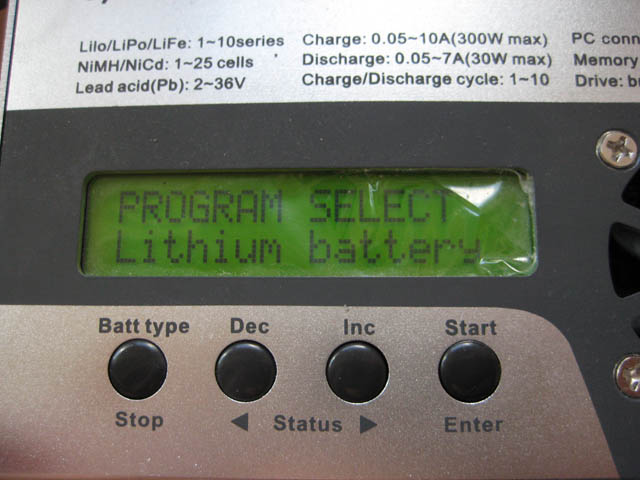

To change the cell voltage to charge to from 4.2v to 4.15v:
-Click the right arrow until you find 'settings'.
-Hit 'start', then keep hitting the right arrow until you find 'lipo termination voltage'.
-Hold the start button until the voltage level readout starts blinking, then use the left arrow to decrease it. When it's set, hit 'start'.
-Hit 'stop'. Now let's charge! select the lithium option.
-Hit 'start', then arrow over to the 'lipo' setting.
OK, let's charge at a 1C rate or below.

OK, now on this charger we hold the button down to initiate the charge, and it should beep at you and begin doing it's work.
Congratulations! you've started your first lipo charge.

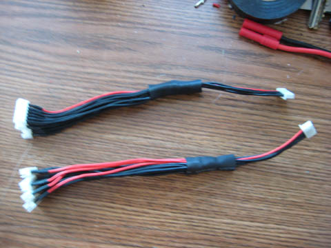

Now, you might be wondering.. we have 4 balance lead connectors now.. so how is this 10ah pack balance charged?
The same parallel connection can be made on the balance leads, actually! the voltage of all the cells in the parallel group become equalized when you use a parallel balance cable, it's as if you have 1 pack full of 10AH cells instead of 2 packs full of 5AH cells, thus, you can charge all 4 lipo packs here as if they were two.
For this, we will need a parallel harness.
Pictured here is a 4 way parallel balance cable made by progressiveRC. ( Of course, you can make your own just the same. You can even hack up JST-HX balance lead extenders from a hobby shop to make these just as well. )
There are a couple things you need to know about using parallel balance cables, before we start:
Dangers:
+ The voltage of the cells in each pack must be roughly equal before connecting the parallel balance cable, differing no more than about 0.05v. The easy way to achieve this is to fully balance charge each pack seperately, THEN connect the balance cable between the parallel packs. The reason is that if you have a large difference in voltage, the cells will try to equalize voltages the instant you connect that parallel cable.
So for example, If you have one cell at 3.0v linking to another cell at 3.8v, as soon as you connect that parallel cable between the two, the 3.8v cell will try to move half of the difference in energy over to that cell in less than a second! That means that you could potentially kill either or both cells, or vaporize the tiny little 22-24AWG wire as the cell attempts to send hundreds or thousands of amps across the wire!!
+ If you have a bad cell paralleled to a good cell, the bad cell will drag it down and cause problems either immediately or down the road.
For example, if one of your cells has 4ah, and the cell paralleled to it has 5ah, then that cell group in your pack has 9ah whereas the other cells have 10ah. That cell group will hit 3.0v faster than all the other cell groups that have 10ah.. thus, you can easily kill the healthy 5ah cell as well as the 4ah cell. Dud cells in two lipo packs - that sucks!
So, before paralleling at the cell level, ALWAYS fully test and cycle the packs that are going into the parallel group.
