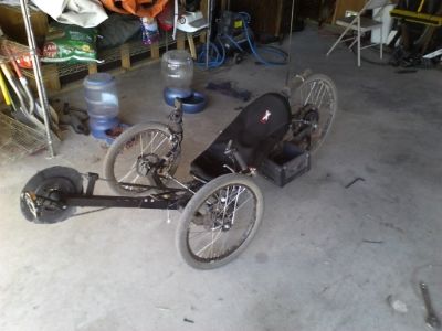

His or mine? He seems to have a car of some kind. Not sure what his recumbent is, two wheel or three.
I have done touring so far, by driving a car to a section of road, then riding both ways. Drive 20-30 miles farther, often on another trip, ride some more. If I camp in the car, It's a Subaru Forester with a trailer for the huge bike, or a rack for carrying the dirt bike if going trail riding. With the car, I can carry a generator to charge in the woods at a remote campsite.
What I want to do is just ride off from the house on this. Like Justin did, but for just a few days, or weeks at most. 150 pounds with a full load of batteries that weighs 30 pounds or so. Then the camping gear is another 40-50 pounds at least. Call it a 200 pound bike loaded.
Bouncing Betty 5-2013.jpg (136.28 KiB) Viewed 2591 times
It remains to be seen if I can stand to camp out for more than two nights at my age. The original idea was to tour from motel to motel. No money for that now. Not enough ES fans in this area for couch surfing much either.
