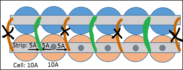

up0   10 mW
Posts: 34
Joined: Apr 02 2014 4:31am
Re: 18650 spot welding -how to- ULTIMATE REPOSITORY
Post by up0 » Mar 02 2016 4:49pm
> But thats not rated for the 12 amps the parallel cells will use.
Maybe I am missing sth, but I would have thought the the nickel-strips only have to
carry half the Amps of the cells if you connect them at every point with the next strip.
Lets make an example: My GA cells are rated for max 10A, and I connect every Strip
with decent copper wire to the left and right of each cell:
If someone connects the series with only 1, 2 or 3 strips instead of the copper wires,
then there will obviously be part of the strip that gets a lot of Amps flowing through...
Cheers, Ulli

True each cell delivers up to 12amps but... Each cell has a series connection so the current flow is from cell to cell via the series connector. The adjacent cell in the P group is at the same potential so no current needs to flow to it via the P connector. If I had only say two series connectors then the current flow through P connectors would be 2/5 cells output on its way to get to the series connection.
My cells are all the same batch and behave similarly so the balancing currents during a load are minimal.

Correct in my understanding. Even better is pop the S connector right on the battery terminal and largely eliminate P connector flow. I understand you don't want to solder there... I spot welded. Flow in P groups can be largely minimised if layout is perfect.
But battery housing space determines the shape of the battery and current flow is somewhat dependant on this.
Nickel is a pretty poor conductor but it's awesome to weld so that's why everyone uses it.
Copper is a way better conductor (4x) but difficult to weld and weaker. I spent ages learning to weld it, beneficial in high draw packs but .2 nickel is my preference in low power applications.

up0
I'm not sure if the way you have your cells setup is good. The first problem I see is that the current draw will not be equally distributed among the cells. The two outer cells have a lower resistance in the series connection because they have the left wire being only used for 1 cell. What will happen is when you draw power from the battery it will pull more power from those two outer cells.
I guess you could make that wire smaller to handle half the amps to even things out.
Maybe it doesn't matter at all since it is insignificant.
You could also just use wires between two cells, but this would increase the load on the nickel plate. As shown where the green wires are in the picture.
But you see that you can't just simply distribute the load on the nickel without causing problems elsewhere.

OR true but current will only flow where there is V difference and in this case the weighting towards the end cells is small (1/12 extra ottomh) so P flow in this strip of nickel would almost certainly be OK.
Balancing currents will restore any temp imbalance during load - P grp cells are always same V (at rest)

Current sharing between cells inside a parallel group depends exclusively of their differences in voltages. In your example you use the same conductor for parallel and for serial, so in that case the current is not shared but conducted from one cell to the next serial cell. That example makes more difficult the BUS pattern to be equally IR balanced to the current flowing level on each place. So it depends on how you configure the conductors paralleled pattern they will work only for current sharing, or main serial conduction
up0 wrote:> But thats not rated for the 12 amps the parallel cells will use.
Cheers, Ulli
In this case there is no need to make the current pass through the paralleled nickel conductors, just only from one cell to the next matched one on the next series, you make a higher efficiency and best worth of the conductors if you place the wires directly over the cell anodes and cathodes

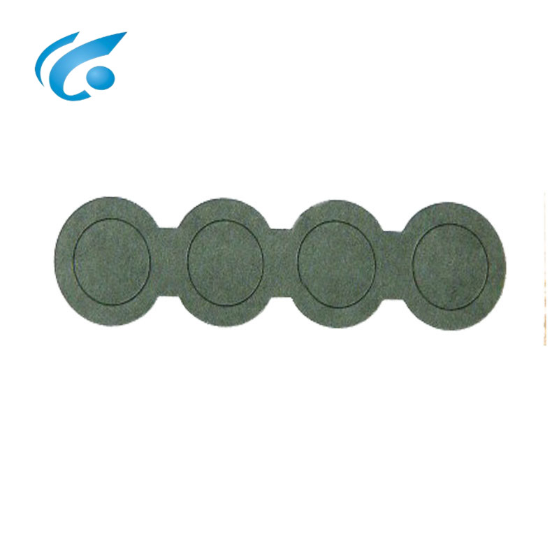

Post by Offroader » Mar 05 2016 12:01pm
Does cutting the nickel tabs like shown in the picture help with the welding?
What exactly is a blowout?
