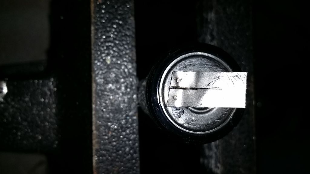

Offroader wrote:Does cutting the nickel tabs like shown in the picture help with the welding?
What exactly is a blowout?
When you apply spot welding electrodes to such stripes (that's actually my picture) the whole current must flow from one electrode through cell back to the second. It means 100% of power goes to make a weld. If you don't cut the stripes, something like half of your current goes through the stripe (burning it) and only the second half does the welding...

Skrzypas, did you find this a good solution?
How much has it helped you? It seems it may be the way to go. I have one of those heavy duty paper cutters that seems to cut right through this stuff fairly easily and straight.

All laptop manufacturers use this technology, see picture of a pair of cells from a brand name laptop. So I just learned from professionals.
And this is the only way my spot welder welds .3 nickel.

Interesting, I should have tried this. Does the whole strip need to be cut?
Seems like only the part you weld needs to be cut. Reason I ask is I intend to solder a wire to the strip before welding and will not be able to cut the entire strip.
I got to make fast decisions here because My new frame is here next week and want to get my Q76R rolling as soon as possible.
I am considering cutting .2 nickel into 27x12 mm strips and using that between each two cells.
I got lots of .3 x 8 nickel also, may try to see if that welds good with the cutting, because it was not weldable without cutting it.

OR- I think there's info here already on the slots. Makes a big difference in ease of welding. Forces current down into the can. Must have one electrode either side of slot for it to work ( definitely not on same side).3 mm is very thick- not really that good for the can cause its too strong but you might be ok.
If you were almost able to weld .3 without slotting then I'd say you'd be able to with slots.

Coming back to the "grooves" or "linear holes" in the stripes: has anyone an idea how to do / buy a DIY puncher to make such ca. 8 mm long holes?
I'm thinking of converting an office puncher now.

Skrzypas wrote:Coming back to the "grooves" or "linear holes" in the stripes: has anyone an idea how to do / buy a DIY puncher to make such ca. 8 mm long holes?
I believe someone mentioned to use a dremmel. Just get the right thickness blade and grind the groove?

Scissors for end cuts, dremmel for middle ones. Aim for about 2-3 mm beyond the closest weld as a starting point for length. Prob 8-9mm as a start, as narrow as possible. Longer cuts have a bigger effect (to a point) but reduce strength and current carrying. I have found a mild benefit with even just a scissor slice- ie no material removed and sides of cut still touching. Keeps as much nickel as possible remaining... increased resistance across slice must be just enough.
I just had a thought... A punch of the right shape would be awesome cause it can be tedious work doing all those slices. :?

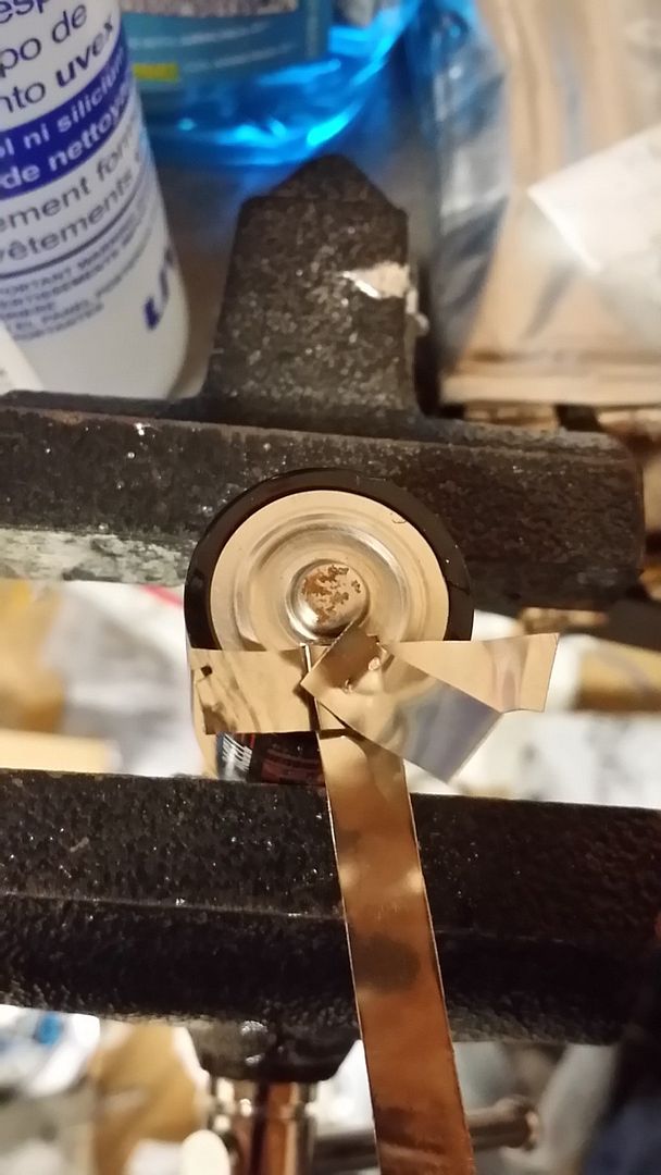

I did some testing with .3 nickel and cutting it down center. Makes a big difference when it is cut in half.
However, I am not so sure if I want to deal with .3 nickel. This is what I found by cutting .3 nickel in half.
It is hard to get consistently good welds compared to using .2 and .15.
many times I can break the .3 nickel off without pliers. Even when I get a good weld the .3 nickel seems easier to break off than .2 nickel. I believe the extra pulse time or amps needed to weld .3 nickel makes the weld less strong and more burnt.
With .3 nickel I found that I usually have one side that welds better than the other. This isn't the case nearly as much with .2 and .15 nickel.
That being all said, it is a must to cut or make grooves in the .3 nickel. It is weldable, but I've had too many issues with it and decided not to use it. I just don't feel confidant using it because of too many inconsistencies.
For my build I will cut custom .2 x 12mm nickel strips from a larger nickel sheet and this gives me exactly the same current handling as .3 x 8mm nickel that I have. The .2 will have much more consistent welds and is also much easier to weld.
Here is a decent weld below on .3, pulled off with holes in nickel.

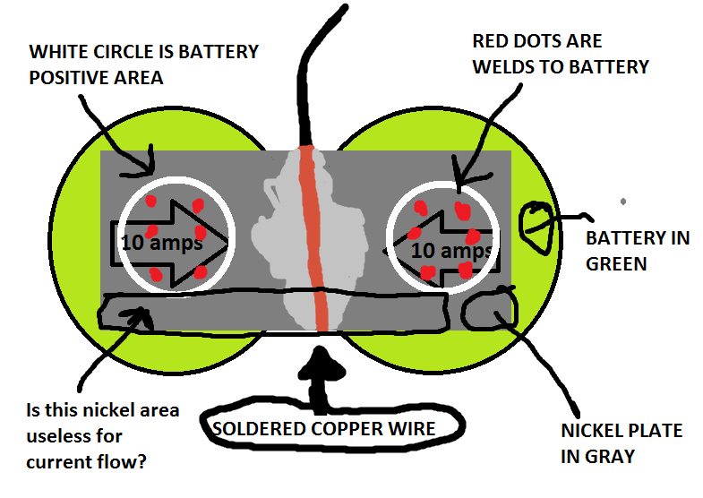

I'm going to cut my nickel in 12mm x 27mm strips to fit between two cells to save on cost as each of these will have a 16 AWG wire soldered in the middle to connect the cells in series. I'll then solder a thin strip for balancing over this. No reason to use the .2 nickel to connect cells that only need to be balanced.
Here is what I plan to do, I made this picture for something else but here it is.

Skrzypas wrote:From what I observed during my initial tests, it is very important how you weld the second stripe. The current does not like to flow through a small spot weld and chooses to flow mainly through the first layer of the metal stripe.
I was testing that with steel stripes I couldn't reach 50% "efficiency of adding more layers". I can make some specific tests if you want.
To avoid this it is better to spot weld two stripes at once to the cell terminal. From what you said before it is rather clear you won't be able to do it in this way, but please - try and share the results.
I don't get why you recommend welding two layers at once.
I test welded here on top of each other. First .2 nickel, then .15, .15 and .15. For 4 layers.
Each layer welded very easily to each other and the welds were very strong, I wasn't able to pull them apart by hand and when I finally did they ripped holes in each other.
If you need to pass current just get .15 nickel and weld layers, very easy.

What I observed is when you weld multiple layers at once, the current path is:
1. from cell terminal to the weld
2. from the (thick) weld, the current distributes between 2-3 stripes pretty evenly.
When you weld stripes your way, the path is:
2. from the weld to the first stripe
3. and then the current can choose either run where it should through the first stripe or "choose a narrow path" through another weld to the second stripe.
Option 2 has potentially higher resistance and more heat generation.
