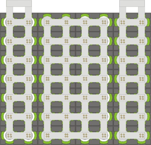

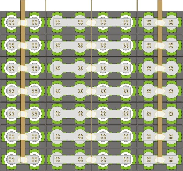

mistercrash wrote: How about a discussion on what is the best way to connect the cells together in series and parallel? Most batteries I see that people make themselves have strips of Nickel welded to make the parallel connections and then more strips of Nickel to make the series connections. I remember dmun brought up a different way to make those connections that takes a lot less Nickel strips and despite my ignorance on the matter, it just makes sense to me. Make the series connections with small lengths of Nickel strips and then the parallel connections on the strips with a small gauge wire soldered on. Solder heavy gauge wire on the Nickel strips for the positive and negative poles of the battery. Below I included a couple drawings of a 4S14P battery, first the all Nickel strip battery I often see and second, the way dmun suggested many times. Sorry for the bad choice of colors representing some materials.
You are right, second picture is better option, since on the first one there's a lot of wasted nickel. However, that single soldered copper wire in the middle of the pack is not so practical because it protrudes over the plastic brackets, so it would be better to replace is with welded thin and narrow nickel strip.

Individual cell-fusing:
If one cell in the middle of a pack begins to short out and become very hot, very rapidly...having the connection between the cell and the rest of the pack formed as individual fuses can (in some cases) stop a runaway short from affecting the rest of the cells. The pack might still be ruined, but having only one cell overheat, rather than all of them....is a much more desirable situation.
The pic below is a design of a laser-cut nickel strip that connects one end of a collection of 12 cells, to form a 2S / 6P sub-group. The six tabs on the left side have the central split (described above), and those would be spot-welded onto the negative ends. The six tabs on the right side not only have a central split, they also have the connection from the center out to the rest of the cells formed with four thin "S" shaped strands. These are the fuses. All four strands would get very hot during a shorted cell, and...as soon as one of them melted completely through, the current flowing through fewer fuses would cause an immediate cascading failure of the remaining three strands. The fuse "strands" are to be located on the postive "button"
