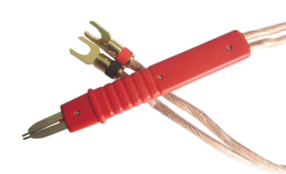

What do you all think of this welder?
http://www.ebay.com/itm/3-DAY-SALE-Batt ... Sw9mFWIsZd
Is this the 788 being referred to? Is there a way to use handheld probes? It would seem difficult to hold a huge battery to the machine.
http://www.ebay.com/itm/181922221370?_t ... EBIDX%3AIT
Syonyk   10 kW
Posts: 527
Joined: May 16 2015 12:41am
Re: 788 spot welder
Post by Syonyk » Mar 03 2016 11:50am
robocam wrote:What do you all think of this welder?
No idea. It doesn't give anywhere near enough information that I'd be willing to purchase it. Single pulse? Double pulse? How long? How adjustable?
If it's "tap the foot pedal and it goes," you'll have radically inconsistent welds and burn through a few batteries.
Yes, I think the 788H is the newer version of the 788+. You can wire up handheld probes if you want, but I haven't had to worry about it - I've just learned to build packs within it's constraints. I'm not building huge packs, though.
