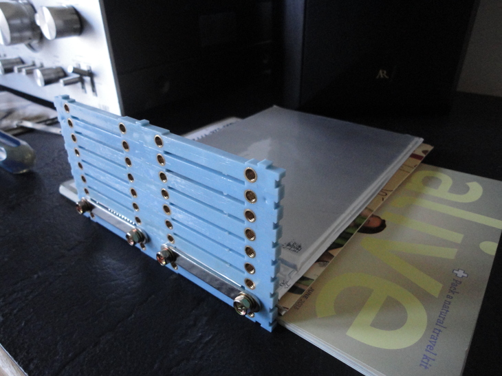

So I needed some end plates that were good and stiff to put compression on the cells. Metal seemed too heavy to me, so I went down to the dollar store and got a cutting board. It's about 3/8" thick, really REALLY stiff, and much lighter than metal.
Then to see what kind of expansion I'd get once fully charged, I wrapped it as tight as I could with some duct tape:
It seemed pretty darn tight to me, and duct tape is pretty strong, so I just glue-gunned some sides and a bottom on it:
Then duct-taped the hell out of it:

So screw duct tape, I'm using metal banding for compression.
I took a file and notched the end plates so the bands had a place to sit and not slide around.
Crank those suckers down tight:
Glue on the sides and bottom again:
And copious amounts of duct-tape:

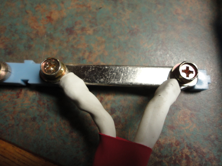

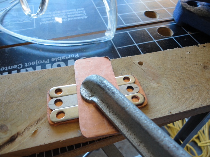

I didn't like wires making the series connections, so I got some 2mm thick copper plate and made my own bus bars.
I just cut them out with a jigsaw, and used my desk grinder to smooth the edges and round off the corners.
I used 3 of the original bars to make a jig to drill the holes:
Much better:

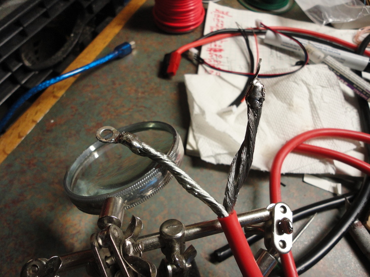

Then I took the 6awg silicone wire, and split it into 4 wires. Each of the pads on the BMS has 4 holes in it, so I figure I'll use all of them for each connection.
A whole ton of soldering and an Anderson SB-50 later, we have this mess. Note this BMS uses the same connections for both charge/discharge.
