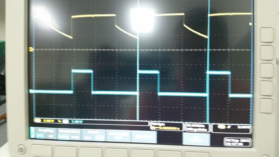

Woot! Today was a good day for progress. I got the timer circuit hooked up and running, and the chip is outputting an exploratory gate drive signal. Tomorrow Ill screw around with the feedback pin in an open-loop configuration to see how the gate drive changes. Then ill close the loop, and screw with it by hooking an RC filtered voltage divider to the gate drive, and putting the output on the feedback loop input to simulate what feedback a real FET and inductor would be giving.
Here is a shot of the timer circuit up and running (PWM will be 8khz for a nice slow starting point):
Here is a shot of the gate drive signal as referenced to the timer circuit (Gate drive is actually 15V, just indicated as 1.5V on a 10X probe)

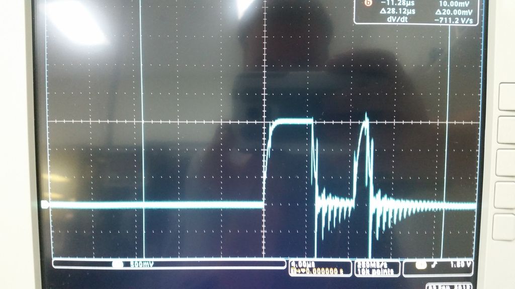

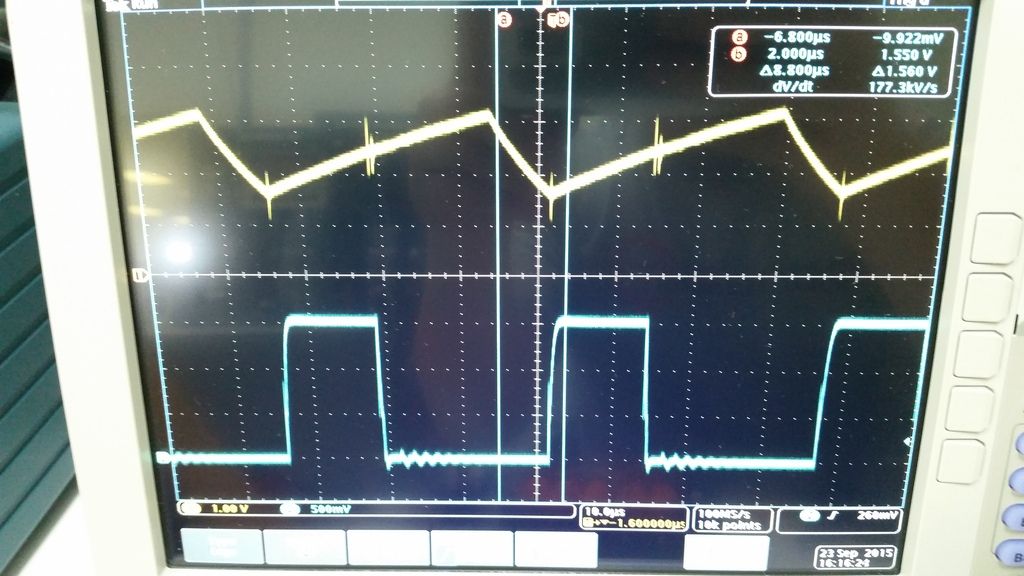

Woot! I successfully charged a battery today! a single 18650 at .8A. Then, disaster struck when changing the shunt value to make it flow 2A
The fet turnoff makes a spike on the clock pin, sadly I do not have a scope shot of the spike on 2A, but you can see clearly see it on the .8A test.
That spike is causing the clock to trip high, which causes the gate drive to go high and give the fet a double-turn on event:
I am assuming my dodgy protoboard is giving my this headache, so ill be attempting to design up and etch a real one here shortly

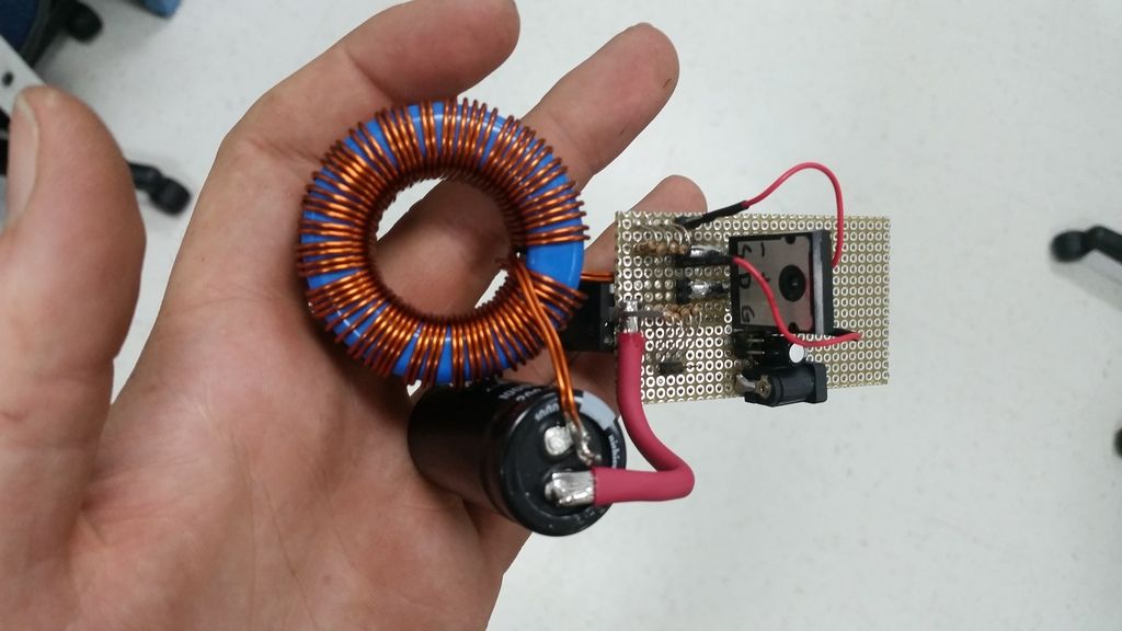

I made some good progress! I got my boards back from OSHpark, and proceeded to do a solid 25A sustained with two burly fans into a zero cellbox. Thats 2.5KW output for a critter the size of a paperback :D
LFP ordered some more fets for experimentation, So we will see what all happens here soon.
(Ignore the rough SMD soldering, I accidently bought the 0402 book, and had to bodge them on to 0805 pads)
Test Review Revise Repeat

Post by grindz145 » Nov 02 2015 1:52pm
Sick! Looks awesome. 2.5kw damn...
What's the input/output voltage for that? (sorry if I missed it somewhere) 220 in, ~120 out?
