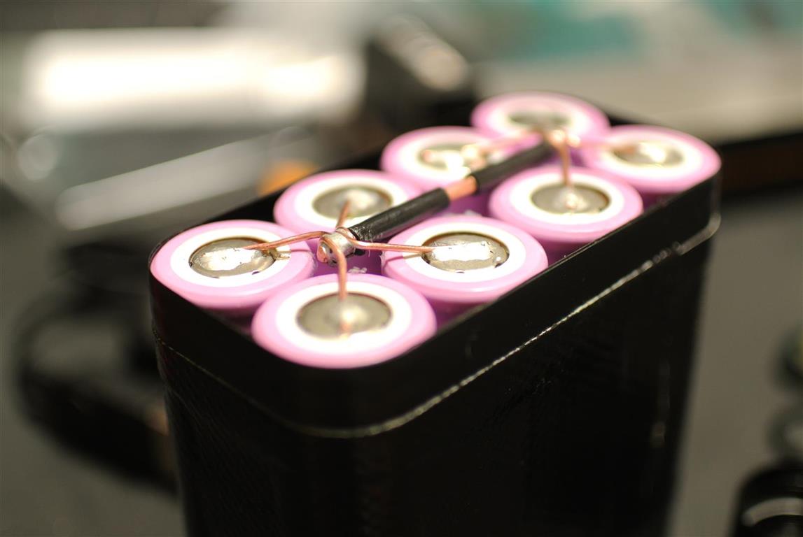

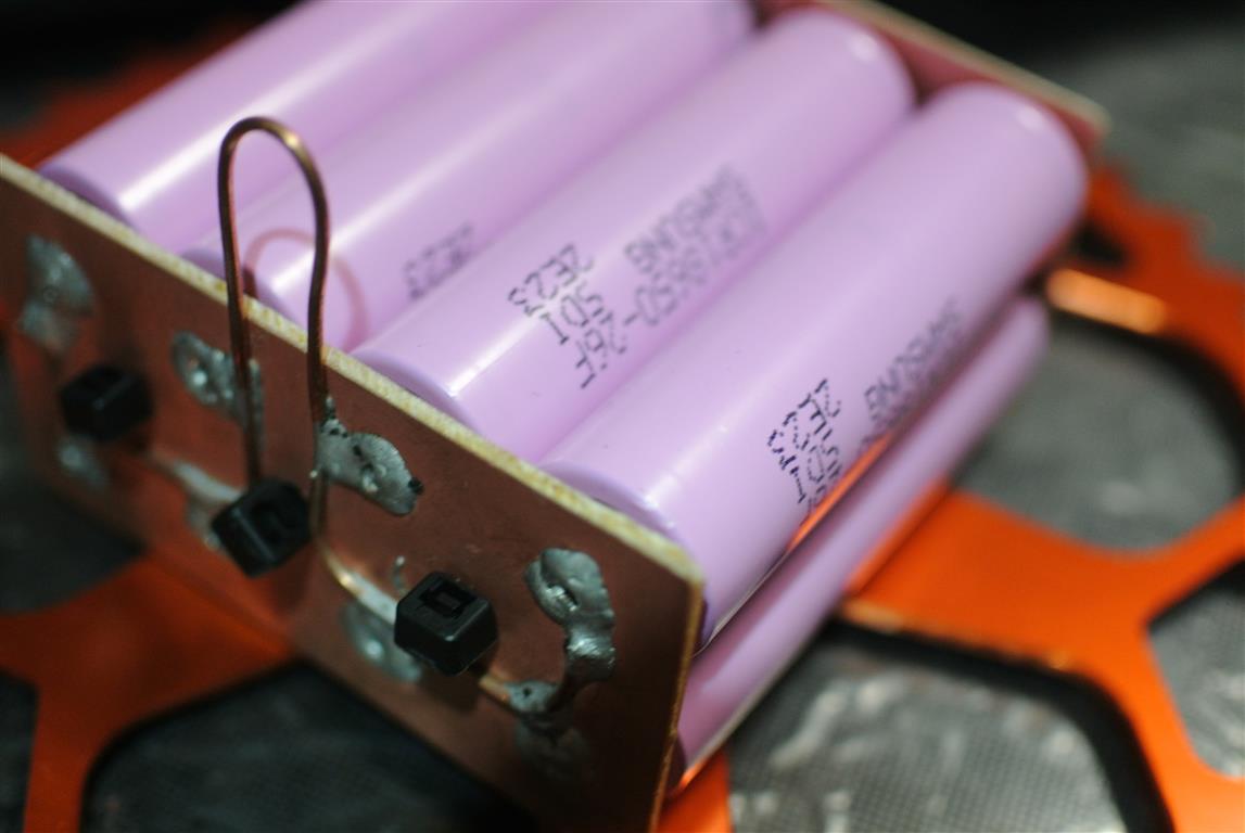

about 10 months ago i soldered together twelve 8P packs (samsung 26F cells). as shown above the soldering was done very quickly to minimize damage.

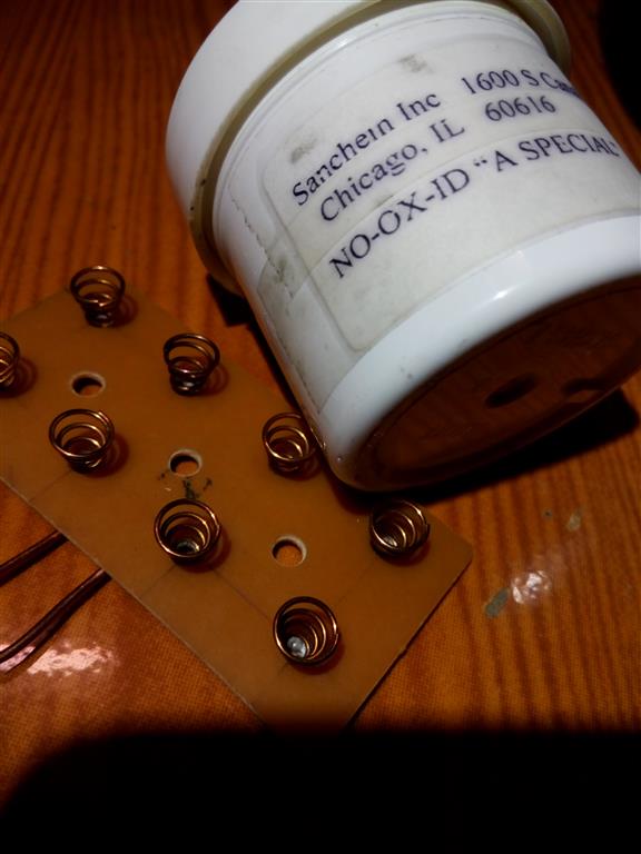

now after about 2000kms on the 12s8p pack i decided to see how much deterioration occured COMPARED TO THE UNUSED UNSOLDERED CELLS. so i hacked together a simple 8P holder (spring contact for negative side) for the UNSOLDERED CELLS, shown here:
i charged both soldered and unsoldered cells on the icharger 106b+. 4.17v end voltage. discharged to 3.10v at a low 4.0A (to minimize effects of contact resistance on the unsoldered cells).

the SOLDERED cells had about 2000 kms on them, probably 25 cycles? LVC was set to about 3.30v per cell. mostly charged to 4.10v. just a couple of times to 4.20v.
CONCLUSIONS:
1) the tiny difference could probably to attributed to normal li-ion wear.
2) soldering using my process doesn't seem to harm cells

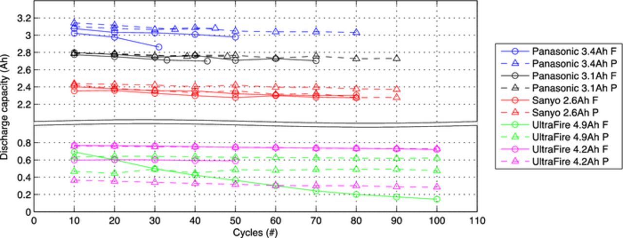

http://jes.ecsdl.org/content/162/8/A1592.full
shows capacity loss in the same ballpark after 25 cycles
