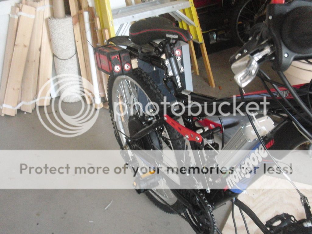

Mounting the Walmart Booster Batteries
Post by Boyntonstu » Dec 16 2015 12:28pm
There are quite small and lightweight.
2 on each side with the LED's and charging port up.
I am awaiting bullet connectors to wire them in series.
There is a keyed and a round connector.
A keyed to a round will make for easy series connections.

Re: Mounting the Walmart Booster Batteries
Post by ecycler » Dec 17 2015 10:39am
I would add at least two or three more zip ties per side if that is the only fastener you plan to use. I have snapped a lot of zipties when lazily using them to fasten heavy things. Nothing worse than the sound of battery or two hitting the deck.
Also, curious to see how those walmart batteries perform for you - this is the first I have seen of them. Any specs you can link to?
Post by WoodlandHills » Dec 17 2015 12:22pm
One thing to remember about zip-ties: they degrade when exposed to UV light. After a few months in direct sunlight they will get brittle and snap. This is why they are never used in aviation, they are only a temporay use item.
Post by Mundo » Dec 17 2015 6:24pm
Are those Lead Acid batteries?
Nylon ties won't be strong enough, I fully understand for testing purposes. Hit a little pot hole at speed, bye-bye batteries!
The black ties are more UV rated (a little stronger that the white ones). I'm not sure how strong the Stainless Steel ties are, but better than you have now.
Your rear rack looks questionable as well, consider adding some struts from the rack, to near the rear axle.
Post by Boyntonstu » Dec 17 2015 6:32pm
Mundo wrote:Are those Lead Acid batteries?
LiPo batteries. 4 x 12V
The rack is rated for 22 pounds and the load is about half of that.
Judging from the thickness and the design, I would expect the rack to carry 30-40 lb.
