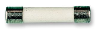

fellow   1 kW
Posts: 326
Joined: Apr 01 2014 11:04am
Location: Sweden, EU.
Re: No BMS - Do you use a fuse?
Post by fellow » Sep 24 2016 7:16pm
If so how do you size it?
One possible choice is Littelfuse 0326015.MXP 15A, 125VDC, slow blow, ceramic 6mmx32mm. Sizing(15A): 15A=4h continuous, 20A=1h continuous, 30A=5 to 60 seconds. In reality, those 15A fuses never false-trip at 15A peak and can be used all day long, so sizing is really simple - just pick your peak current and that's it.
If 15A value is too small for your application, there are 20A, 25A and 30A options in the same d=6mm, L=32mm format. You typically want your DC fuse to be as long as possible and sand-filled, in order to prevent unwanted arcing.
Pdf is here: http://www.littelfuse.com/data/en/Data_ ... P_326P.pdf
